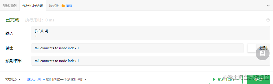

2、代码实现
代码参考:
public class Solution {
    public ListNode detectCycle(ListNode head) {
        if (head == null) {
            return null;
        ListNode slow = head, fast = head;
        while (fast != null) {
            slow = slow.next;
            if (fast.next != null) {
                fast = fast.next.next;
            } else {
                return null;
            if (fast == slow) {
                ListNode ptr = head;
                while (ptr != slow) {
                    ptr = ptr.next;
                    slow = slow.next;
                return ptr;
        return null;
