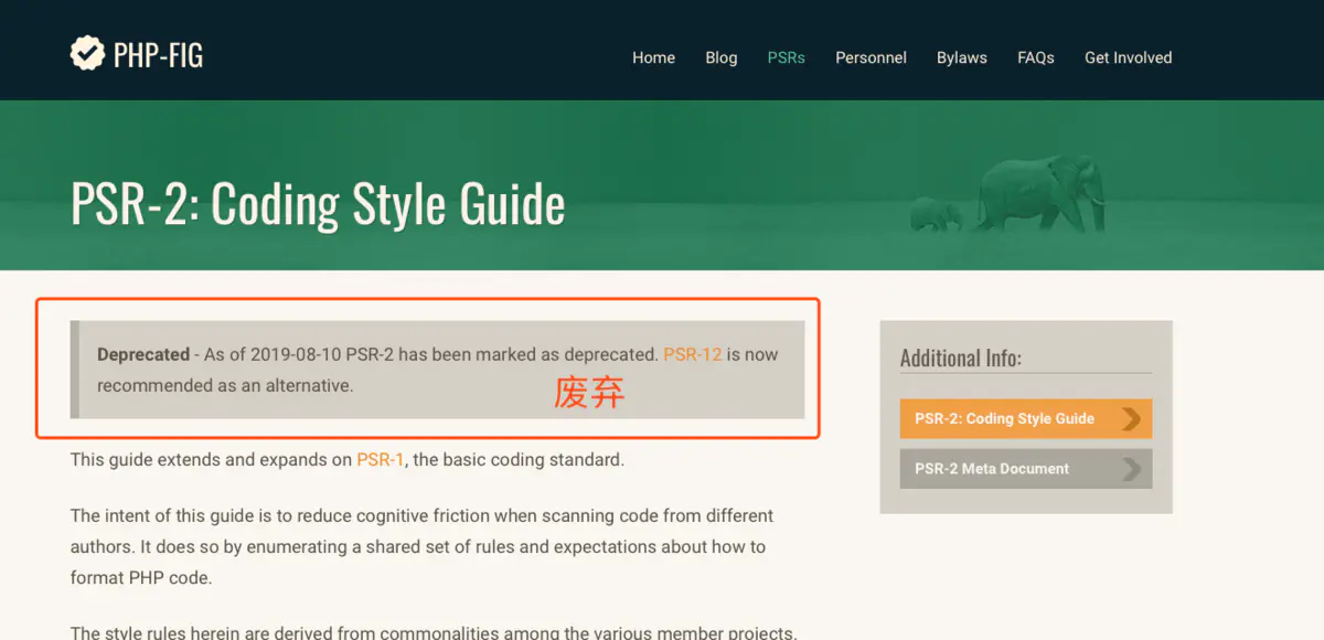

到2019-08-10,PSR-2已被官方废弃,感谢@麥丹慈
PSR-2: Coding Style Guide has been deprecated
