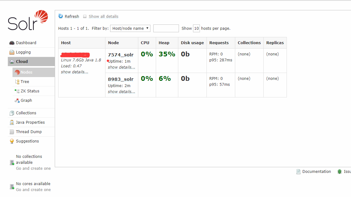

./solr start -e cloud -force
  1. [root@SERVERNJ221 bin]# ./solr stop -all
  2. [root@SERVERNJ221 bin]# ./solr start -e cloud -force
  3. Welcome to the SolrCloud example!
  4. This interactive session will help you launch a SolrCloud cluster on your local workstation.
  5. To begin, how many Solr nodes would you like to run in your local cluster? (specify 1-4 nodes) [2]:
  6. 2
  7. Ok, let's start up 2 Solr nodes for your example SolrCloud cluster.
  8. Please enter the port for node1 [8983]:
  9. Please enter the port for node2 [7574]:
  10. Solr home directory /wostore/project/solr/solr-8.1.0/example/cloud/node1/solr already exists.
  11. /wostore/project/solr/solr-8.1.0/example/cloud/node2 already exists.
  12. Starting up Solr on port 8983 using command:
  13. "/wostore/project/solr/solr-8.1.0/bin/solr" start -cloud -p 8983 -s "/wostore/project/solr/solr-8.1.0/example/cloud/node1/solr" -force
  14. Warning: Available entropy is low. As a result, use of the UUIDField, SSL, or any other features that require
  15. RNG might not work properly. To check for the amount of available entropy, use 'cat /proc/sys/kernel/random/entropy_avail'.
  16. NOTE: Please install lsof as this script needs it to determine if Solr is listening on port 8983.
  17. Started Solr server on port 8983 (pid=20407). Happy searching!
  18. Starting up Solr on port 7574 using command:
  19. "/wostore/project/solr/solr-8.1.0/bin/solr" start -cloud -p 7574 -s "/wostore/project/solr/solr-8.1.0/example/cloud/node2/solr" -z localhost:9983 -force
  20. Warning: Available entropy is low. As a result, use of the UUIDField, SSL, or any other features that require
  21. RNG might not work properly. To check for the amount of available entropy, use 'cat /proc/sys/kernel/random/entropy_avail'.
  22. NOTE: Please install lsof as this script needs it to determine if Solr is listening on port 7574.
  23. Started Solr server on port 7574 (pid=20565). Happy searching!
./solr status
