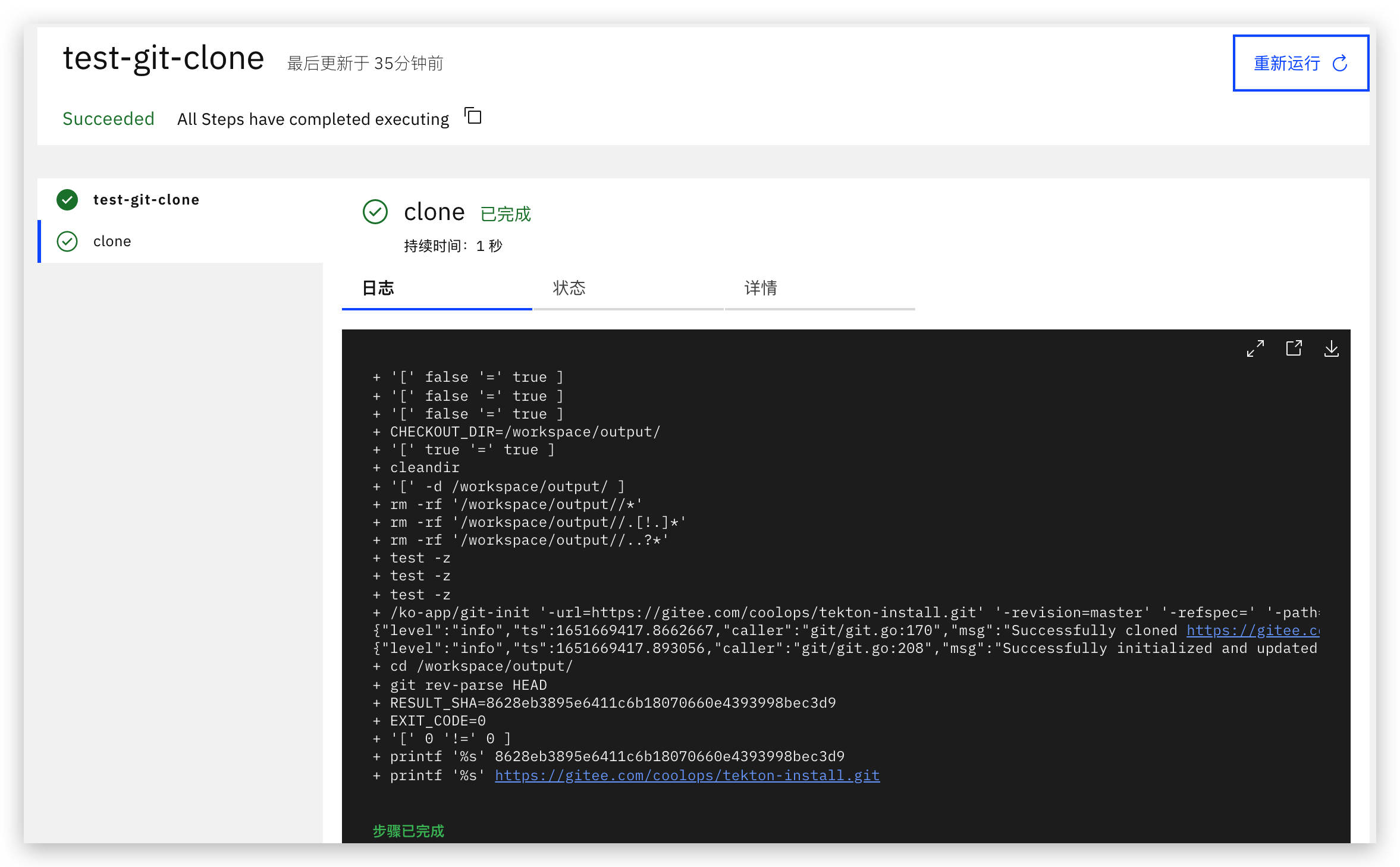

创建一个测试taskRun来测试师傅可以正常拉取代码。
cat > git-clone-taskrun.yaml << EOF
apiVersion: tekton.dev/v1beta1
kind: TaskRun
metadata:
  namespace: default
spec:
  workspaces:
    - name: output
      emptyDir: {}
  params:
  - name: url
    value: "https://gitee.com/coolops/tekton-install.git"
  - name: revision
    value: "master"
  - name: gitInitImage
    value: "registry.cn-hangzhou.aliyuncs.com/coolops/tekton-git-init:v0.29"
  taskRef:
EOF
