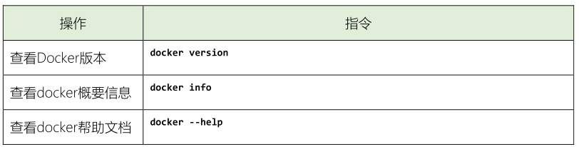

## 12-[掌握]-Docker 帮助命令
> ​        已经安装部署Docker引擎:`systemctl start docker`
```ini
[root@node1 ~]# ps -ef|grep docker
root       1851      1  0 08:56 ?        00:00:01 /usr/bin/dockerd -H fd:// --containerd=/run/containerd/containerd.sock
> Docker 容器引擎,提供客户端:`docker`
![1615600508387](https://img-blog.csdnimg.cn/img_convert/44d7a70448197fe6f2479e60131360f0.png)
```ini
[root@node1 ~]# docker version
Client: Docker Engine - Community
 Version:           20.10.5
 API version:       1.41
 Go version:        go1.13.15
 Git commit:        55c4c88
 Built:             Tue Mar  2 20:33:55 2021
 OS/Arch:           linux/amd64
 Context:           default
 Experimental:      true
Server: Docker Engine - Community
 Engine:
  Version:          20.10.5
  API version:      1.41 (minimum version 1.12)
  Git commit:       363e9a8
  Built:            Tue Mar  2 20:32:17 2021
[root@node1 ~]# docker info
Client:
 Context:    default
 Debug Mode: false
 Plugins:
  app: Docker App (Docker Inc., v0.9.1-beta3)
  buildx: Build with BuildKit (Docker Inc., v0.5.1-docker)
Server:
 Containers: 1
  Running: 0
  Paused: 0
  Stopped: 1
 Images: 1
 Server Version: 20.10.5
 Storage Driver: overlay2
  Backing Filesystem: xfs
  [root@node1 ~]# docker --help
Usage:  docker [OPTIONS] COMMAND
A self-sufficient runtime for containers
Options:
      --config string      Location of client config files (default "/root/.docker")
  -c, --context string     Name of the context to use to connect to the daemon (overrides DOCKER_HOST env var and default
                           context set with "docker context use")
  -D, --debug              Enable debug mode
  -H, --host list          Daemon socket(s) to connect to
  -l, --log-level string   Set the logging level ("debug"|"info"|"warn"|"error"|"fatal") (default "info")
      --tls                Use TLS; implied by --tlsverify
      --tlscacert string   Trust certs signed only by this CA (default "/root/.docker/ca.pem")
      --tlscert string     Path to TLS certificate file (default "/root/.docker/cert.pem")
      --tlskey string      Path to TLS key file (default "/root/.docker/key.pem")
      --tlsverify          Use TLS and verify the remote
  -v, --version            Print version information and quit
Management Commands:
  app*        Docker App (Docker Inc., v0.9.1-beta3)
  builder     Manage builds
  buildx*     Build with BuildKit (Docker Inc., v0.5.1-docker)
  config      Manage Docker configs
  container   Manage containers
  context     Manage contexts
  image       Manage images
  manifest    Manage Docker image manifests and manifest lists
  network     Manage networks
  node        Manage Swarm nodes
  plugin      Manage plugins
  secret      Manage Docker secrets
  service     Manage services
  stack       Manage Docker stacks
  swarm       Manage Swarm
  system      Manage Docker
  trust       Manage trust on Docker images
  volume      Manage volumes
Commands:
  attach      Attach local standard input, output, and error streams to a running container
  build       Build an image from a Dockerfile
  commit      Create a new image from a container's changes
  cp          Copy files/folders between a container and the local filesystem
  create      Create a new container
  diff        Inspect changes to files or directories on a container's filesystem
  events      Get real time events from the server
  exec        Run a command in a running container
  export      Export a container's filesystem as a tar archive
  history     Show the history of an image
  images      List images
  import      Import the contents from a tarball to create a filesystem image
  info        Display system-wide information
  inspect     Return low-level information on Docker objects
  kill        Kill one or more running containers
  load        Load an image from a tar archive or STDIN
  login       Log in to a Docker registry
  logout      Log out from a Docker registry
  logs        Fetch the logs of a container
  pause       Pause all processes within one or more containers
  port        List port mappings or a specific mapping for the container
  ps          List containers
  pull        Pull an image or a repository from a registry
  push        Push an image or a repository to a registry
  rename      Rename a container
  restart     Restart one or more containers
  rm          Remove one or more containers
  rmi         Remove one or more images
  run         Run a command in a new container
  save        Save one or more images to a tar archive (streamed to STDOUT by default)
  search      Search the Docker Hub for images
  start       Start one or more stopped containers
  stats       Display a live stream of container(s) resource usage statistics
  stop        Stop one or more running containers
  tag         Create a tag TARGET_IMAGE that refers to SOURCE_IMAGE
  top         Display the running processes of a container
  unpause     Unpause all processes within one or more containers
  update      Update configuration of one or more containers
  version     Show the Docker version information
  wait        Block until one or more containers stop, then print their exit codes
Run 'docker COMMAND --help' for more information on a command.
To get more help with docker, check out our guides at https://docs.docker.com/go/guides/

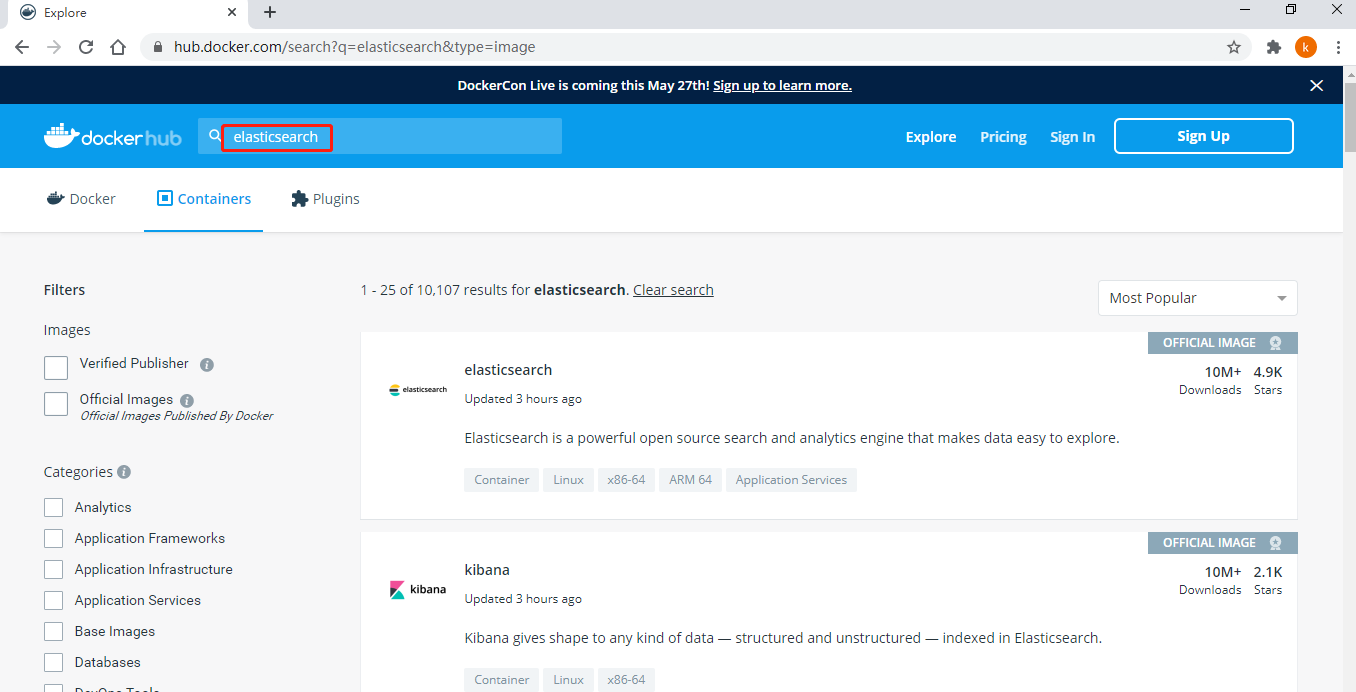

> 搜索镜像时,更多在WEB 界面搜索
![1615601089585](https://img-blog.csdnimg.cn/img_convert/365a7e032702df534bb9cdb6c3872792.png)
> 当搜索到镜像以后,可以仓库中将镜像拉取pull到本地镜像
> ​        [每个镜像image,都有版本tag,所以在拉取镜像时,需要选择合适的版本tag](),当拉取镜像时,不指定tag版本,默认情况下将会拉取最新tag版本镜像。

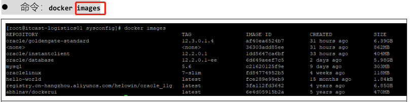

> 当镜像拉取到本地以后,需要查看镜像和删除镜像
> - 1)、查看镜像
![1615601300360](https://img-blog.csdnimg.cn/img_convert/971214395ff081e7ec92625aa4cd500d.png)
> - 2)、删除镜像
![1615601348789](https://img-blog.csdnimg.cn/img_convert/188a5f0b5f0368506e3fc4348c242799.png)
```ini
[root@node1 ~]# docker images
REPOSITORY   TAG       IMAGE ID       CREATED        SIZE
centos       7         8652b9f0cb4c   3 months ago   204MB
[root@node1 ~]#
[root@node1 ~]# docker rmi 8652b9f0cb4c
[root@node1 ~]#
[root@node1 ~]#
[root@node1 ~]# docker rmi centos:7
[root@node1 ~]#

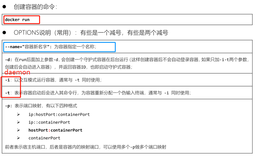

> - 方式一:启动交互式容器,`docker run -it --name=centos 镜像名称:标签 /bin/bash`
![1615601963095](https://img-blog.csdnimg.cn/img_convert/0106681f9f7f62dfc733caec5ee26617.png)

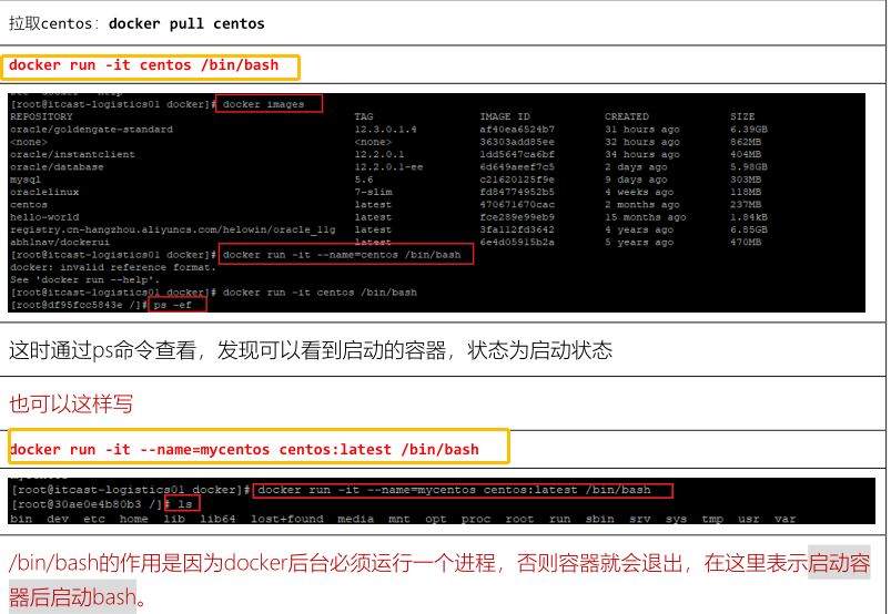

```ini
[root@node1 ~]# docker ps -a
CONTAINER ID   IMAGE      COMMAND       CREATED        STATUS                      PORTS     NAMES
21cc295413f0   centos:7   "/bin/bash"   17 hours ago   Exited (137) 17 hours ago             mycentos
[root@node1 ~]#
[root@node1 ~]# docker run -it centos:7 /bin/bash
[root@46188ebaf87f /]# hostname
46188ebaf87f
[root@46188ebaf87f /]# exit
exit
[root@node1 ~]#
[root@node1 ~]#
46188ebaf87f   centos:7   "/bin/bash"   32 seconds ago   Exited (0) 6 seconds ago              competent_fermi
> 当创建交互式容器时,创建完成以后,直接运行容器,并且进入容器中,如果退出容器,自动将容器关闭。
> - 2)、方式二:守护式方式创建容器,`docker run -di --name=容器名称 镜像名称:标签`
>   - 采用守护式方法创建容器以后,需要登录容器(相当于登录操作系统)
>   - 命令:`docker exec -it 容器名称(或者容器id) /bin/bash`

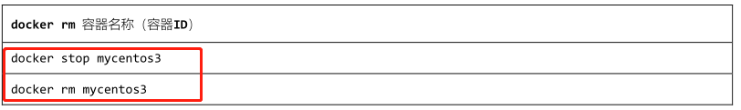

>  删除容器:当容器不再被使用时,可以直接删除容器Contanier

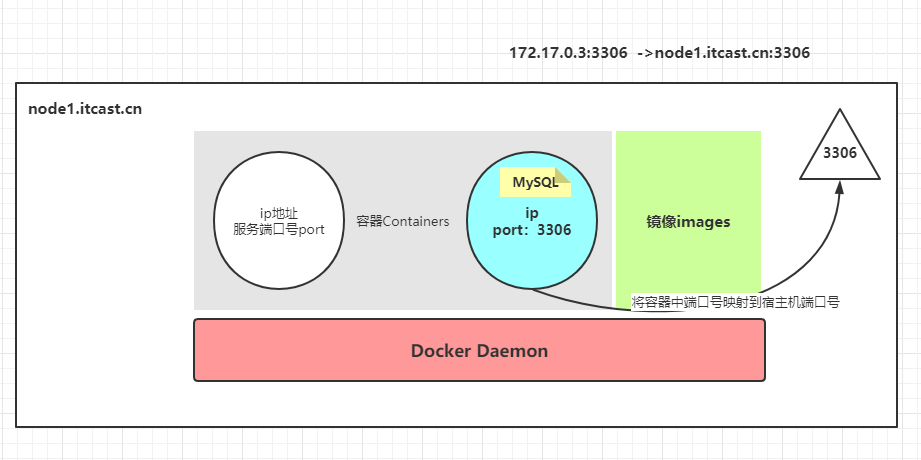

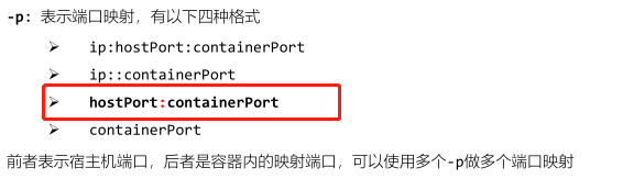

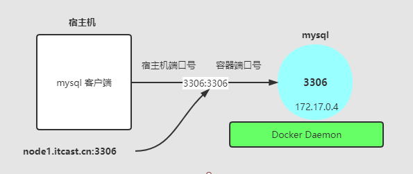

> 当创建容器以后,并且运行时,包含IP地址,提供相关网络适配器将宿主机IP地址转换为容器IP地址。[此外,如果容器中运行服务,需要暴露端口号,需要设置容器端口号与宿主机端口号映射。]()
![image-20210518175026918](https://img-blog.csdnimg.cn/img_convert/06dd81d00cf1c749450d61ade1f733e7.png)

[root@node1 ~]# docker search mysql

> 其中在创建容器时,需要指定端口号映射
![1615605653675](https://img-blog.csdnimg.cn/img_convert/64e8826a420af065f8e89b1cedda9015.png)
> 指定端口号映射方式:
![1615605683345](https://img-blog.csdnimg.cn/img_convert/784f07f0f9b9e7d8ae7e1bfe2ba0d064.png)
```ini
[root@node1 ~]# docker run -di --name=mysql -p 3306:3306 -e MYSQL_ROOT_PASSWORD=123456 centos/mysql-57-centos7
