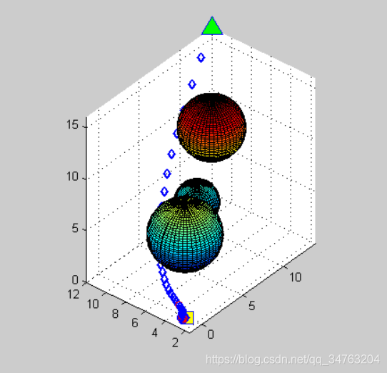

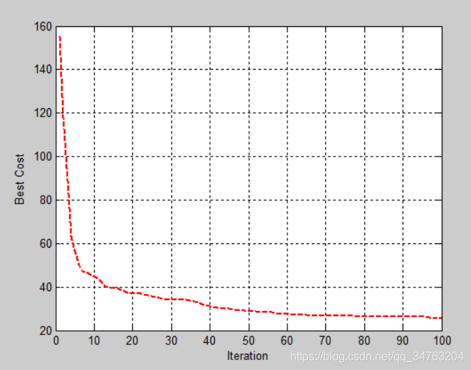

三、部分源代码

%% Results  ??
figure;
%plot(BestCost,'LineWidth',2);
plot(BestCost,'r--','LineWidth',2);
hold on;
%plot(BestCost2,'r--','linewidth',2)
xlabel('Iteration');
ylabel('Best Cost');
grid on;  %grid????????????,grid on?????,grid off?????

四、运行结果
