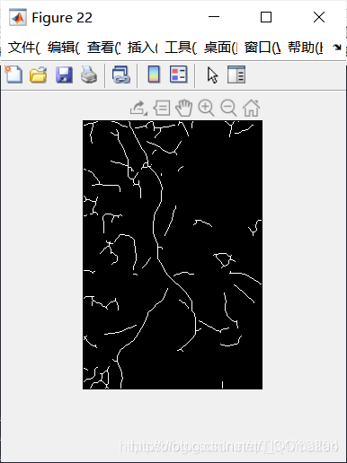

【裂缝识别】基于matlab组合BCOSFIRE过滤器墙体裂缝识别【含Matlab源码 321期】

二、部分源代码
function [ ] = PavementCrackDelineation( )
% NOTE: It requires a compiled mex-file of the fast implementation
% of the max-blurring function.
if ~exist('./COSFIRE/dilate')
BeforeUsing();
end
% temporary
dataset = 2;
CRACK_IVC = 1;
CRACK_PV14 = 2;
if dataset == CRACK_IVC
error('Dataset not yet available.')
return;
elseif dataset == CRACK_PV14
dname = 'CrackPV14';
imagesdir = 'cracks14';
gtdir = 'cracks14_gt';
prefix_gt = '';
end
% Binarization thresholds
thresholds = 0.01:0.01:0.99;
nthresholds = numel(thresholds);
%% Symmetric filter params and configuration
x = 101; y = 101; % center
line1(:, :) = zeros(201);
line1(:, x) = 1; %prototype line
% Parameters determined in the paper
% N.Strisciuglio, G. Azzopardi, N.Petkov, "Detection of curved lines
% with B-COSFIRE filters: A case study on crack delineation", CAIP 2017
sigma = 3.3;
len = 14;
sigma0 = 2;
alpha = 1;
symmfilter = cell(1);
symm_params = SystemConfig;
% COSFIRE params
symm_params.inputfilter.DoG.sigmalist = sigma;
symm_params.COSFIRE.rholist = 0:2:len;
symm_params.COSFIRE.sigma0 = sigma0 / 6;
symm_params.COSFIRE.alpha = alpha / 6;
% Orientations
numoriens = 12;
symm_params.invariance.rotation.psilist = 0:pi/numoriens:pi-pi/numoriens;
% Configuration
symmfilter{1} = configureCOSFIRE(line1, round([y x]), symm_params);
% Prepare the filter set
filterset(1) = symmfilter;
%% APplication of B-COSFIRE for crack delineation
files = rdir(['./data/' dname '/' imagesdir '/*.bmp']);
nfiles = size(files, 1);
% Initialize result matrix
nmetrics = 3;
RESULTS = zeros(nfiles + 1, nmetrics, nthresholds);
for n = 1:nfiles
fprintf('Processing image %d of %d. ', n, nfiles);
% Read image
imageInput = double(imread(files(n).name)) ./ 255;
% Read groud truth
[p, name, ext] = fileparts(files(n).name);
gt = double(imread(['./data/' dname '/' gtdir '/' prefix_gt name '.bmp'])) ./ 255;
imageInput = imcomplement(imageInput);
% Pad input image to avoid border effects
NP = 50; imageInput = padarray(imageInput, [NP NP], 'replicate');
% Filter response
inhibFactor = 0;
tuple = computeTuples(imageInput, filterset);
[response, rotations] = applyCOSFIRE_inhib(imageInput, filterset, inhibFactor, tuple);
response = response{1};
response = response(NP+1:end-NP, NP+1:end-NP);
% Cropping out the central part (unpadding)
rotations_final = zeros(size(response, 1), size(response, 2), size(rotations, 3));
for j = 1:size(rotations, 3)
rotations_final(:,:,j) = rotations(NP+1:end-NP, NP+1:end-NP, j);
end
% Evaluation
fprintf(' Result evaluation...\n');
for j = 1:nthresholds
% Thinning and Histeresis thresholding (using different
% thresholds). The threshold of the CAIP17 paper is th=49. Here
% we compute the performance for differen thresholds anyway to
% build and show the ROC curve.
binImg = binarize(rotations_final, thresholds(j));
binImg2 = bwmorph(binImg, 'close');
binImg2 = bwmorph(binImg2,'skel',Inf);
figure(j)
imshow(binImg2);
% Compute the result metrics for a tolerance of d = 2 (as in
% the paper)
[cpt2, crt2, F2] = evaluate(binImg2, gt, 2);
%[cpt3, crt3, F3] = evaluate(binImg2, gt, 3);
RESULTS(n, :, j) = [cpt2, crt2, F2];
end
end
% Average Results
avg_results = reshape(mean(RESULTS(1:nfiles, :, :)), nmetrics, nthresholds)';
[M, idx] = max(avg_results(:,3));
fprintf('\nResults of the CAIP17 paper\n');
fprintf('Pr: %.3f, Re: %.3f, F: %.3f\n', avg_results(idx, 1), avg_results(idx, 2), avg_results(idx, 3));
PrintROCcurve(avg_results);

三、运行结果
