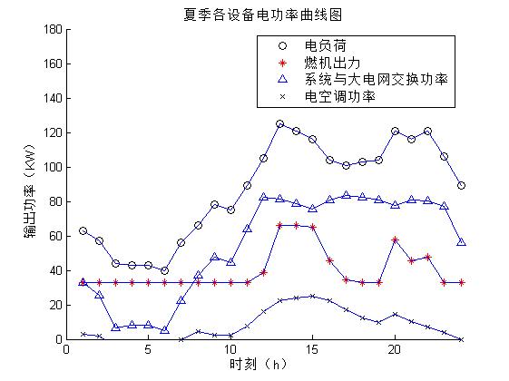

%画图程序
x=[1  2  3  4  5  6  7  8  9  10  11  12  13  14  15  16  17  18   19  20  21  22  23  24];
y1=PL;
y2=2.91*gbest(1,:);
y3=gbest(2,:);
y7=y2+y3-y1;
scatter(x,y1,'k')
hold on
scatter(x,y2,'r*')
hold on
scatter(x,y3,'b^')
hold on
scatter(x,y7,'kx')
plot(x,y1);
hold on
plot(x,y2);
hold on
plot(x,y3);
hold on
plot(x,y7);
 xlabel('时刻(h)');
ylabel('输出功率(KW)');
axis([0,24,0,180]);
legend('电负荷','燃机出力','系统与大电网交换功率','电空调功率');
title('夏季各设备电功率曲线图');

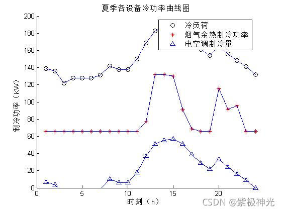

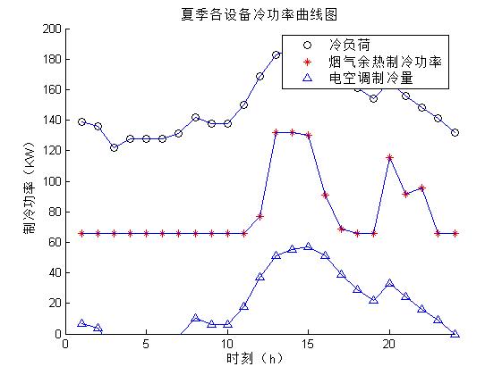

y4=QL;
y5=2*2.91*gbest(1,:);
y6=2.3*y7;
figure(2);
scatter(x,y4,'k')
hold on
scatter(x,y5,'r*')
hold on
scatter(x,y6,'b^')
plot(x,y4);
hold on
plot(x,y5);
hold on
plot(x,y6);
 xlabel('时刻(h)');
ylabel('制冷功率(KW)');
title('夏季各设备冷功率曲线图');

三、运行结果
