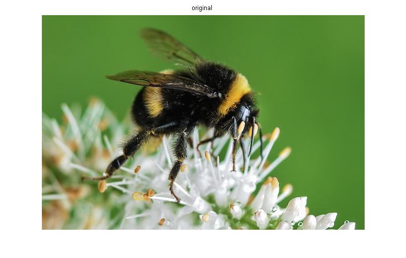

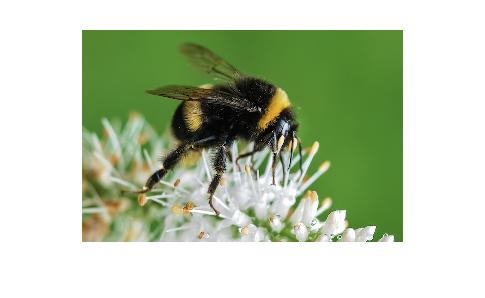

img = imread('bee.jpg');
imshow(img)
title('original')

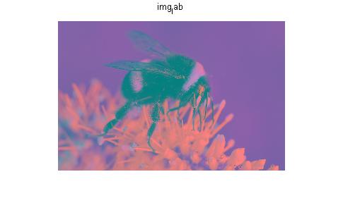

cform = makecform('srgb2lab'); %rgb空间转换成lab空间 matlab自带的用法,Create color transformation structure
img_Lab = applycform(img, cform); %rgb转换成lab空间
figure;
imshow(img_Lab)
title('img_lab')

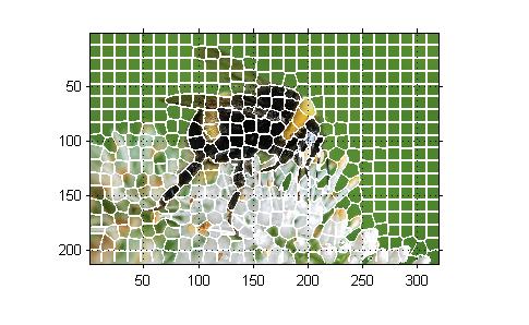

klabels = PerformSuperpixelSLIC(img_Lab, kseedsl, kseedsa, kseedsb, kseedsx, kseedsy, STEP, m_compactness);
%合并小的分区
[supmtrx,supmtry,nlabels] = EnforceLabelC(img_Lab, klabels, K);
% 这里的supmtrx,supmtry的每列分别是对应标签区域的全部x坐标和y坐标
