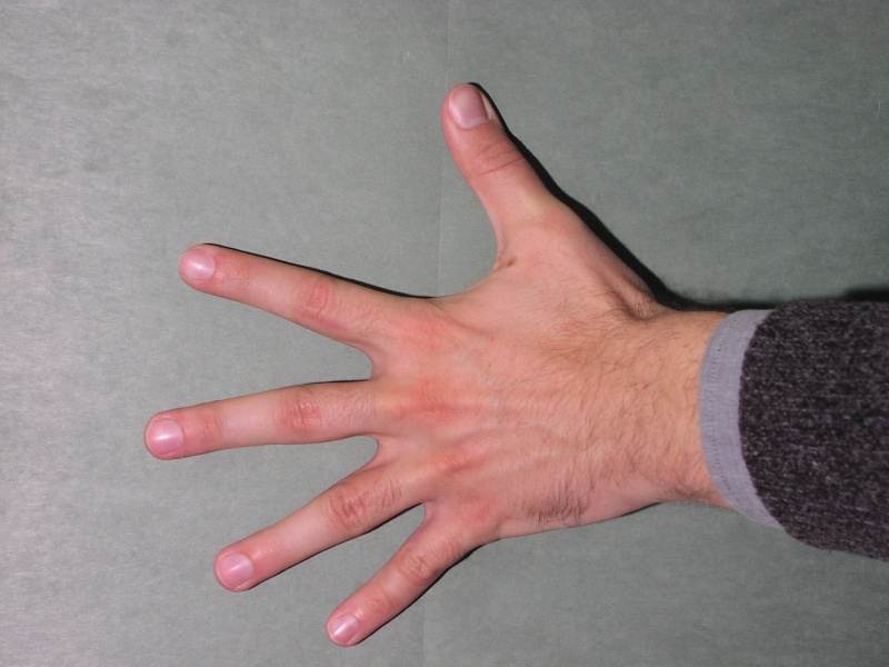

提取手部轮廓特征,k-means聚类算法,训练得到手势识别模型,然后用测试数据测试。

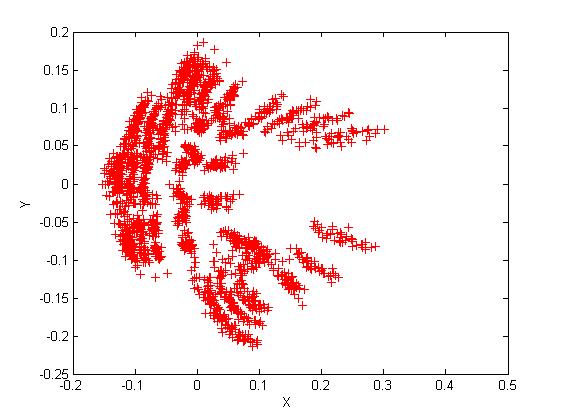

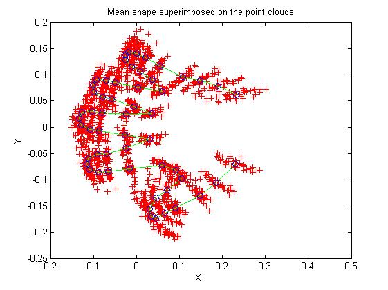

%-----------------compute the mean shape coordinates
%   every column of colm is the mean cooridnate of all the 40 hands'
%   coordinate respectively
colm=mean(aligned);              % mean(X) 求每一列元素的均值
for i=1:56
     XX(i)=colm(i);            % the mean x-axis coordinate of every landmark
     YY(i)=colm(i+56);         % the mean y-axis coordinate of every landmark
end
% subplot(1,2,1);
% figure;
% plot(XX,YY,'g-',XX,YY,'rx');               % show the mean shape of 40 hands
