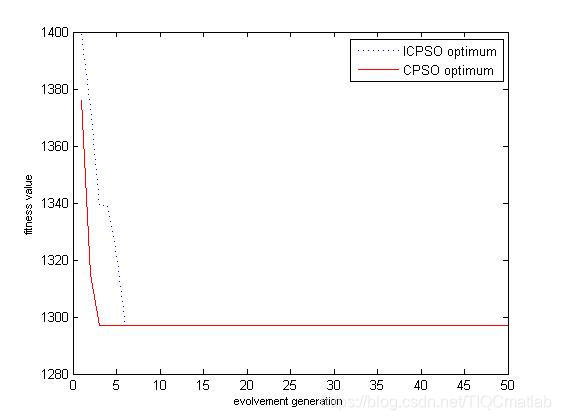

四、部分源代码
clear;
w=3;% 程序运行次数
genn=50; %%%%%%%%%%%%%%%%%%%%%%%%%%%%%%%%%%%%%%%%%%%%%%%%%%%%%%%%%%%%%%%%%%%%%%%%最大代数
PS=50; %%%%%%%%%%%%%%%%%%%%%%%%%%%%%%%%%%%%%%%%%%%%%%%%%%%%%%%%%%%%%%%%%%%%%%%% 种群规模
e=0.4; %%%%%%%%%%%%%%%%%%%%%%%%%%%%%%%%%%%%%%%%%%%%%%%%%%%%%%%%%%%%%%%%%%%%%%%% PSO算法惯性因子
ICPSOm=zeros(1,w);
ICPSOOptimy=cell(w,1);
CPSOm=zeros(1,w);
T=[ 54 79 16 66 58
83 3 89 58 56
15 11 49 31 20
71 99 15 68 85
77 56 89 78 53
36 70 45 91 35
53 99 60 13 53
38 60 23 59 41
27 5 57 49 69
87 56 64 85 13
76 3 7 85 86
91 61 1 9 72
14 73 63 39 8
29 75 41 41 49
12 47 63 56 47
77 14 47 40 87
32 21 26 54 58
87 86 75 77 18
68 5 77 51 68
94 77 40 31 28];
pt=T';
global v
for v=1:w
[opy,optimya]=ICPSOflowshop(pt,genn,PS,e);
ICPSOm(v)=opy;

五、运行结果
