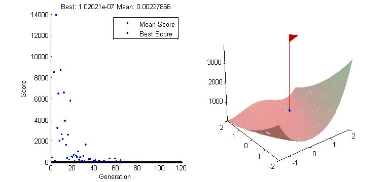

function [xOpt,fval,exitflag,output,population,scores] = ...
    pso(fitnessfcn,nvars,Aineq,bineq,Aeq,beq,LB,UB,nonlcon,options)
% Find the minimum of a function using Particle Swarm Optimization.
% This is an implementation of Particle Swarm Optimization algorithm using
% the same syntax as the Genetic Algorithm Toolbox, with some additional
% options specific to PSO. Allows code-reusability when trying different
% population-based optimization algorithms. Certain GA-specific parameters
% such as cross-over and mutation functions will not be applicable to the
% PSO algorithm. Demo function included, with a small library of test
% functions. Requires Optimization Toolbox.
% New features will be added regularly until this is made redundant by an
% official MATLAB PSO toolbox.
% Author: S. Samuel Chen. Version 1.31.2.
% Available from http://www.mathworks.com/matlabcentral/fileexchange/25986
% Distributed under BSD license. First published in 2009.
% Syntax:

三、运行结果
