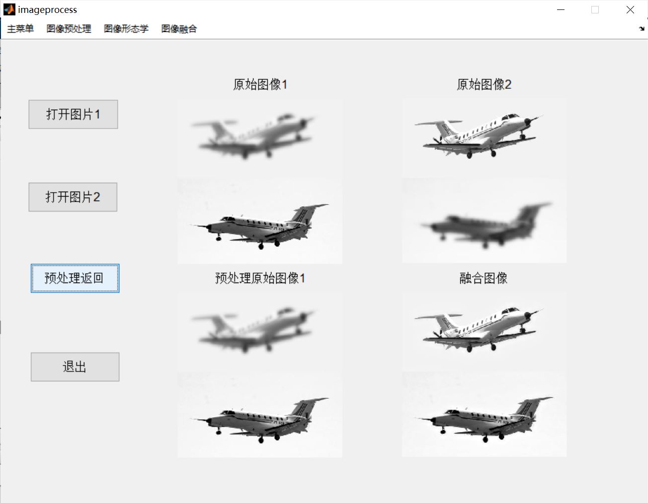

global im1
global im2
im11 = double(im1)/255;
im22 = double(im2)/255;
%普拉斯金塔变换参数
mp = 3;zt =4; cf =1;ar = 1; cc = [cf ar];
Y_lap = fuse_lap(im11,im22,zt,cc,mp);
axes(handles.axes4);
imshow(Y_lap);

三、运行结果
