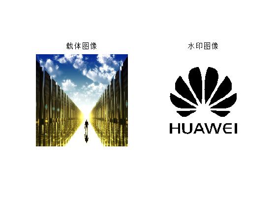

I = imread('1.png');
% I = double(rgb2gray(I));
% I = im2double(I);
[WS,map,alpha] = imread('水印01.png');  %读取水印图像
W=double(255-alpha);    %alpha 为透明度,此图不透明alpha=0
[mw,nw]=size(W);
W=logical(W);
figure,subplot(121),imshow(I);title('载体图像')
subplot(122),imshow(W);title('水印图像')

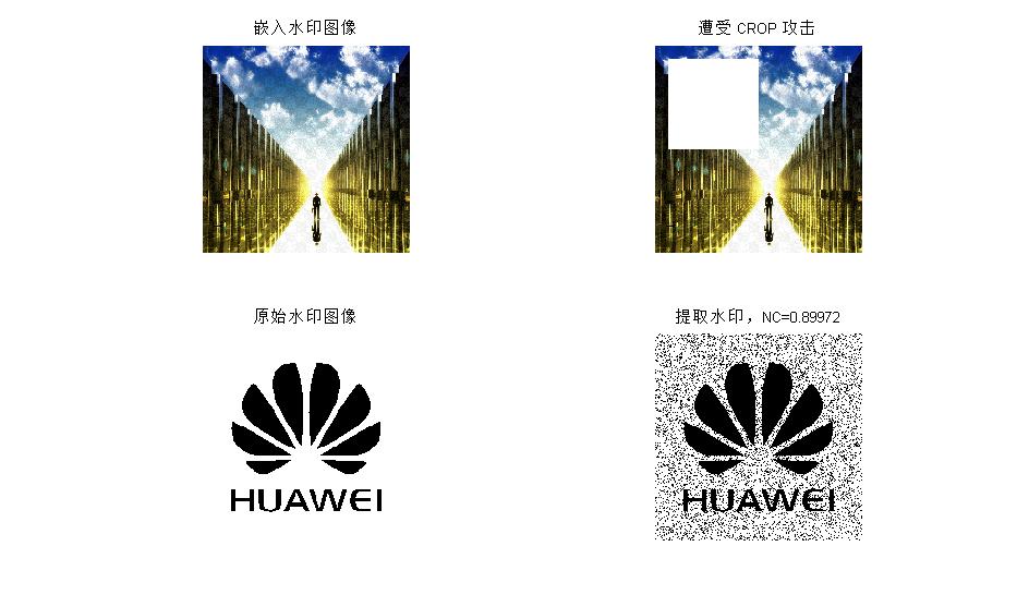

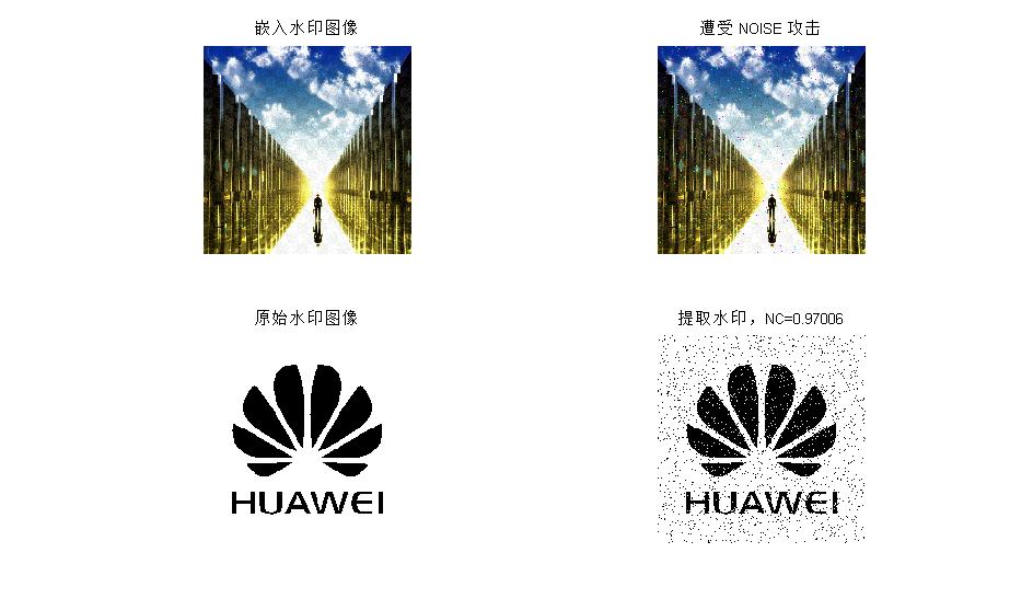

ntimes=20;rngseed=59433;
%添加水印
Iw = (setdwtwatermark(I,W,ntimes,rngseed));
%计算水印图像的峰值信噪比
mn=numel(I);
Imax=max(I(:));
% psnr=10*log10(mn*double(Imax)^2/sum((im2double(I(:))-im2double(Iw(:))).^2));
peaksnr=psnr(im2uint8(Iw),I);
%提取水印
Wg=getdwtwatermark(Iw,W,ntimes,rngseed);
nc=sum(Wg(:).*W(:))/sqrt(sum(Wg(:).^2))/sqrt(sum(W(:).^2));
figure,subplot(121),imshow(Iw);title('嵌入水印后的载体图像')
subplot(122),imshow(Wg),title(['从载体图像中提取出的水印,NC=',num2str(nc)]);

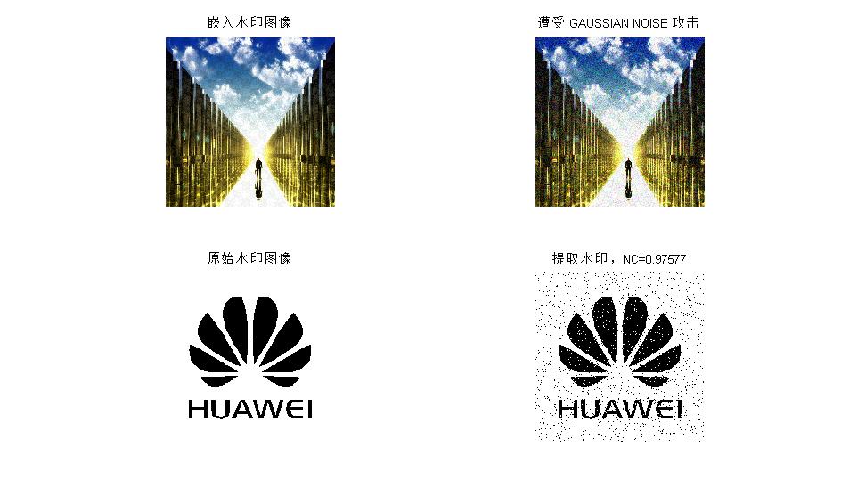

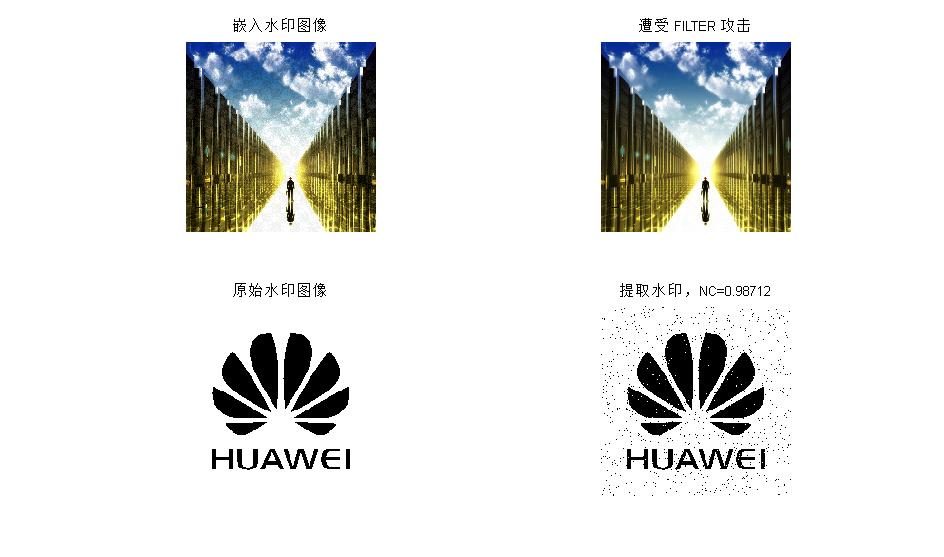

switch lower(action)
    case 'filter'
        Ia=imfilter(Iw,ones(3)/9);
    case 'gaussian noise'
        Ia=imnoise(Iw,'gaussian');

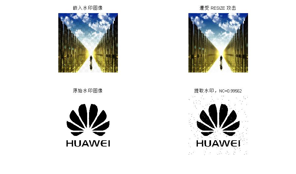

    case 'resize'
        Ia=imresize(Iw,0.5);
        Ia=imresize(Ia,2);
    case 'noise'
        Ia=imnoise(Iw,'salt & pepper',0.01);
    case 'crop'
        Ia=Iw;
        Ia(50:400,50:400,:)=randn();

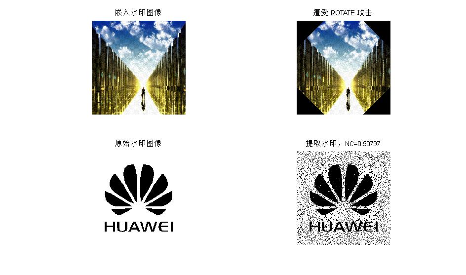

    case 'rotate'
        Ia=imrotate(Iw,45,'nearest','crop');
        Ia=imrotate(Ia,-45,'nearest','crop');

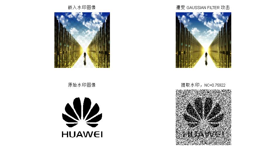

    case 'gaussian filter' %高斯模糊
        G = fspecial('gaussian', [5 5], 2);
        Ia = imfilter(Iw,G,'same');
