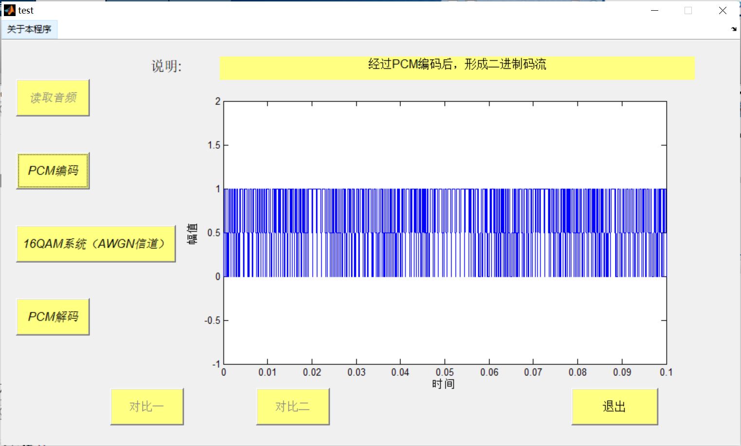

set(handles.text1,'String','测试音频文件波形如图所示');

sxx = floor( x1 * 4096 );
y = pcm_encode(sxx);
save('data.mat','y','-append');
subplot(1,1,1,'position',[0.3 0.2 0.6 0.65]);
plot(t8,y);
xlabel('时间');
ylabel('幅值');
axis([0 0.1 -1 2]);
set(handles.dePCM,'enable','on');
set(handles.QAM,'enable','on');
set(handles.text1,'String','经过PCM编码后,形成二进制码流');
