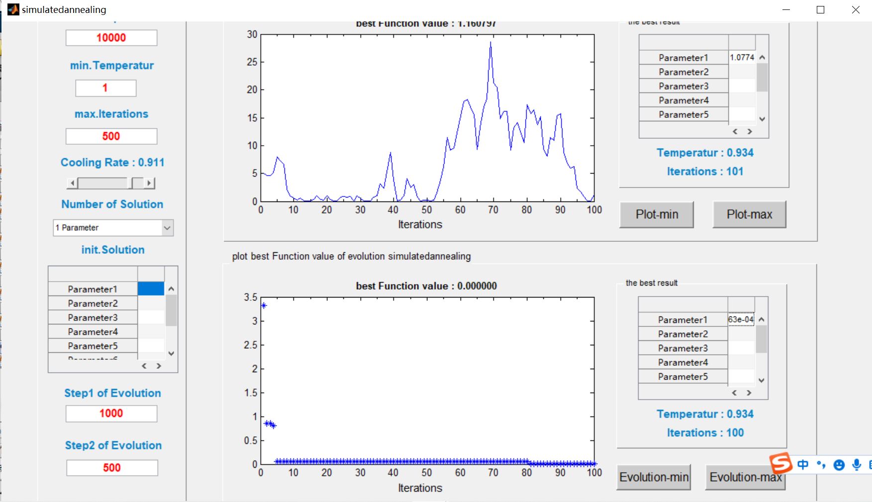

模拟退火算法流程如图7.1所示。

% --- Executes on slider movement.
function set_cooling_rate_Callback(hObject, eventdata, handles)
% Hints: get(hObject,'Value') returns position of slider
%        get(hObject,'Min') and get(hObject,'Max') to determine range of slider
s = sprintf('Cooling Rate : %0.3f',get(hObject,'Value'));
set(handles.cooling_rate_disp, 'String', s);
guidata(hObject, handles);
% --- Executes during object creation, after setting all properties.
function set_cooling_rate_CreateFcn(hObject, eventdata, handles)
% Hint: slider controls usually have a light gray background.
if isequal(get(hObject,'BackgroundColor'), get(0,'defaultUicontrolBackgroundColor'))
    set(hObject,'BackgroundColor',[.9 .9 .9]);
end
function cooling_rate_disp_CreateFcn(hObject, eventdata, handles)
% --- Executes when entered data in editable cell(s) in Parameter.
function Parameter_CellEditCallback(hObject, eventdata, handles)
% hObject    handle to Parameter (see GCBO)
% eventdata  structure with the following fields (see UITABLE)
%	Indices: row and column indices of the cell(s) edited
%	PreviousData: previous data for the cell(s) edited
%	EditData: string(s) entered by the user
%	NewData: EditData or its converted form set on the Data property. Empty if Data was not changed
%	Error: error string when failed to convert EditData to appropriate value for Data
% handles    structure with handles and user data (see GUIDATA)
% --- Executes on button press in Start.
function Start_Callback(hObject, eventdata, handles)
% get init_solution_selection
Pm = get(handles.Parameterzahl, 'Value');
initsolution = get(handles.Parameter, 'Data');
initsolution = str2double(initsolution);
initsolution = initsolution(1:Pm,1);   %nach dem Anzahl der Parameter veraedern
% get init_temperatur
inittemperatur = get(handles.init_temperatur_input,'String');
inittemperatur = str2double(inittemperatur);
% get cooling_rate
coolingrate = get(handles.set_cooling_rate,'Value');
% get max_iterations
maxiterations = get(handles.max_iterations_input,'String');
maxiterations = str2double(maxiterations);
% get min_temperatur
mintemperature = get(handles.min_temperatur_input,'String');
mintemperature = str2double(mintemperature);
if isnan(initsolution)
    %disp('falsch input');
    titledisp=sprintf('**falsch input check Parameter input**' );
    text(.2,.5,titledisp,'fontweight','bold','color','red');
else
    axes(handles.axes1)
    [Xopt Xcurrent] = Sahaupt( inittemperatur ,coolingrate,...
      maxiterations,initsolution,mintemperature);
    set(handles.axes1,'XMinorTick','on')
end
% --- Executes on button press in evolution.
function evolution_Callback(hObject, eventdata, handles)
% hObject    handle to evolution (see GCBO)
% eventdata  reserved - to be defined in a future version of MATLAB
Pme = get(handles.Parameterzahl, 'Value');
initsolution = initsolution(1:Pme,1);   %nach dem Anzahl der Parameter veraedern
% get cooling_rate
% plot
else
    axes(handles.axes2)
    Evolution( inittemperatur ,coolingrate,...
    set(handles.axes2,'XMinorTick','on')
end
% --- Executes on selection change in Parameterzahl.
function Parameterzahl_Callback(hObject, eventdata, handles)
% hObject    handle to Parameterzahl (see GCBO)
% Hints: contents = get(hObject,'String') returns Parameterzahl contents as cell array
%        contents{get(hObject,'Value')} returns selected item from Parameterzahl
function Parameterzahl_CreateFcn(hObject, eventdata, handles)
% handles    empty - handles not created until after all CreateFcns called
% Hint: popupmenu controls usually have a white background on Windows.
%       See ISPC and COMPUTER.
if ispc && isequal(get(hObject,'BackgroundColor'), get(0,'defaultUicontrolBackgroundColor'))
    set(hObject,'BackgroundColor','white');
end
