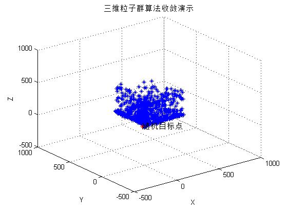

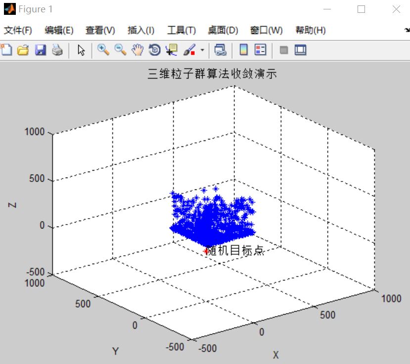

plot3(ox,oy,oz,'r*');
title('三维粒子群算法收敛演示');
text(ox,oy,oz,'随机目标点');
xlabel('X'),
ylabel('Y'),
zlabel('Z');
axis([-RNPA*SR SR -RNPA*SR SR -RNPA*SR SR]);
grid on;
hold on;
plot3(x,y,z,'b*');
hold off;

四、运行结果
