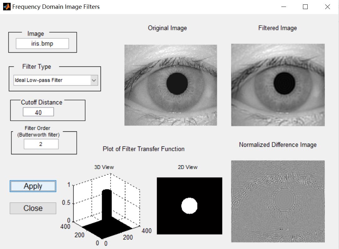

                    一、滤波器虹膜识别简介
理论知识参照文献链接:基于加权Gabor滤波器的虹膜识别

function varargout = frequencydem(varargin)
% Auth...
    一、滤波器虹膜识别简介
二、部分源代码
% Author : Yingzi Eliza Du
% Version: 1.0
% Date   : January, 27 2004
% Begin initialization code - DO NOT EDIT
gui_Singleton = 1;
gui_State = struct('gui_Name',       mfilename, ...
                   'gui_Singleton',  gui_Singleton, ...
                   'gui_OpeningFcn', @frequencydem_OpeningFcn, ...
                   'gui_OutputFcn',  @frequencydem_OutputFcn, ...
                   'gui_LayoutFcn',  [] , ...
                   'gui_Callback',   []);
if nargin & isstr(varargin{1})
    gui_State.gui_Callback = str2func(varargin{1});
end
if nargout
    [varargout{1:nargout}] = gui_mainfcn(gui_State, varargin{:});
else
end
% End initialization code - DO NOT EDIT
% --- Executes just before frequencydem is made visible.
function frequencydem_OpeningFcn(hObject, eventdata, handles, varargin)
handles.output = hObject;
% Update handles structure
guidata(hObject, handles);
movegui(hObject,'onscreen')% To display application onscreen
movegui(hObject,'center')  % To display application in the center of screen
image_file = get(handles.nameEdit,'String');
im_original=image_read(char(image_file));
set(handles.Or_image,'HandleVisibility','OFF')
set(handles.filtered_image,'HandleVisibility','OFF');
set(handles.difference_image,'HandleVisibility','OFF');
set(handles.filt3D,'HandleVisibility','OFF');
set(handles.filt2D,'HandleVisibility','OFF');
set(handles.Or_image,'HandleVisibility','ON')
axes(handles.Or_image);
 imagesc(im_original);
 colormap(gray(256));
 axis equal;
axis tight;
axis off;
set(handles.Or_image,'XTickLabel',' ','YTickLabel',' ')
% --- Outputs from this function are returned to the command line.
function varargout = frequencydem_OutputFcn(hObject, eventdata, handles)
varargout{1} = handles.output;
% --- Executes during object creation, after setting all properties.
function image_selection_CreateFcn(hObject, eventdata, handles)
if ispc
    set(hObject,'BackgroundColor','white');
else
    set(hObject,'BackgroundColor',get(0,'defaultUicontrolBackgroundColor'));
end
% Executes on button press in apply_button.
function apply_button_Callback(hObject, eventdata, handles)
image_file = get(handles.nameEdit,'String');  % to read the image filename selected
im_original=image_read(char(image_file));  % filename
% set(handles.Or_image,'HandleVisibility','ON')  % to make plot 1 visible for original image plot
% image(im_original);
% colormap(gray(256));
% axis image;
% axis off;
% set(handles.filtered_image,'HandleVisibility','OFF') % to make plot 2 unvisible to the original image plot
set(handles.Or_image,'XTickLabel',' ','YTickLabel',' ') % to get rid of tick labels
method_number = get(handles.method_selection,'Value'); % selected method
t = get(handles.cutoffEdit,'String');
F_cut = str2num (t);
if F_cut <= 0
    msgbox ('Please input meaningful cut off frequency');
    return
end;
% For gaussian blur and USM-Filter method
switch method_number
    case { 1 } %Ideal Filter
        [im_filtered, H] = ideal_low(im_original, F_cut);
     case { 2 }
        [im_filtered, H] = ideal_high(im_original, F_cut);
     case { 3 }
        [im_filtered, H] = gaussian_low(im_original,F_cut);
     case { 4 }
        [im_filtered, H]= gaussian_high(im_original, F_cut);
     case { 5 }
         t = get(handles.butflyEdit,'String');
         n = str2num (t);
         if t <= 0
             msgbox('Invalid order number!');
             return;
         end;
         [im_filtered, H] = butterworth_low(im_original, F_cut,n);
     case { 6 }
         n = str2num (t);
         if t <= 0
             return;
         end;
         [im_filtered, H] = butterworth_high(im_original, F_cut,n);
 end;
 axis equal;
axis tight;
axis off;
set(handles.filtered_image,'HandleVisibility','ON') ; % to make plot 2 visible to the filtered image plot
axes(handles.filtered_image);
imagesc(im_filtered) % to plot filtered image
axis equal;
axis tight;
axis off;
set(handles.difference_image,'HandleVisibility','ON');
axes(handles.difference_image);
dif_image = im_filtered- im_original;
imagesc(dif_image);
axis equal;
axis tight;
axis off;
set(handles.filt2D,'HandleVisibility','ON');
axes(handles.filt2D);
imagesc(H);
axis equal;
axis tight;
axis off;
set(handles.filt3D,'HandleVisibility','ON');
axes(handles.filt3D);
[co,ro]=size(H);
surfl(H);
% --- Executes on button press in close_button.
function close_button_Callback(hObject, eventdata, handles)
close all; % to close GUI
function method_selection_CreateFcn(hObject, eventdata, handles)
if ispc
else
end
function nameEdit_CreateFcn(hObject, eventdata, handles)
% hObject    handle to nameEdit
% eventdata  reserved - to be defined in a future version of MATLAB
% handles    empty - handles not created until after all CreateFcns called
% Hint: edit controls usually have a white background on Windows.
%       See ISPC and COMPUTER.
if ispc
else
end
%Read all kinds of image files
function im_original=image_read(image_file)
lg=length(image_file);
if strcmpi(image_file(lg-2:lg),'mat') | strcmpi(image_file(lg-2:lg),'dat')
    im_original=load(image_file);
else
im_original=imread(char(image_file));
end;
im_original = double(im_original);
t=size(im_original,3);
if t==3
    imt=floor((im(:,:,1)+im(:,:,2)+im(:,:,3))/3);
    clear im_original;
    im_original=imt;
    clear imt;
end;
if t~=1
    display('Error in opening the image file!');
end;
% butterworth high pass filter
function [out, H] = butterworth_high (im,fc,n)
    [co,ro] = size(im);
    cx = round(co/2); % find the center of the image
    cy = round (ro/2);
    imf=fftshift(fft2(im));
    H=zeros(co,ro);
    for i = 1 : co
        for j =1 : ro
               d = (i-cx).^2 + (j-cy).^ 2;
               if d ~= 0
               H(i,j) = 1/(1+((fc*fc/d).^(2*n)));
           end;
        end;
    end;

三、运行结果
