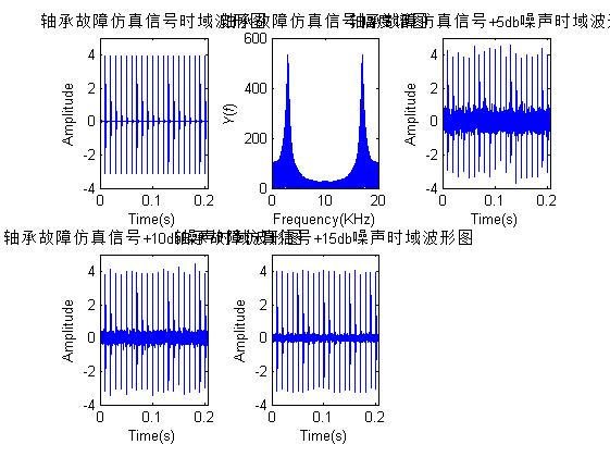

fs = 20e3; % 采样频率
fn = 3e3; % 固有频率
y0 = 5; % 位移常数
g = 0.1; % 阻尼系数
T = 0.01; % 重复周期
N = 4096; % 采样点数
NT = round(fs*T); % 单周期采样点数
t = 0:1/fs:(N-1)/fs; % 采样时刻
t0 = 0:1/fs:(NT-1)/fs; % 单周期采样时刻
K = ceil(N/NT)+1; % 重复次数
y = [];
for i = 1:K
y = [y,y0*exp(-g*2*pi*fn*t0).*sin(2*pi*fn*sqrt(1-g^2)*t0)];
end
y = y(1:N);
Yf = fft(y); % 频谱
figure(1);subplot(231);
plot(t,y);
axis([0,inf,-4,5])
title('轴承故障仿真信号时域波形图')
xlabel('Time(s)')
ylabel('Amplitude')
y5 = awgn(y,5,'measured'); % Add white Gaussian noise
y10 = awgn(y,10,'measured'); % Add white Gaussian noise
y15 = awgn(y,15,'measured'); % Add white Gaussian noise

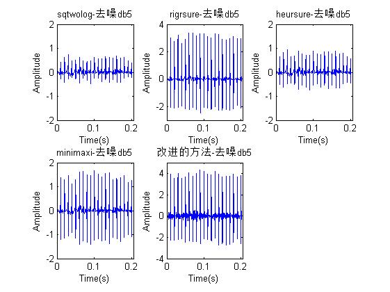

figure(2);
xd51 = wden(y5,'sqtwolog','s','one',5,'db5');
subplot(231);plot(t,xd51);axis([0,inf,-2,2]);title('sqtwolog-去噪db5');xlabel('Time(s)');ylabel('Amplitude');
mse1=MSE(y5,xd51)
PSNR1=PSNR(y5,xd51)
xd52 = wden(y5,'rigrsure','s','one',5,'db5');
subplot(232);plot(t,xd52);axis([0,inf,-3,4]);title('rigrsure-去噪db5');xlabel('Time(s)');ylabel('Amplitude');
mse2=MSE(y5,xd52)
PSNR2=PSNR(y5,xd52)
xd53 = wden(y5,'heursure','s','one',5,'db5');
subplot(233);plot(t,xd53);axis([0,inf,-2,2]);title('heursure-去噪db5');xlabel('Time(s)');ylabel('Amplitude');
mse3=MSE(y5,xd53)
PSNR3=PSNR(y5,xd53)
xd54 = wden(y5,'minimaxi','s','one',5,'db5');
subplot(234);plot(t,xd54);axis([0,inf,-2,2]);title('minimaxi-去噪db5');xlabel('Time(s)');ylabel('Amplitude');
mse4=MSE(y5,xd54)
PSNR4=PSNR(y5,xd54)
[thr,sorh,keepapp]=ddencmp('den','wv',y5);%ddencmp用于获取信号在消噪或压缩过程中的默认阈值
xd55=den_gaijin(y5,'db5',5,thr);
subplot(235);plot(t,xd55);axis([0,inf,-4,5]);title('改进的方法-去噪db5');xlabel('Time(s)');ylabel('Amplitude');
mse5=MSE(y5,xd55)
PSNR5=PSNR(y5,xd55)

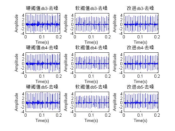

figure(3);
xdy8=denh(y5,'db3',5,thr);%硬阈值
subplot(331);plot(t,xdy8);axis([0,inf,-4,5]);title('硬阈值db3-去噪');xlabel('Time(s)');ylabel('Amplitude');
mse81=MSE(y5,xdy8)
PSNR81=PSNR(y5,xdy8)
xdr8=dens(y5,'db3',5,thr);%软阈值
subplot(332);plot(t,xdr8);axis([0,inf,-4,5]);title('软阈值db3-去噪');xlabel('Time(s)');ylabel('Amplitude');
mse82=MSE(y5,xdr8)
PSNR82=PSNR(y5,xdr8)
xdA8=den_gaijin(y5,'db3',5,thr);%改进
subplot(333);plot(t,xdA8);axis([0,inf,-4,5]);title('改进db3-去噪');xlabel('Time(s)');ylabel('Amplitude');
mse83=MSE(y5,xdA8)
PSNR83=PSNR(y5,xdA8)
xdy9=denh(y5,'db4',5,thr);%硬阈值
subplot(334);plot(t,xdy9);axis([0,inf,-4,5]);title('硬阈值db4-去噪');xlabel('Time(s)');ylabel('Amplitude');
mse91=MSE(y5,xdy9)
PSNR91=PSNR(y5,xdy9)
xdr9=dens(y5,'db4',5,thr);%软阈值
subplot(335);plot(t,xdr9);axis([0,inf,-4,5]);title('软阈值db4-去噪');xlabel('Time(s)');ylabel('Amplitude');
mse92=MSE(y5,xdr9)
PSNR92=PSNR(y5,xdr9)
xdA9=den_gaijin(y5,'db4',5,thr);%改进
subplot(336);plot(t,xdA9);axis([0,inf,-4,5]);title('改进db4-去噪');xlabel('Time(s)');ylabel('Amplitude');
mse93=MSE(y5,xdA9)
PSNR93=PSNR(y5,xdA9)
xdy10=denh(y5,'db5',5,thr);%硬阈值
subplot(337);plot(t,xdy10);axis([0,inf,-4,5]);title('硬阈值db5-去噪');xlabel('Time(s)');ylabel('Amplitude');
mse101=MSE(y5,xdy10)
PSNR101=PSNR(y5,xdy10)
xdr10=dens(y5,'db5',5,thr);%软阈值
subplot(338);plot(t,xdr9);axis([0,inf,-4,5]);title('软阈值db5-去噪');xlabel('Time(s)');ylabel('Amplitude');
mse102=MSE(y5,xdr10)
PSNR102=PSNR(y5,xdr10)
xdA10=den_gaijin(y5,'db5',5,thr);%改进
subplot(339);plot(t,xdA10);axis([0,inf,-4,5]);title('改进db5-去噪');xlabel('Time(s)');ylabel('Amplitude');
mse103=MSE(y5,xdA10)
PSNR103=PSNR(y5,xdA10)

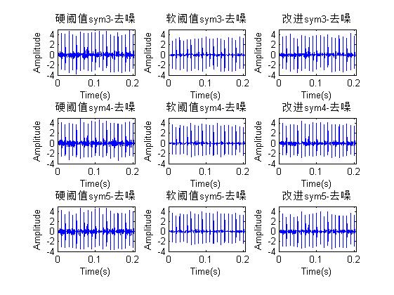

figure(4);
xdy8=denh(y5,'sym3',5,thr);%硬阈值
subplot(331);plot(t,xdy8);axis([0,inf,-4,5]);title('硬阈值sym3-去噪');xlabel('Time(s)');ylabel('Amplitude');
mse81=MSE(y5,xdy8)
xdr8=dens(y5,'sym3',5,thr);%软阈值
subplot(332);plot(t,xdr8);axis([0,inf,-4,5]);title('软阈值sym3-去噪');xlabel('Time(s)');ylabel('Amplitude');
mse82=MSE(y5,xdr8)
xdA8=den_gaijin(y5,'sym3',5,thr);%改进
subplot(333);plot(t,xdA8);axis([0,inf,-4,5]);title('改进sym3-去噪');xlabel('Time(s)');ylabel('Amplitude');
mse83=MSE(y5,xdA8)
xdy9=denh(y5,'sym4',5,thr);%硬阈值
subplot(334);plot(t,xdy9);axis([0,inf,-4,5]);title('硬阈值sym4-去噪');xlabel('Time(s)');ylabel('Amplitude');
mse91=MSE(y5,xdy9)
xdr9=dens(y5,'sym4',5,thr);%软阈值
subplot(335);plot(t,xdr9);axis([0,inf,-4,5]);title('软阈值sym4-去噪');xlabel('Time(s)');ylabel('Amplitude');
mse92=MSE(y5,xdr9)
xdA9=den_gaijin(y5,'sym4',5,thr);%改进
subplot(336);plot(t,xdA9);axis([0,inf,-4,5]);title('改进sym4-去噪');xlabel('Time(s)');ylabel('Amplitude');
mse93=MSE(y5,xdA9)
xdy10=denh(y5,'sym5',5,thr);%硬阈值
subplot(337);plot(t,xdy10);axis([0,inf,-4,5]);title('硬阈值sym5-去噪');xlabel('Time(s)');ylabel('Amplitude');
xdr10=dens(y5,'sym5',5,thr);%软阈值
subplot(338);plot(t,xdr9);axis([0,inf,-4,5]);title('软阈值sym5-去噪');xlabel('Time(s)');ylabel('Amplitude');
xdA10=den_gaijin(y5,'sym5',5,thr);%改进
subplot(339);plot(t,xdA10);axis([0,inf,-4,5]);title('改进sym5-去噪');xlabel('Time(s)');ylabel('Amplitude');
