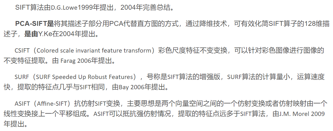

二、简介

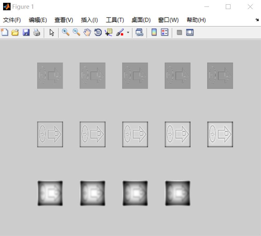

%create the DoG pyramid.
for i=1:octave
temp_D=D{i};
sigma=sigma*sqrt(2)^(i-1);
for j=1:level
p=(level)*(i-1);
figure(1);
subplot(octave,level,p+j);
f=fspecial('gaussian',[1,floor(6*sigma*k^(p+j-1))],sigma*k^(p+j-1));
L1=temp_img;
if(i==1&&j==1)
L2=conv2(temp_img,f,'same');
L2=conv2(L2,f','same');
temp_D(:,:,j)=L2-L1;
imshow(uint8(255 * mat2gray(temp_D(:,:,j))));
L1=L2;
else
L1=L2;
if(j==level)
temp_img=L1(2:end-1,2:end-1);
end
end
end
D{i}=temp_D;
temp_img=temp_img(1:2:end,1:2:end);
temp_img=padarray(temp_img,[1,1],'replicate');
end
