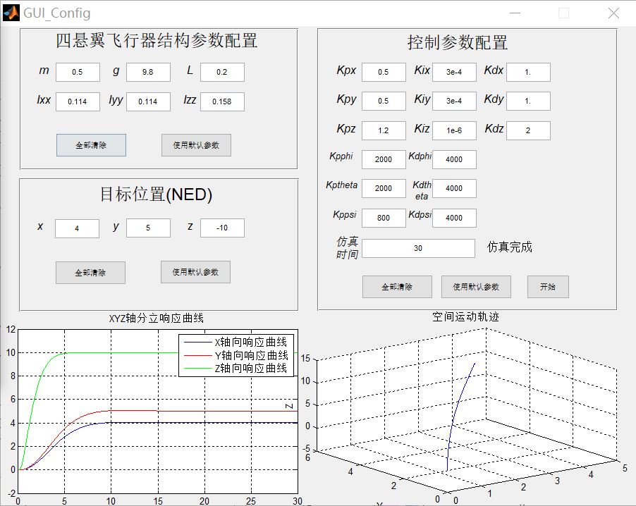

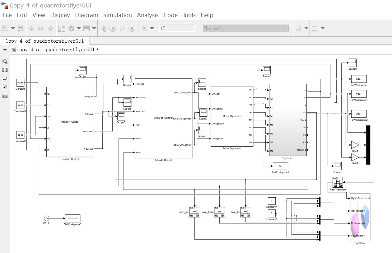

2 四旋翼飞行器的控制系统构建与仿真
经典PID算法结构简单,基于偏差设计反馈律,不依赖受控对象的具体数学模型,在很多过程控制中均有良好表现。尽管各种新的控制算法不断涌现,但是并没有改变PID控制算法在工业控制中的主导地位。本文根据四旋翼在飞行过程中经常会遇到不确定外界干扰等情况,设计了基于小扰动的PID控制器,如图2所示。
图2 PID控制器结构图

 function varargout = GUI_Config(varargin)
% GUI_CONFIG MATLAB code for GUI_Config.fig
%      GUI_CONFIG, by itself, creates a new GUI_CONFIG or raises the existing
%      singleton*.
%      H = GUI_CONFIG returns the handle to a new GUI_CONFIG or the handle to
%      the existing singleton*.
%      GUI_CONFIG('CALLBACK',hObject,eventData,handles,...) calls the local
%      function named CALLBACK in GUI_CONFIG.M_VALUE with the given input arguments.
%      GUI_CONFIG('Property','Value',...) creates a new GUI_CONFIG or raises the
%      existing singleton*.  Starting from the left, property value pairs are
%      applied to the GUI before GUI_Config_OpeningFcn gets called.  An
%      unrecognized property name or invalid value makes property application
%      stop.  All inputs are passed to GUI_Config_OpeningFcn via varargin.
%      *See GUI Options on GUIDE's Tools menu.  Choose "GUI allows only one
%      instance to run (singleton)".
% See also: GUIDE, GUIDATA, GUIHANDLES
% Edit the above text to modify the response to help GUI_Config
% Last Modified by GUIDE v2.5 26-Nov-2020 18:35:51
% Begin initialization code - DO NOT EDIT
gui_Singleton = 1;
gui_State = struct('gui_Name',       mfilename, ...
                   'gui_Singleton',  gui_Singleton, ...
                   'gui_OpeningFcn', @GUI_Config_OpeningFcn, ...
                   'gui_OutputFcn',  @GUI_Config_OutputFcn, ...
                   'gui_LayoutFcn',  [] , ...
                   'gui_Callback',   []);
if nargin && ischar(varargin{1})
    gui_State.gui_Callback = str2func(varargin{1});
end
if nargout
    [varargout{1:nargout}] = gui_mainfcn(gui_State, varargin{:});
else
end
% End initialization code - DO NOT EDIT
