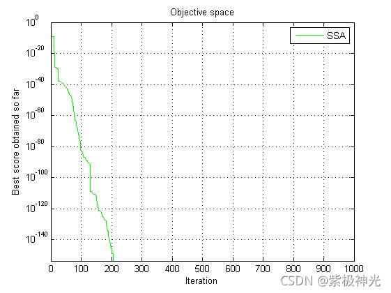

%Draw objective space
 semilogy(SSA_curve,'Color','g')
axis ([0 1000 0 1 ])
title('Objective space')
xlabel('Iteration');
ylabel('Best score obtained so far');
%axis tight
grid on
box on
legend('SSA')
display(['The best solution obtained by SSA is : ', num2str(bestX)]);
  display(['The best optimal value of the objective funciton found by SSA is : ', num2str(fMin)]);

四、运行结果
