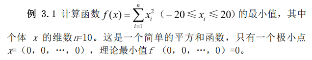

1 案例
2 完整代码

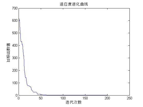

%%%%%%%%%%%%%%%%%%%%%%%%%画图%%%%%%%%%%%%%%%%%%%%%%%%%%
figure
plot(trace);
xlabel('迭代次数')
ylabel('目标函数值')
title('适应度进化曲线')

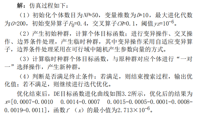

四、解题过程及运行结果
1 解题过程
2 运行结果
