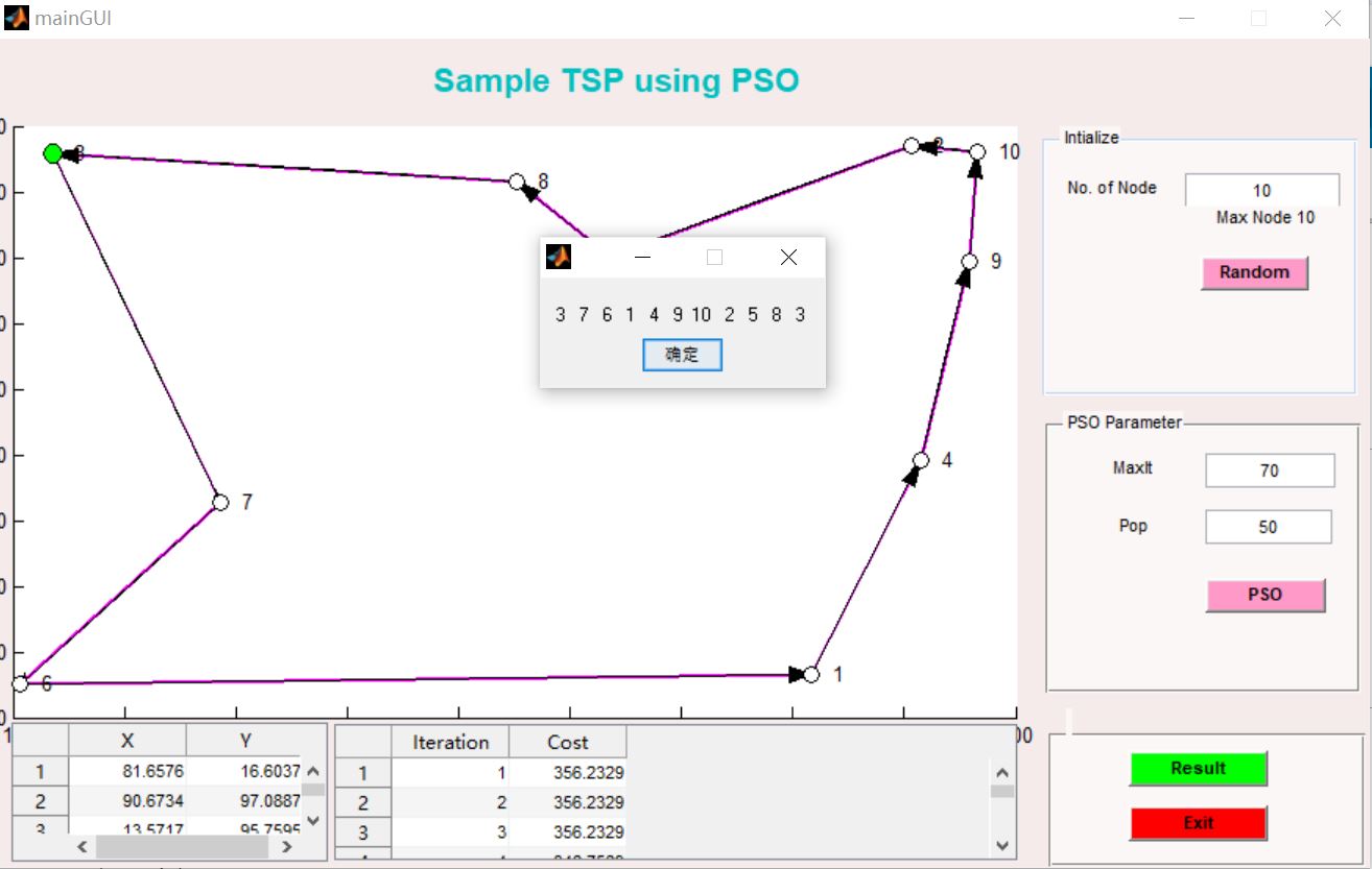

粒子群算法的运算流程如图6.1所示。

function varargout = mainGUI(varargin)
% MAINGUI MATLAB code for mainGUI.fig
%      MAINGUI, by itself, creates a new MAINGUI or raises the existing
%      singleton*.
%      H = MAINGUI returns the handle to a new MAINGUI or the handle to
%      the existing singleton*.
%      MAINGUI('CALLBACK',hObject,eventData,handles,...) calls the local
%      function named CALLBACK in MAINGUI.M with the given input arguments.
%      MAINGUI('Property','Value',...) creates a new MAINGUI or raises the
%      existing singleton*.  Starting from the left, property value pairs are
%      applied to the GUI before mainGUI_OpeningFcn gets called.  An
%      unrecognized property name or invalid value makes property application
%      stop.  All inputs are passed to mainGUI_OpeningFcn via varargin.
%      *See GUI Options on GUIDE's Tools menu.  Choose "GUI allows only one
%      instance to run (singleton)".
% See also: GUIDE, GUIDATA, GUIHANDLES
% Edit the above text to modify the response to help mainGUI
% Last Modified by GUIDE v2.5 23-Mar-2021 06:22:31
% Begin initialization code - DO NOT EDIT
gui_Singleton = 1;
gui_State = struct('gui_Name',       mfilename, ...
                   'gui_Singleton',  gui_Singleton, ...
                   'gui_OpeningFcn', @mainGUI_OpeningFcn, ...
                   'gui_OutputFcn',  @mainGUI_OutputFcn, ...
                   'gui_LayoutFcn',  [] , ...
                   'gui_Callback',   []);
if nargin && ischar(varargin{1})
    gui_State.gui_Callback = str2func(varargin{1});
end
if nargout
    [varargout{1:nargout}] = gui_mainfcn(gui_State, varargin{:});
else
end
% End initialization code - DO NOT EDIT

%% TSP Using PSO
global matriz N BestSol path X Y G1
x2 = get(handles.edit2,'String'); %edit1 being Tag of ur edit box
x3 = get(handles.edit3,'String'); %edit1 being Tag of ur edit box
var1=N;
Range=[0 100];
MaxIt=str2double(x2);
nPop=str2double(x3);
cla;
set(handles.axes1,'visible', 'on');
[BestSol,BestCost]=pso(var1,Range,MaxIt,nPop);
set(handles.axes1,'visible', 'off');
m =(BestSol.Position);
[val,ind]=sort(m);
 path=[ind ind(1)];
 pathcost=0;
 for ik=1:numel(path)-1
    pathcost=pathcost+matriz(path(ik),path(ik+1));
 end
%set(handles.listbox1,'string',[cellstr(num2str([1:N]')) cellstr(num2str(X')) cellstr(num2str(Y'))]);
xs1=1:numel(BestCost);
set(handles.uitable2,'data',[xs1;BestCost']','ColumnName',{'Iteration','Cost'});
cla;
% path=Pathb1;
  %figure(10),
% path=P;
% figure(10),
% clf;
for p =1:(size(path,2))-1
line([X(path(p)) X(path(p+1))], [Y(path(p)) Y(path(p+1))], 'Color','m','LineWidth',2, 'LineStyle','-')
arrow([X(path(p)) Y(path(p)) ], [X(path(p+1)) Y(path(p+1)) ])
end
