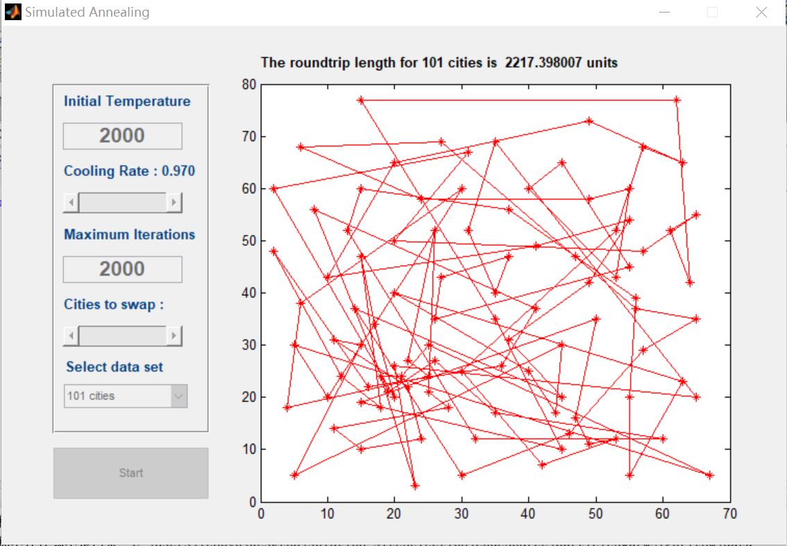

模拟退火算法流程如图7.1所示。

三、部分源代码
function varargout = stsp_v61(varargin)

function start_button_Callback(hObject, eventdata, handles)
% hObject    handle to start_button (see GCBO)
% eventdata  reserved - to be defined in a future version of MATLAB
% handles    structure with handles and user data (see GUIDATA)
selection = get(handles.select_data_set, 'Value');
switch selection
    case 2
        data_file;
    case 3
        loadbays29;
    case 4
        loadatt48;
    case 5
        loadst70;
    case 6
        loadpr76;
    case 7
        loadgr96;
    case 8
        loadeil101;
    case 9
        loadpcb442;
    case 10
        loadeil535;
end
if selection ~= 1
    set(handles.initial_temperature, 'Enable', 'Off')
    set(handles.cooling_rate, 'Enable', 'Off')
    set(handles.maximum_iterations, 'Enable', 'Off')
    set(handles.cities_to_swap, 'Enable', 'Off')
    set(handles.start_button, 'Enable', 'Off')
    set(handles.select_data_set, 'Enable', 'Off')
    cities = load ('cities.mat');
    cities = cities.cities;
    simulatedannealing(cities,...
        str2double(get(handles.initial_temperature,'String')),...
        get(handles.cooling_rate,'Value'),...
        str2double(get(handles.maximum_iterations,'String')),...
        get(handles.cities_to_swap,'Value'));
    set(handles.initial_temperature, 'Enable', 'On')
    set(handles.cooling_rate, 'Enable', 'On')
    set(handles.maximum_iterations, 'Enable', 'On')
    set(handles.cities_to_swap, 'Enable', 'On')
    set(handles.start_button, 'Enable', 'On')
    set(handles.select_data_set, 'Enable', 'On')
end
