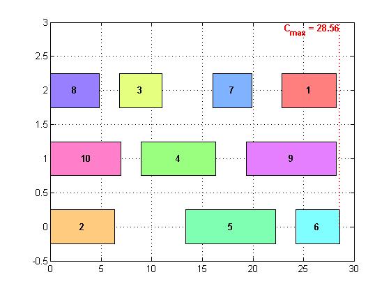

    figure(1);
    PlotSolution(BestSol.Sol,model);
    pause(0.01);

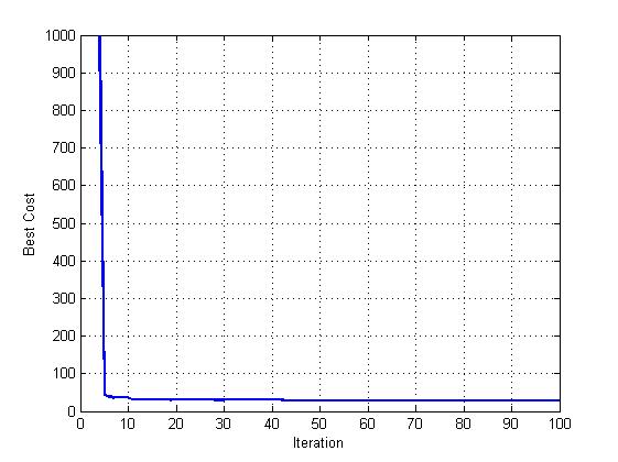

%% Results
figure;
plot(BestCost,'LineWidth',2);
xlabel('Iteration');
ylabel('Best Cost');
grid on;

四、运行结果
