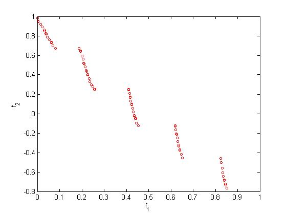

%% This demo shows how the multiobjective firefly algorithm (MOFA) works %
function mofa_new(inp)
if nargin<1,
inp=[100 1000]; % Default parameters
end
n=inp(1); % Population size (number of fireflies)
tMax=inp(2); % Maximum number of iterations
alpha=1.0; % Randomness strength 0--1 (highly random)
beta0=1.0; % Attractiveness constant
gamma=0.1; % Absorption coefficient
theta=10^(-4/tMax); % The parameter theta can be taken as 0.97 to 0.99
% This is a randomness reduction factor for alpha
% For the ZDT Function #3 with m=2 objectives
m=2; % Number of objectives
RnD=zeros(n,2); % Initilize the rank and distance matrix
% Dimension of the search/independent variables
d=30;
Lb=0*ones(1,d); % Lower bounds/limits
Ub=1*ones(1,d); % Upper bounds/limits
% Generating the initial locations of n fireflies
for i=1:n,
Sol(i,:)=Lb+(Ub-Lb).*rand(1,d);
f(i,1:m) = obj_funs(Sol(i,:), m);
end
% Store the fitness or objective values
f_new=f;
%% Sort the initialized population
x=[Sol f]; % combined into a single input
% Non-dominated sorting for the initila population
Sorted=solutions_sorting(x, m,d);
% Decompose into solutions, fitness, rank and distances
Sol=Sorted(:,1:d); S_new=Sol; % Record solutions
f=Sorted(:,(d+1):(d+m)); f_new=f; % Record objectives
RnD=Sorted(:,(d+m+1):end); % Record ranks
for t=1:tMax, %%%%% start the firely algorithm iterations %%%%%
alpha=alpha*theta; % Reduce alpha by a factor 0<theta<1
scale=abs(Ub-Lb); % Scale of the optimization problem
Sol_old=Sol; % Save the old population
f_old=f; % Save the old population objectives
% Two loops over all the n fireflies
for i=1:n,
for j=i:n,
% Update moves and move to the brighter/more attractive
% That is, all m objectives [i.e., f(,1:m)] should improve.
% For example, for m=2, this means that the logical
% condition (f(j,1)<=f(i,1) & f(j,2) <=f(i,2)) is true.
if (f(j,1:m)<=f(i,1:m)),
r=sqrt(sum((Sol(i,:)-Sol(j,:)).^2));
beta=beta0*exp(-gamma*r.^2); % Attractiveness
steps=alpha.*(rand(1,d)-0.5).*scale;
% The FA equation for updating position vectors
% That is, to move firefly i torwards firefly j
Sol(i,:)=Sol(i,:)+beta*(Sol(j,:)-Sol(i,:))+steps;
Sol(i,:)=simplebounds(Sol(i,:),Lb,Ub);
end
f(i,1:m)=obj_funs(Sol(i,1:d),m);
end % end for j
end % end for i
%% Evalute the fitness/function values of the new population
for j=1:n,
f_new(j, 1:m)=obj_funs(Sol(j,1:d),m);
if (f_new(j,1:m) <= f(j,1:m)), % if all improve
f(j,1:m)=f_new(j,1:m);
end
% Update the current best (stored in the first row)
if (f_new(j,1:m) <= f(1,1:m)),
Sol(1,1:d) = Sol(j,1:d);
f_new(1,:)=f_new(j,:);
end
end % end of for loop j
%% ! It's very important to combine both populations, otherwise,
%% the results may look odd and will be very inefficient. !
%% The combined population consits of both the old and new solutions
%% So the total size of the combined population for sorting is 2*n
X(1:n,:)=[Sol f_new]; % Combine new solutions
X((n+1):(2*n),:)=[Sol_old f_old]; % Combine old solutions
Sorted=solutions_sorting(X, m, d);
%% Select n solutions among a combined population of 2*n solutions
new_Sol=Select_pop(Sorted, m, d, n);
% Decompose into solutions, fitness and ranking
Sol=new_Sol(:,1:d); % Sorted solutions
f=new_Sol(:,(d+1):(d+m)); % Sorted objective values
RnD=new_Sol(:,(d+m+1):end); % Sorted ranks and distances
%% Running display at each 100 iterations
if ~mod(t,100),
disp(strcat('Iterations t=',num2str(t)));
plot(f(:, 1), f(:, 2),'ro','MarkerSize',3);
axis([0 1 -0.8 1]);
xlabel('f_1'); ylabel('f_2');
drawnow;
end

四、运行结果
