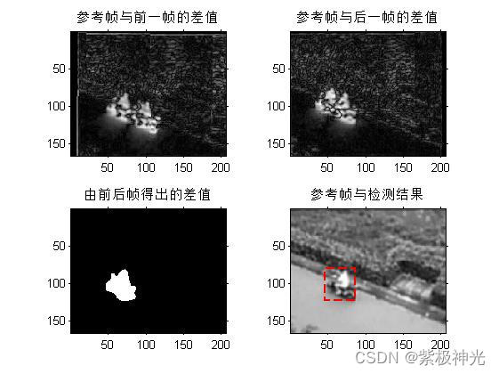

function  MovingTargetDetectionByMMI()
%Moving Target Detection
%Based on Maximun Mutual Information
%读文件
 Im1=imread('001.jpg');
 Im2=imread('002.jpg');
 Im3=imread('003.jpg');
Im1=rgb2gray(Im1);
Im2=rgb2gray(Im2);
Im3=rgb2gray(Im3);
tic;
d12=GetDifferenceImg(Im2,Im1);
d23=GetDifferenceImg(Im2,Im3);
d=d12.*d23;
se =[0     0     0     1     0     0     0
     0     0     1     2     1     0     0
     0     1     2     4     2     1     0
     1     2     4     8     4     2     1
     0     1     2     4     2     1     0
     0     0     1     2     1     0     0
     0     0     0     1     0     0     0];
for i=1:4
d = imfilter(d,se);
end
for i=1:2
d = medfilt2(d,[4 4]);
end
%%d=abs((d12-d23).^0.7);
d=uint8(d/max(max(d))*255);
level = graythresh(d);
BW = im2bw(d,level);
s=regionprops(BW,'BoundingBox');
 figure(1)
 subplot(2,2,1);
 imshow(uint8(d12/max(max(d12))*255));
 title('参考帧与前一帧的差值')
 subplot(2,2,2);
 imshow(uint8(d23/max(max(d23))*255));
 title('参考帧与后一帧的差值')
 subplot(2,2,3);
 imshow(BW);
 title('由前后帧得出的差值')
 subplot(2,2,4);
 imshow(Im2);
 %imshow(d);
 rectangle('Position',s(1).BoundingBox,'Curvature',[0,0],'LineWidth',2,'LineStyle','--','EdgeColor','r')
 title('参考帧与检测结果')
