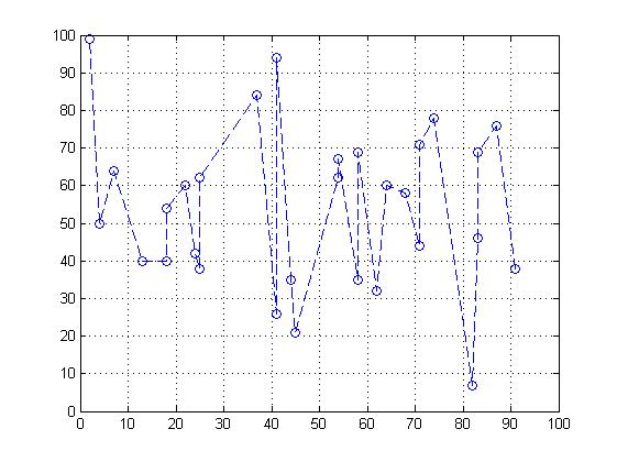

x=[2,4,7,13,18,18,22,24,25,25,37,41,41,44,45,54,54,58,58,62,64,68,71,71,74,82,83,83,87,91];
y=[99,50,64,40,40,54,60,42,38,62,84,26,94,35,21,62,67,35,69,32,60,58,44,71,78,7,46,69,76,38];
n=30;% n表示城市数

figure(1),
plot(x,y,'o--');
grid on

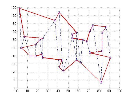

figure(2),
line(x1,y1,'color','r','linewidth',2);
hold on
plot(x,y,'o--');
grid on
[x1',y1']
ltsp0
toc
