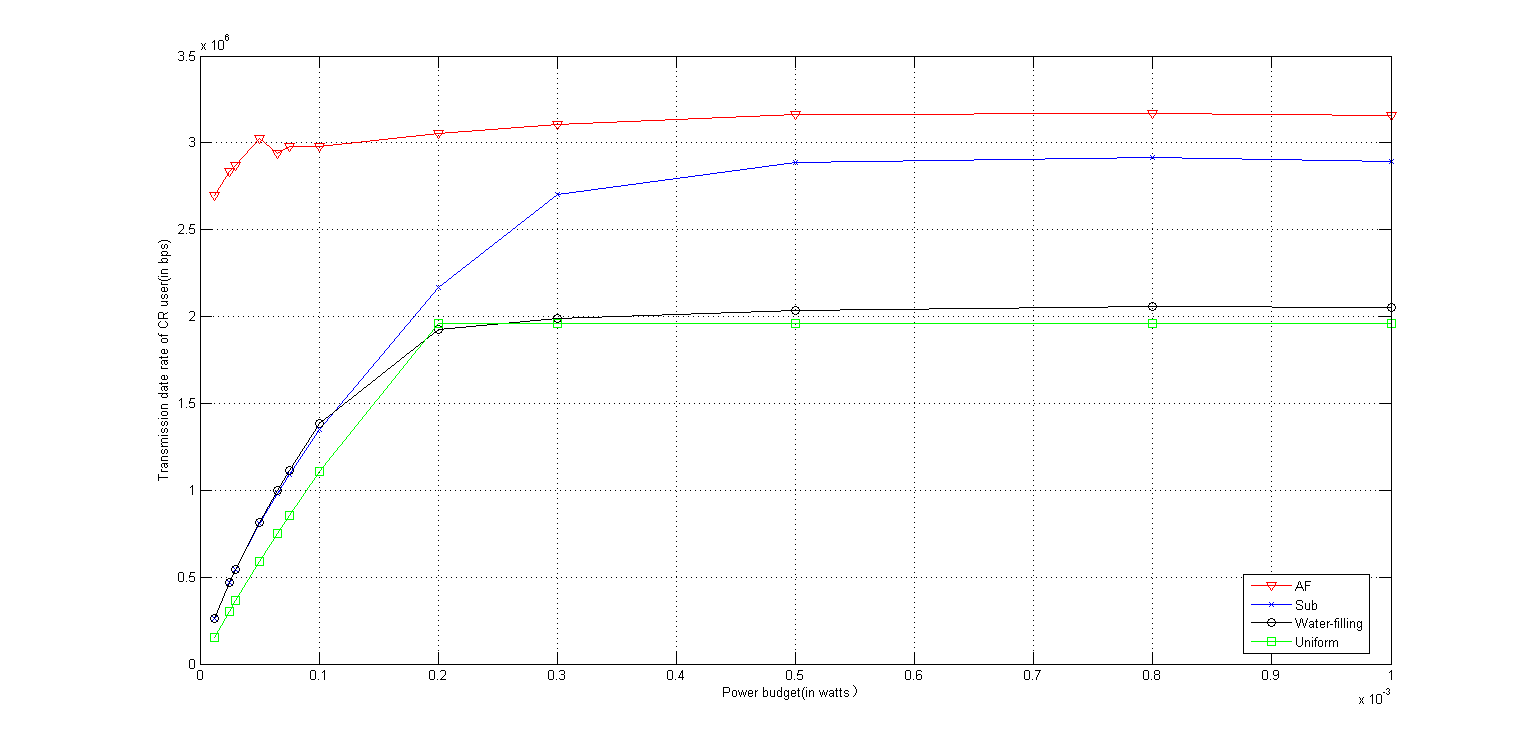

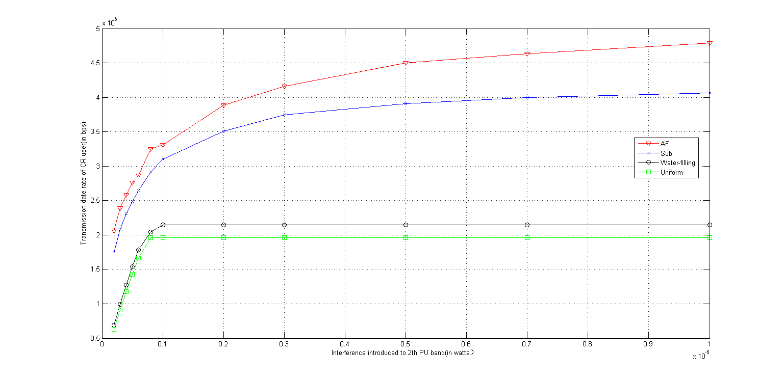

figure(3)
plot(Ith2,C_AF,'-rv',Ith2,C_sub,'-x',Ith2,C_water,'-ko',Ith2,C_uniform,'-gs');
grid on
xlabel('Interference introduced to 2th PU band(in watts)');
ylabel('Transmission date rate of CR user(in bps)');
legend('AF','Sub','Water-filling','Uniform',0);

figure(4)
plot(Pt,C_AF,'-rv',Pt,C_sub,'-x',Pt,C_water,'-ko',Pt,C_uniform,'-gs');
grid on
xlabel('Power budget(in watts)');
