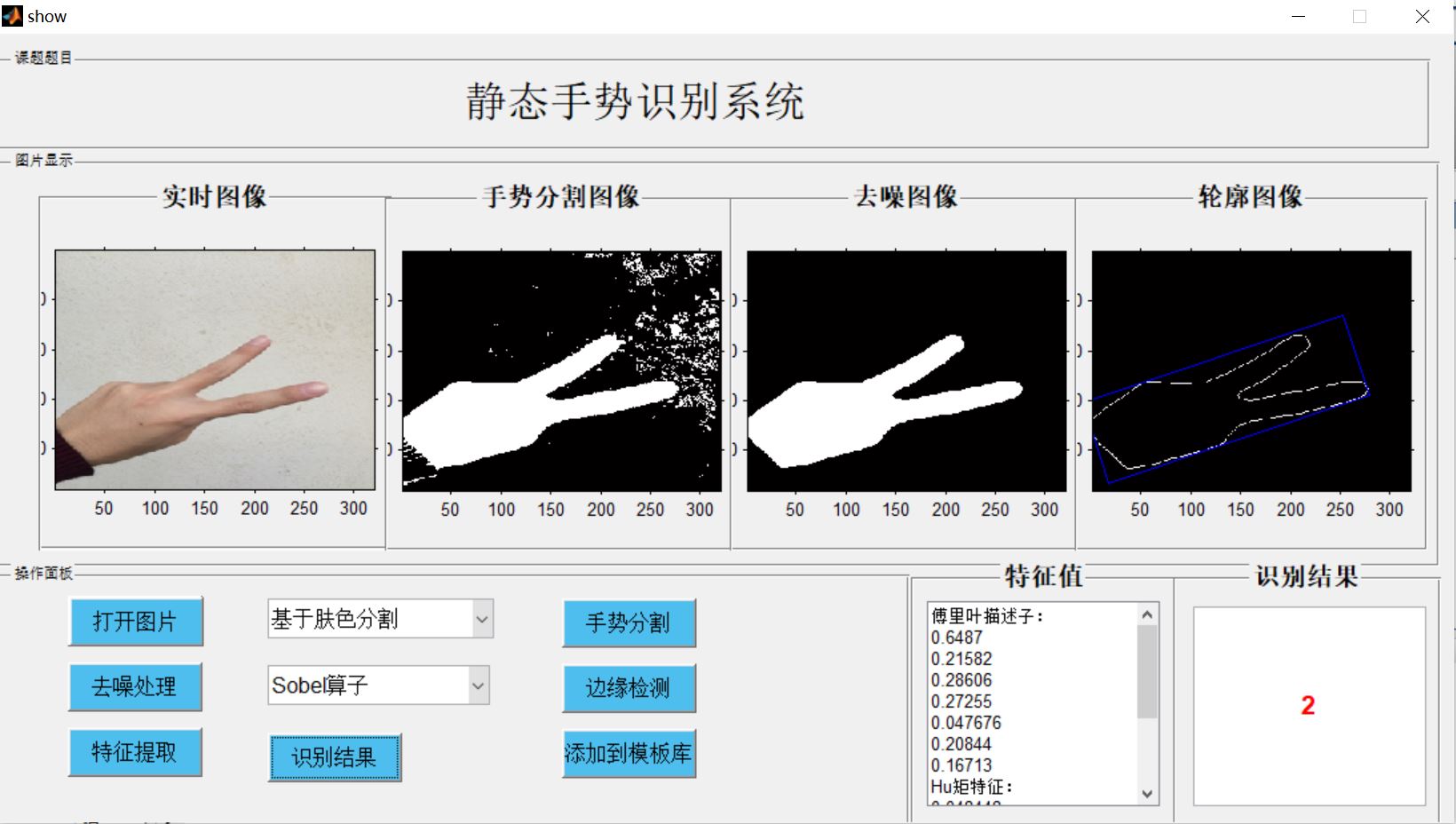

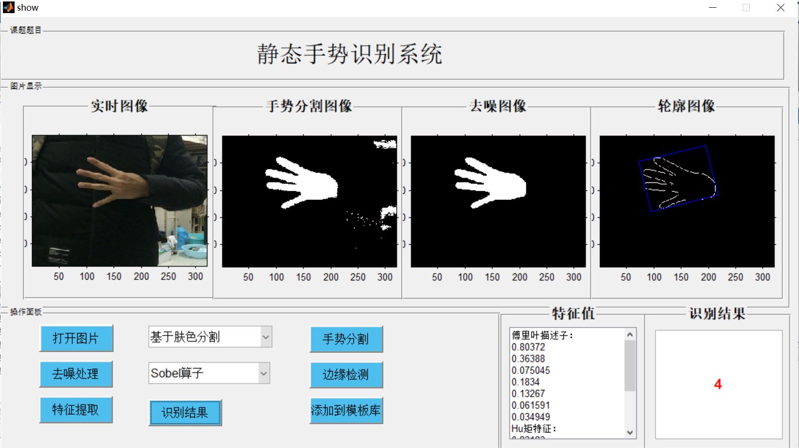

【手势识别】基于matlab GUI肤色手势识别(带面板)【含Matlab源码 1650期】

if l==1 %基于阈值分割(尤其适用于纯背景)
graypic = rgb2gray(pic); %灰度图像
% graypic = localenhance(graypic); %局部增强
% figure,imshow(graypic);
pic_filt=medfilt2(graypic,[3 3]); %3*3中值滤波
axes(handles.axes3);imshow(pic_filt);
pause(1);%延迟1s
pic_cut = threshold_cut(pic_filt);
end
if l==2 %基于YCgCr肤色分割(适用于较复杂背景)
pic_cut = colour_cut(pic);
end
imshow(pic_cut);
setappdata(gcf,'pic_cut',pic_cut);%把catch_pic变成全局变量
