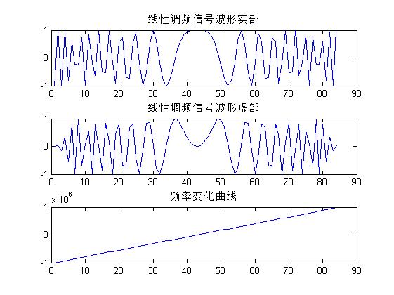

% 产生线性调频信号 %
number=fix(Fs*TimeWidth);%回波的采样点数=脉压系数长21度=暂态点数目+1=83+1
if rem(number,2)~=0 %求整除x/y的余数
number=number+1;
end
for i=-fix(number/2):fix(number/2)-1 %fix函数向零方向取整
Chirp(i+fix(number/2)+1)=exp(j*(pi*(BandWidth/TimeWidth)*(i/Fs)^2));%exp(j*fi)*
BT(i+fix(number/2)+1) = (BandWidth/TimeWidth)*(i/Fs)
end
coeff=conj(fliplr(Chirp));%产生脉压系数
figure(1);
subplot(3,1,1)
plot(real(Chirp));title('线性调频信号波形实部');
subplot(3,1,2)
plot(imag(Chirp));title('线性调频信号波形虚部');
subplot(3,1,3)
plot(BT);title('频率变化曲线');

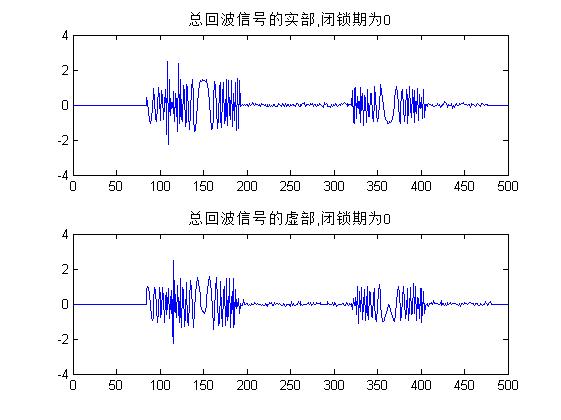

for i=1:PulseNumber %在接收机闭锁期,接收的回波为0
Echo((i-1)*SampleNumber+1:(i-1)*SampleNumber+number)=0;
end

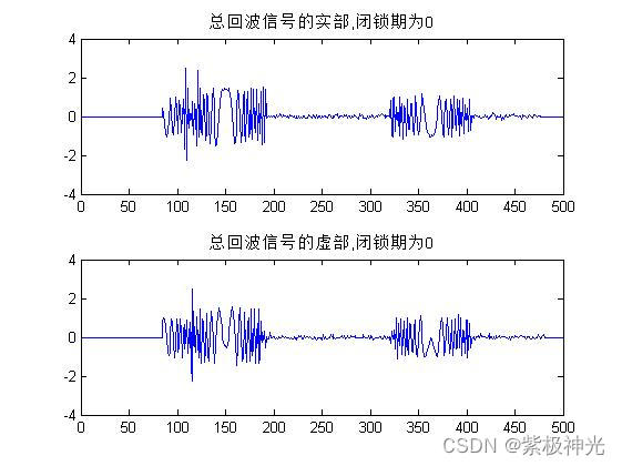

figure(2);
subplot(2,1,1);plot(real(Echo(1:500)));title('总回波信号的实部,闭锁期为0');
subplot(2,1,2);plot(imag(Echo(1:500)));title('总回波信号的虚部,闭锁期为0');

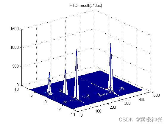

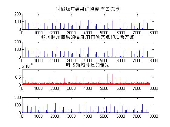

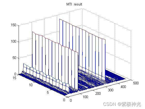

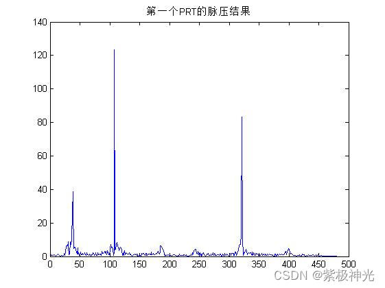

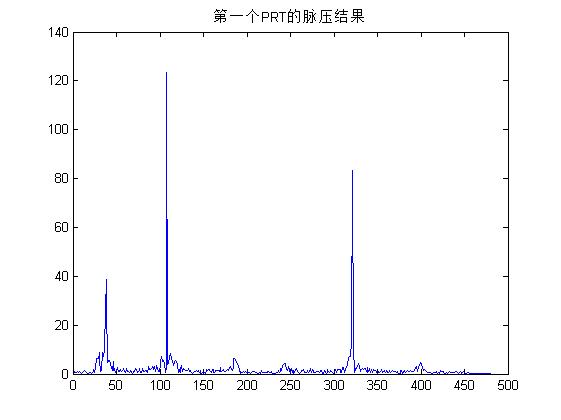

三、运行结果
