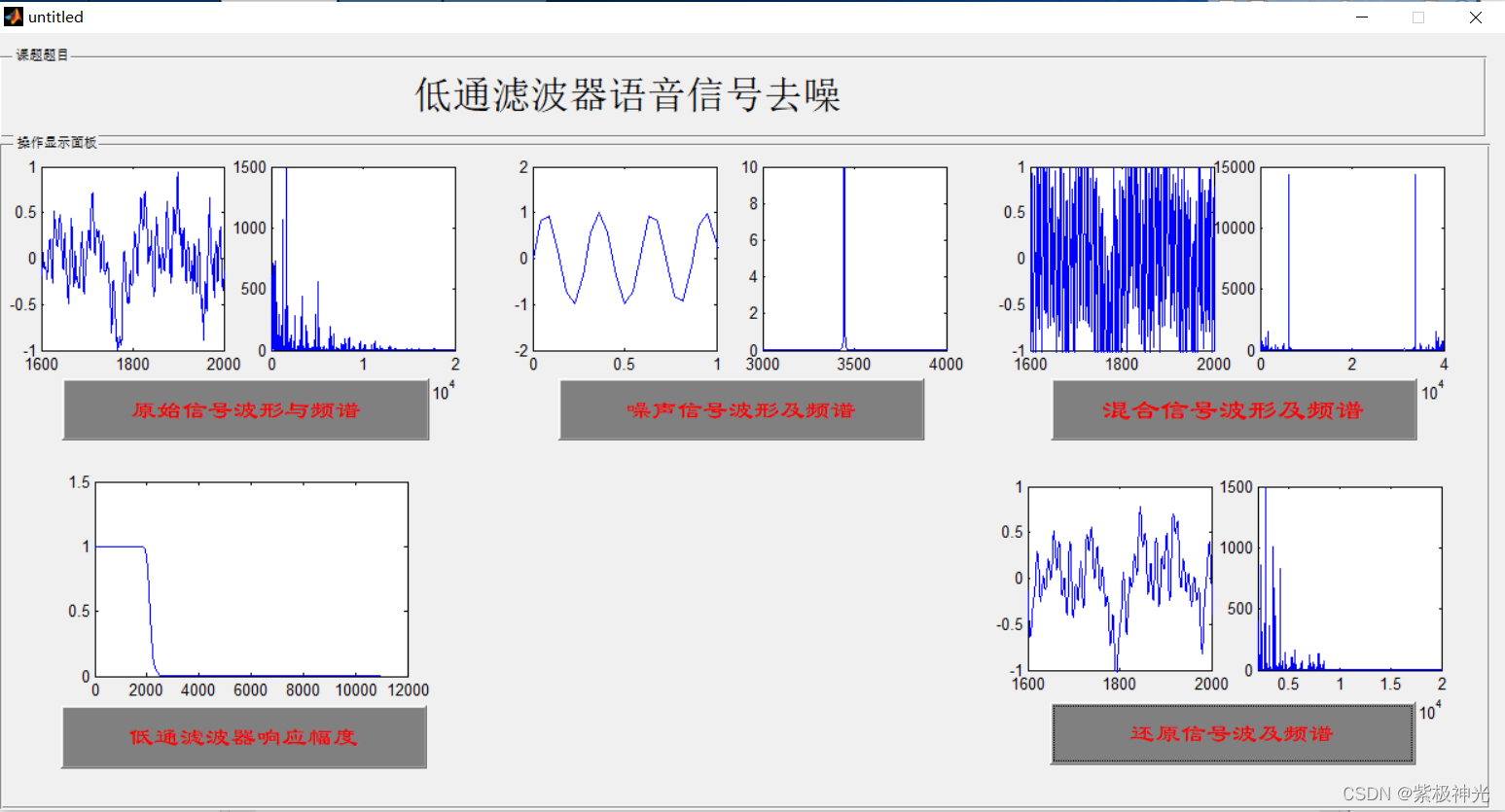

【语音处理】基于matlab GUI低通滤波器语音信号加噪与去噪【含Matlab源码 1708期】

[y,fs,bits]=wavread('6.wav');
y=y(:,1);
N=length(y);
sound(y,fs,bits);
Y=fft(y,40000);%采样点数40000
axes(handles.axes1);
plot(y);
axis([1600 2000 -1 1]);
axes(handles.axes2);
plot(abs(Y));
axis([0 20000 0 1500]);
% --- Executes on button press in pushbutton2.
function pushbutton2_Callback(hObject, eventdata, handles)
% hObject handle to pushbutton2 (see GCBO)
% eventdata reserved - to be defined in a future version of MATLAB
% handles structure with handles and user data (see GUIDATA)
y=y(:,1);
N=length(y);
t=(0:N-1)/fs;
n=0:N-1;
f0=3445;
s=sin(2*pi*f0/fs*n);%噪音信号
sound(s);
axes(handles.axes3);
plot(t,s);
axis([0 0.001 -2 2]);
spinpu=fft(s,N);
Pyy=spinpu.*conj(spinpu)/N;
halflength=floor(N/2);
f=fs*(0:halflength)/N;
axes(handles.axes4);
plot(f,Pyy(1:halflength+1));%噪音信号频谱
axis([3000 4000 0 10]);

三、运行结果
