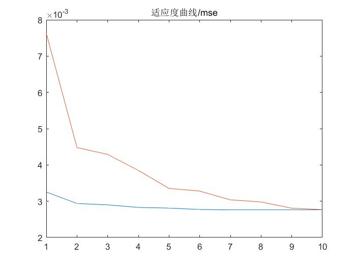

figure;plot(trace);title('适应度曲线/mse')

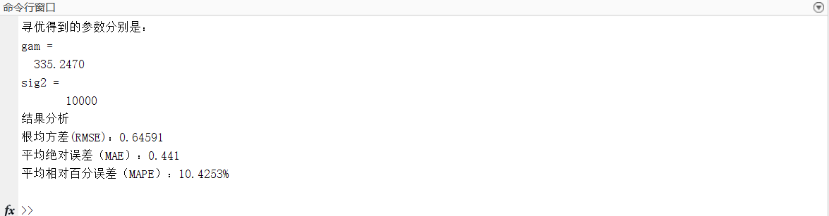

disp('寻优得到的参数分别是:')
gam=x(1)
sig2=x(2)
model=initlssvm(train_x,train_y,typeID,gam,sig2,kernelnamescell);
model=trainlssvm(model);
y_pre_test=simlssvm(model,test_x);
% 反归一化
predict_value=mapminmax('reverse',y_pre_test',mappingy);
true_value=mapminmax('reverse',test_y',mappingy);
save ssa_lssvm predict_value true_value
disp('结果分析')
rmse=sqrt(mean((true_value-predict_value).^2));
disp(['根均方差(RMSE):',num2str(rmse)])
mae=mean(abs(true_value-predict_value));
disp(['平均绝对误差(MAE):',num2str(mae)])
mape=mean(abs(true_value-predict_value)/true_value);
disp(['平均相对百分误差(MAPE):',num2str(mape*100),'%'])

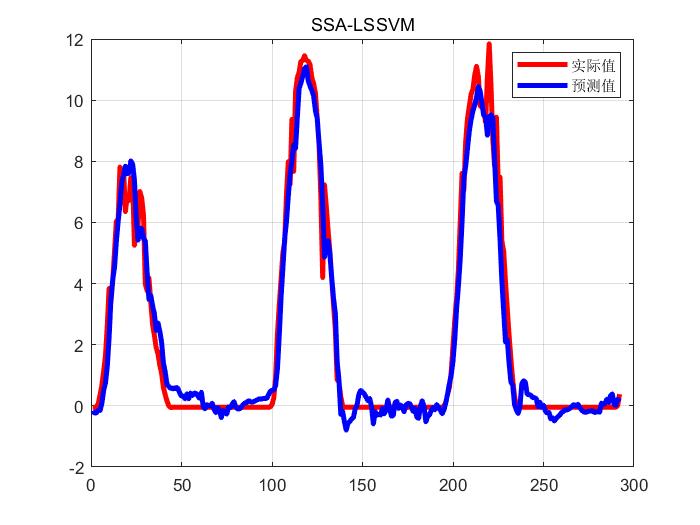

figure
plot(true_value,'r-','linewidth',3)
hold on
plot(predict_value,'b-','linewidth',3)
legend('实际值','预测值')
grid on
title('SSA-LSSVM')
