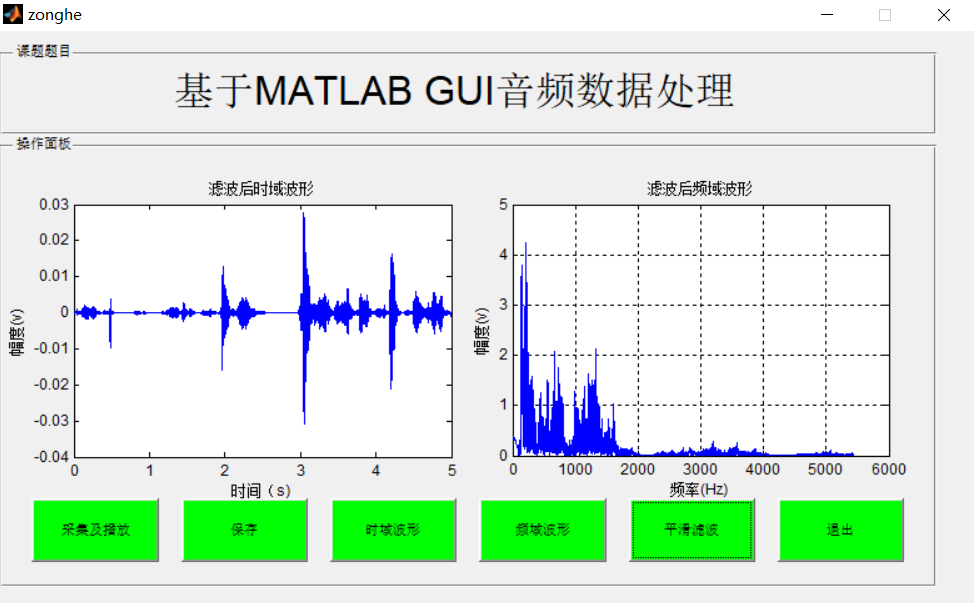

function varargout = zonghe(varargin)
% ZONGHE MATLAB code for zonghe.fig
%      ZONGHE, by itself, creates a new ZONGHE or raises the existing
%      singleton*.
%      H = ZONGHE returns the handle to a new ZONGHE or the handle to
%      the existing singleton*.
%      ZONGHE('CALLBACK',hObject,eventData,handles,...) calls the local
%      function named CALLBACK in ZONGHE.M with the given input arguments.
%      ZONGHE('Property','Value',...) creates a new ZONGHE or raises the
%      existing singleton*.  Starting from the left, property value pairs are
%      applied to the GUI before zonghe_OpeningFcn gets called.  An
%      unrecognized property name or invalid value makes property application
%      stop.  All inputs are passed to zonghe_OpeningFcn via varargin.
%      *See GUI Options on GUIDE's Tools menu.  Choose "GUI allows only one
%      instance to run (singleton)".
% See also: GUIDE, GUIDATA, GUIHANDLES
% Edit the above text to modify the response to help zonghe
% Last Modified by GUIDE v2.5 23-Jan-2022 22:45:18
% Begin initialization code - DO NOT EDIT
gui_Singleton = 1;
gui_State = struct('gui_Name',       mfilename, ...
                   'gui_Singleton',  gui_Singleton, ...
                   'gui_OpeningFcn', @zonghe_OpeningFcn, ...
                   'gui_OutputFcn',  @zonghe_OutputFcn, ...
                   'gui_LayoutFcn',  [] , ...
                   'gui_Callback',   []);
if nargin && ischar(varargin{1})
    gui_State.gui_Callback = str2func(varargin{1});
end
if nargout
    [varargout{1:nargout}] = gui_mainfcn(gui_State, varargin{:});
else
end
% End initialization code - DO NOT EDIT
% --- Executes just before zonghe is made visible.
function zonghe_OpeningFcn(hObject, eventdata, handles, varargin)
% This function has no output args, see OutputFcn.
% hObject    handle to figure
% eventdata  reserved - to be defined in a future version of MATLAB
% handles    structure with handles and user data (see GUIDATA)
% varargin   command line arguments to zonghe (see VARARGIN)
% Choose default command line output for zonghe
handles.output = hObject;
% Update handles structure
guidata(hObject, handles);
% UIWAIT makes zonghe wait for user response (see UIRESUME)
% uiwait(handles.figure1);
% --- Outputs from this function are returned to the command line.
function varargout = zonghe_OutputFcn(hObject, eventdata, handles)
% varargout  cell array for returning output args (see VARARGOUT);
% Get default command line output from handles structure
varargout{1} = handles.output;
% --- Executes on button press in pushbutton1.
function pushbutton1_Callback(hObject, eventdata, handles)
global aud RecordLength ShowLength FrequencyWindow1 FrequencyWindow2 fs nBits
global mag idx_last recObj myRecording bit%全局变量
aud=audiodevinfo;   %声音设备
%初始化
RecordLength=5;    %录音时间为5秒
ShowLength=5;      %显示的时间长度也为5秒
FrequencyWindow1=0;%最小分辨率
FrequencyWindow2=3000;%最大分辨率
fs=44100;%采样频率
nBits=16;%录音设备字节数设置
mag=1.05;%显示图像为最大值的1.05倍
idx_last=1;%时间调节
recObj=audiorecorder(fs,nBits,1);%录音设备
record(recObj,RecordLength);%录音
tic
while toc<.1
end
bit=2;
%主循环
while toc<RecordLength
    myRecording=getaudiodata(recObj);%获取录音数据
    idx=round(toc*fs);%执行时间计算
    while idx-idx_last<.1*fs
        idx=round(toc*fs);
    end
    axes(handles.axes1);
    plot((max(1,size(myRecording,1)-fs*ShowLength):(2^bit):size(myRecording,1))./fs,myRecording(max(1,size(myRecording,1)-fs*ShowLength):(2^bit):end)) %画图
    mag=max(abs(myRecording));%语音数据最大值
    %设定显示范围
    ylim([-1.2 1.2]*mag)
    xlim([max(0,size(myRecording,1)/fs-ShowLength) max(size(myRecording,1)/fs,ShowLength)])
    title('声音信号的波形显示');
    ylabel('Signal level(v)');
    xlabel('Sample');
    drawnow
    idx_last=idx;
end
% hObject    handle to pushbutton1 (see GCBO)
% --- Executes on button press in pushbutton2.
function pushbutton2_Callback(hObject, eventdata, handles)
save yinpin.mat aud RecordLength ShowLength FrequencyWindow1 FrequencyWindow2 fs nBits mag idx_last recObj myRecording
load yinpin.mat  %加载数据
sound(myRecording,fs);%重放
% hObject    handle to pushbutton2 (see GCBO)
% --- Executes on button press in pushbutton3.
function pushbutton3_Callback(hObject, eventdata, handles)
global y2 t fs myRecording ShowLength bit
y2=myRecording(max(1,size(myRecording,1)-fs*ShowLength):(2^bit):end);
n=length(y2);
dt=5/n;
t=0:dt:5-dt;
% subplot(3,2,2)
plot(t,y2);
title('时域波形');
ylabel('幅度(v)');
xlabel('时间(s)');
% hObject    handle to pushbutton3 (see GCBO)
clear;
figure(5);
Ft=44100;%采样频率
Fp=2500;%阻带数字截止频率
Fs=5000;%通带数字截止频率
wp=2*pi*Fp/Ft;%频率归一化
ws=2*pi*Fs/Ft;
wp1=2*tan(wp/2);%转换为模拟指标
ws1=2*tan(ws/2);
[N,wn]=buttord(wp1,ws1,1,100,'s');%计算滤波器阶数以及3dB截止频率
[b,a]=butter(N,wn,'s');%计算H(s)的分子与分母系数
[bz,az]=bilinear(b,a,Ft);
freqz(bz,az,512,Ft);
%plot(f,20*log10(abs(h)));
%plot(f,abs(h));
%xlabel('频率(Hz)');
%ylabel('幅度(dB)')
title('低通滤波器');
grid on;

三、运行结果
