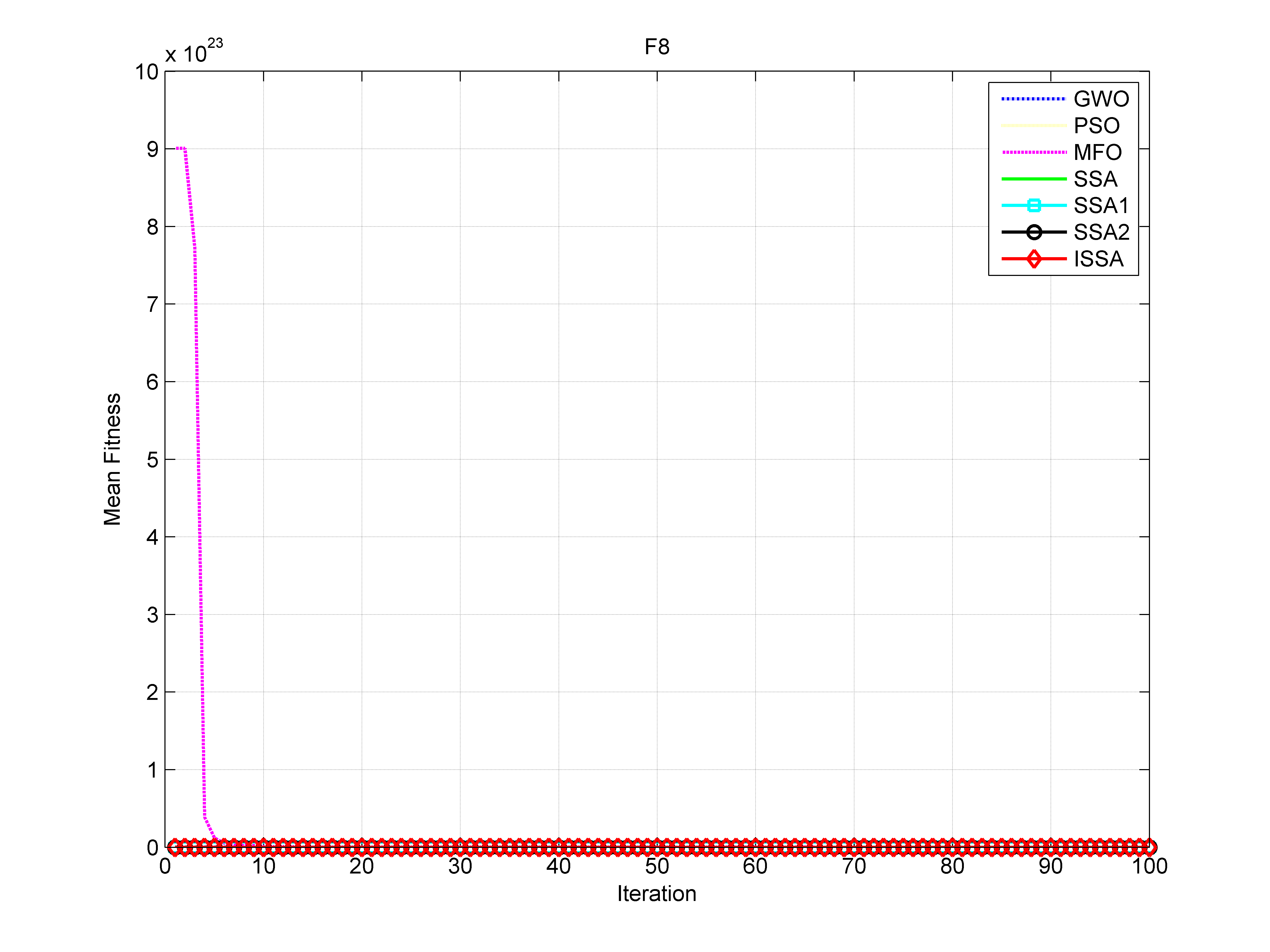

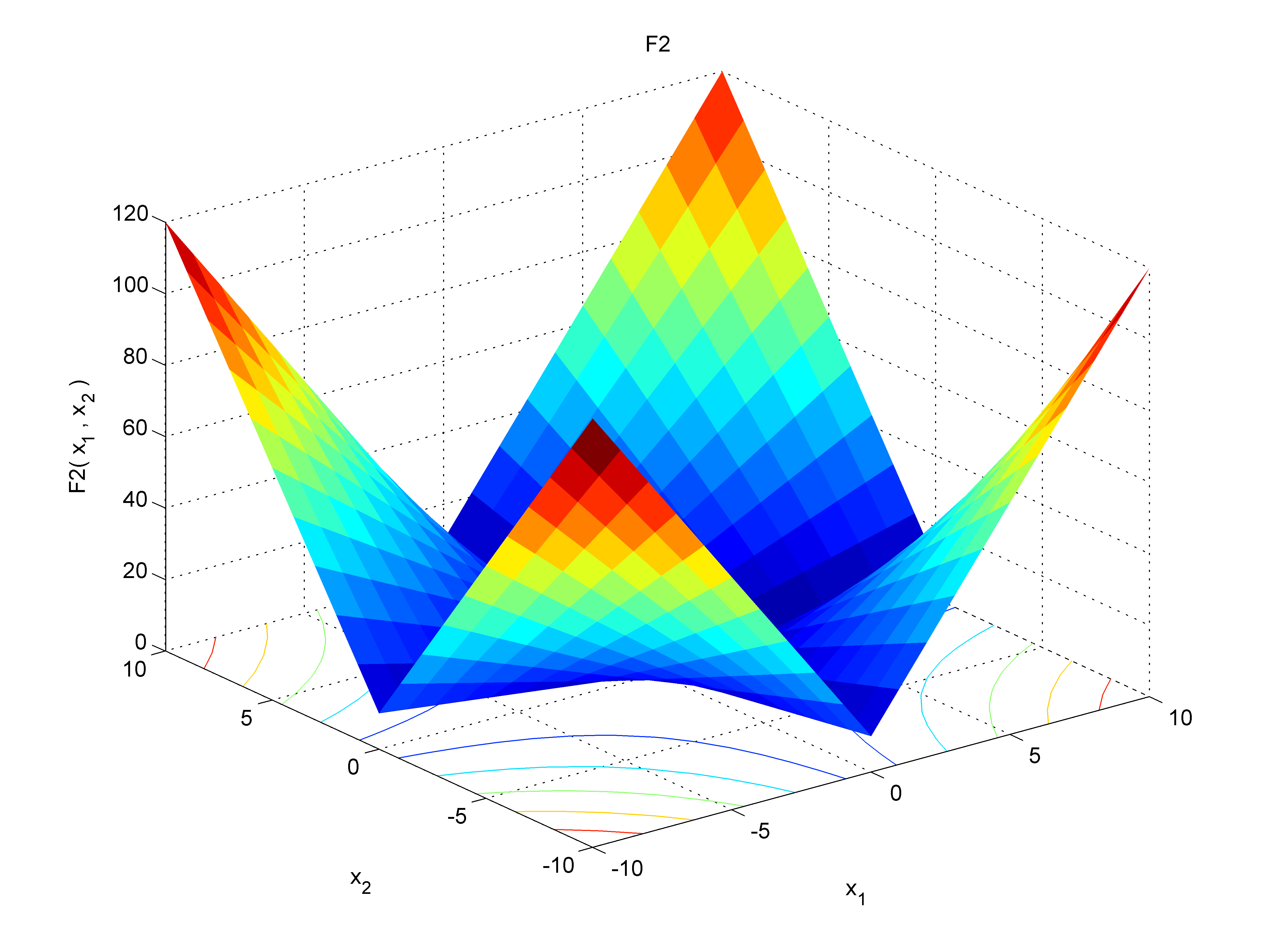

%% 清除环境变量
clear
clc
%% 参数设置
N = 30;             % 种群规模
Function_name = 'F2';         % 从F1到F23的测试函数的名称(本文中的表123)
Max_iteration = 100;           % 最大迭代次数
cnt_max = 30;
% 加载所选基准函数的详细信息
[lb, ub, dim, fobj] = Get_Functions_details(Function_name);
Curve_GWO = zeros(1, Max_iteration);
Curve_PSO = zeros(1, Max_iteration);
Curve_MFO = zeros(1, Max_iteration);
Curve_SSA = zeros(1, Max_iteration);
Curve_SSA1 = zeros(1, Max_iteration);
Curve_SSA2 = zeros(1, Max_iteration);
Curve_ISSA = zeros(1, Max_iteration);
for cnt = 1:cnt_max
    disp(['第', num2str(cnt), '次迭代']);
    % 初始化种群位置
    X = initialization(N, dim, ub, lb);
    [GWO_Best_score(cnt), GWO_Best_pos(cnt, :), GWO_Curve] = GWO(X, N, Max_iteration, lb, ub, dim, fobj);
    [PSO_Best_score(cnt), PSO_Best_pos(cnt, :), PSO_Curve] = PSO(X, N, Max_iteration, lb, ub, dim, fobj);
    [MFO_Best_score(cnt), MFO_Best_pos(cnt, :), MFO_Curve] = MFO(X, N, Max_iteration, lb, ub, dim, fobj);
    [SSA_Best_score(cnt), SSA_Best_pos(cnt, :), SSA_Curve] = SSA(X, N, Max_iteration, lb, ub, dim, fobj);
    [SSA1_Best_score(cnt), SSA1_Best_pos(cnt, :), SSA1_Curve] = SSA1(X, N, Max_iteration, lb, ub, dim, fobj);
    [SSA2_Best_score(cnt), SSA2_Best_pos(cnt, :), SSA2_Curve] = SSA2(X, N, Max_iteration, lb, ub, dim, fobj);
    [ISSA_Best_score(cnt), ISSA_Best_pos(cnt, :), ISSA_Curve] = ISSA(X, N, Max_iteration, lb, ub, dim, fobj);
    Curve_GWO = Curve_GWO+GWO_Curve;
    Curve_PSO = Curve_PSO+PSO_Curve;
    Curve_MFO = Curve_MFO+MFO_Curve;
    Curve_SSA = Curve_SSA+SSA_Curve;
    Curve_SSA1 = Curve_SSA1+SSA1_Curve;
    Curve_SSA2 = Curve_SSA2+SSA2_Curve;
    Curve_ISSA = Curve_ISSA+ISSA_Curve;
end
Curve_GWO = Curve_GWO/cnt_max;
Curve_PSO = Curve_PSO/cnt_max;
Curve_MFO = Curve_MFO/cnt_max;
Curve_SSA = Curve_SSA/cnt_max;
Curve_SSA1 = Curve_SSA1/cnt_max;
Curve_SSA2 = Curve_SSA2/cnt_max;
Curve_ISSA = Curve_ISSA/cnt_max;
std_GWO = std(GWO_Best_score);
std_PSO = std(PSO_Best_score);
std_MFO = std(MFO_Best_score);
std_SSA = std(SSA_Best_score);
std_SSA1 = std(SSA1_Best_score);
std_SSA2 = std(SSA2_Best_score);
std_ISSA = std(ISSA_Best_score);
best_GWO = max(GWO_Best_score);
best_PSO = max(PSO_Best_score);
best_MFO = max(MFO_Best_score);
best_SSA = max(SSA_Best_score);
best_SSA1 = max(SSA1_Best_score);
best_SSA2 = max(SSA2_Best_score);
best_ISSA = max(ISSA_Best_score);
worst_GWO = min(GWO_Best_score);
worst_PSO = min(PSO_Best_score);
worst_MFO = min(MFO_Best_score);
worst_SSA = min(SSA_Best_score);
worst_SSA1 = min(SSA1_Best_score);
worst_SSA2 = min(SSA2_Best_score);
worst_ISSA = min(ISSA_Best_score);
mean_GWO = mean(GWO_Best_score);
mean_PSO = mean(PSO_Best_score);
mean_MFO = mean(MFO_Best_score);
mean_SSA = mean(SSA_Best_score);
mean_SSA1 = mean(SSA1_Best_score);
mean_SSA2 = mean(SSA2_Best_score);
mean_ISSA = mean(ISSA_Best_score);
