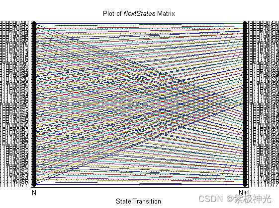

commcnv_plotnextstates(trellis.nextStates);%卷积码网格表可视化

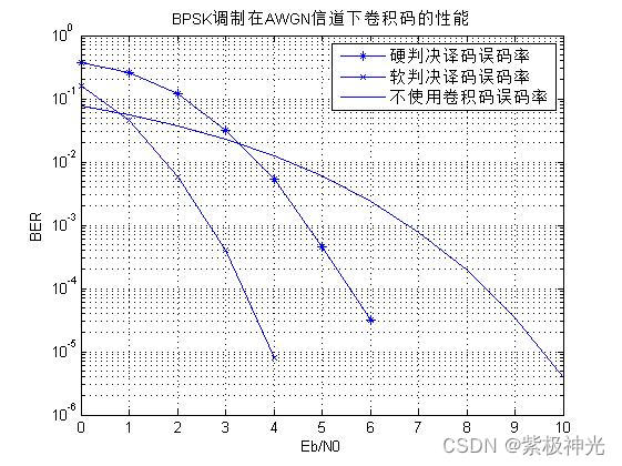

    hard=vitdec(data_out,trellis,tblen,'cont','hard');             %硬判决,硬判决使用的汉明距离丢失了更多信息
    soft=vitdec(real(rx),trellis,tblen,'cont','unquant');          %软判决,使用几何距离

errbN=berawgn(EbN0,'psk',2,'nodiff');                              %不使用卷积码的2PSK误码率
figure()
semilogy(EbN0,errbH,'-*');hold on;
semilogy(EbN0,errbS,'-x');hold on;
semilogy(EbN0,errbN,'-');
legend('硬判决译码误码率','软判决译码误码率','不使用卷积码误码率');
title('BPSK调制在AWGN信道下卷积码的性能');
grid on
xlabel('Eb/N0');ylabel('BER');
function commcnv_plotnextstates(nextStates)
% Utility function to display nextStates matrix for Convolutional Encoder
% with Uncoded Bits and Feedback example. To open the model, type
% commcnvencoder.
%   Copyright 2003-2011 The MathWorks, Inc.
%   $Revision: 1.1.6.2 $  $Date: 2011/12/11 07:38:29 $
%-- Create a new figure to plot NextStates
figure;
%-- Declare and initialize intermediate variables
[numStates,numIn] = size(nextStates);
yplot = NaN*ones(3*numIn,numStates);
yplot([1:3:end],:) = ones(numIn,1)*[0:numStates-1];
yplot([2:3:end],:) = nextStates';
xplot = repmat([1 numStates NaN]',numIn,numStates);
%-- Plot NextStates matrix
plot(xplot,yplot,'o-','MarkerSize',6,'MarkerEdgeColor','k','MarkerFaceColor','k');
grid on;
title('Plot of {\itNextStates} Matrix');
xlabel('State Transition');
set(gca,'yTick',[0:numStates-1],'YDir','Reverse',...
    'YTickLabel',...
[dec2base([0:numStates-1],2) repmat('/',numStates,1) dec2base([0:numStates-1],8)], ...
    'YLim', [-1 numStates], 'Xlim',[0 numStates+1],'xTick',[1 numStates], ...
    'xTickLabel','N|N+1','Position',[.11 .1 .78 .8]);
ylabel('Initial State (Binary/Octal representation)',...
    'HorizontalAlignment','center','VerticalAlignment','Bottom');
