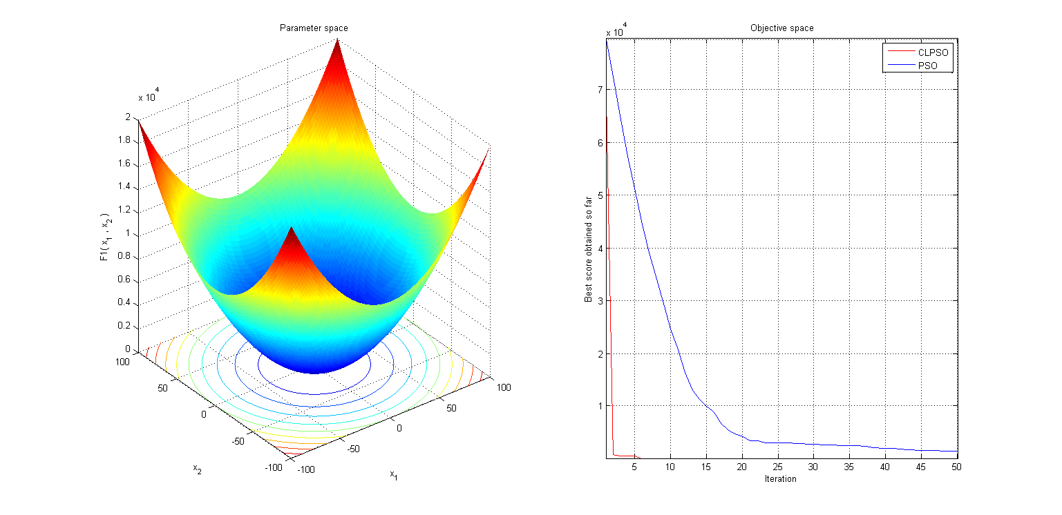

clear all
clc
SearchAgents_no=30; % Number of search agents 种群数量
Function_name='F1'; % Name of the test function that can be from F1 to F23 (Table 1,2,3 in the paper) 设定适应度函数
Max_iteration=2000; % Maximum numbef of iterations 设定最大迭代次数
% Load details of the selected benchmark function
[lb,ub,dim,fobj]=Get_Functions_details(Function_name);  %设定边界以及优化函数
%速度范围设定
Vmax = 2;
Vmin = -2;
%原始粒子群结果
[Best_pos,Best_score,PSO_curve]=PSO(SearchAgents_no,Max_iteration,lb,ub,dim,fobj,Vmax,Vmin); %开始优化
%改进粒子群结果
[Best_pos1,Best_score1,CLPSO_curve1]=CLPSO(SearchAgents_no,Max_iteration,lb,ub,dim,fobj,Vmax,Vmin); %开始优化
figure('Position',[269   240   660   290])
%Draw search space
subplot(1,2,1);
func_plot(Function_name);
title('Parameter space')
xlabel('x_1');
ylabel('x_2');
zlabel([Function_name,'( x_1 , x_2 )'])
%Draw objective space
subplot(1,2,2);
semilogy(PSO_curve,'Color','b','linewidth',1.5)
hold on
semilogy(CLPSO_curve1,'Color','r','linewidth',1.5);
title('Objective space')
xlabel('Iteration');
ylabel('Best score obtained so far');
legend('PSO','CLPSO');
axis tight
grid on

四、运行结果
