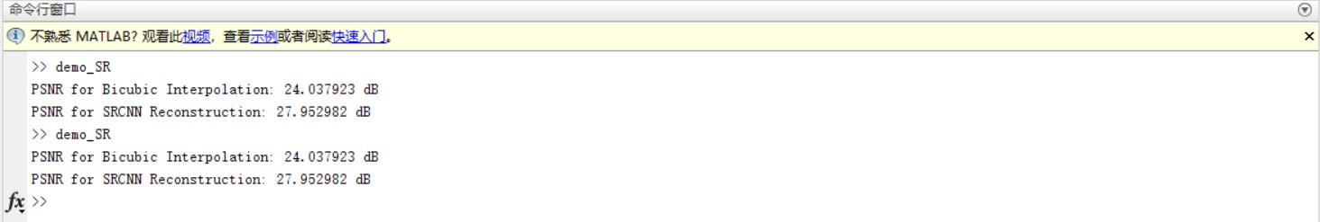

psnr_bic = compute_psnr(im_gnd,im_b);
psnr_srcnn = compute_psnr(im_gnd,im_h);

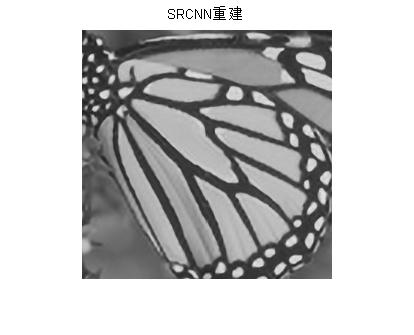

%% show results
fprintf('PSNR for Bicubic Interpolation: %f dB\n', psnr_bic);
fprintf('PSNR for SRCNN Reconstruction: %f dB\n', psnr_srcnn);
figure, imshow(im_b); title('双三次插值');
figure, imshow(im_h); title('SRCNN重建');

三、运行结果
