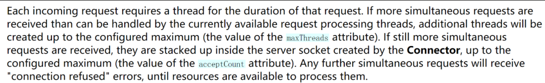

Tomcat官网截图
根据Tomcat官网中的介绍,对于一个浏览器请求,tomcat会指定一个处理线程,或是在线程池中选取空闲的,或者新建一个线程。
Each incoming request requires a thread for the duration of that request. If more simultaneous requests are received than can be handled by the currently available request processing threads, additional threads will be created up to the configured maximum (the value of the maxThreads attribute). If still more simultaneous requests are received, they are stacked up inside the server socket created by the Connector, up to the configured maximum (the value of the acceptCountattribute). Any further simultaneous requests will receive "connection refused" errors, until resources are available to process them.
—— https://tomcat.apache.org/tomcat-7.0-doc/config/http.html
在Tomcat容器中,每个servlet是单例的。在SpringMVC中,Controller 默认也是单例。 采用单例模式的最大好处,就是可以在高并发场景下极大地节省内存资源,提高服务抗压能力。
