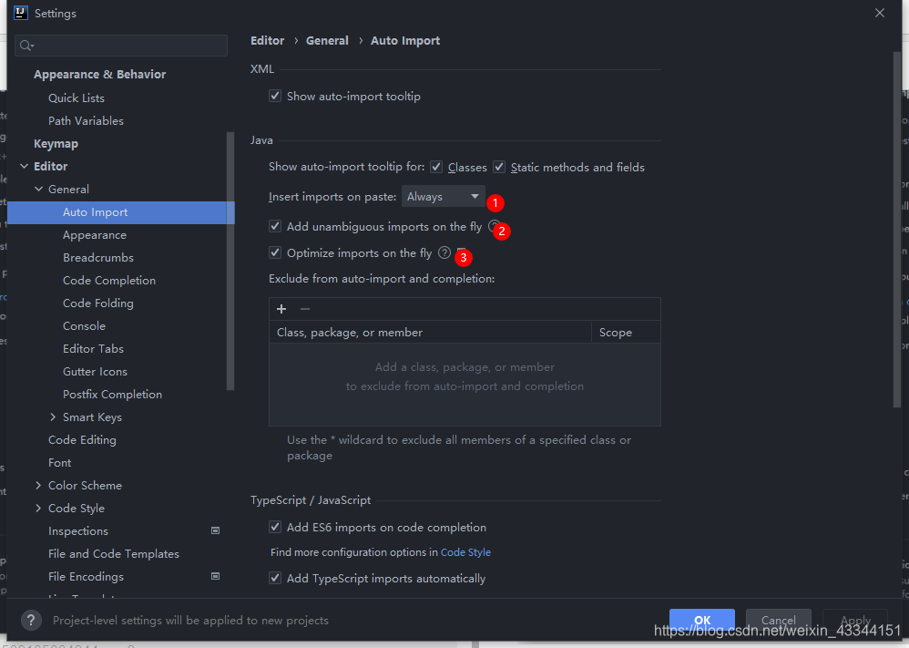

4.优化导包

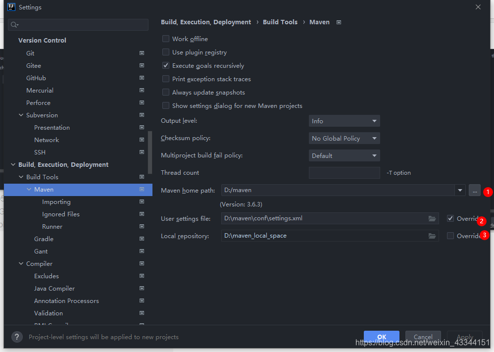

15.maven配置
maven是依赖管理工具包,虽然IDEA自带,这个不好用,我们要自己配置
https://maven.apache.org/download.cgi
下面是我的配置
maven setting.xml

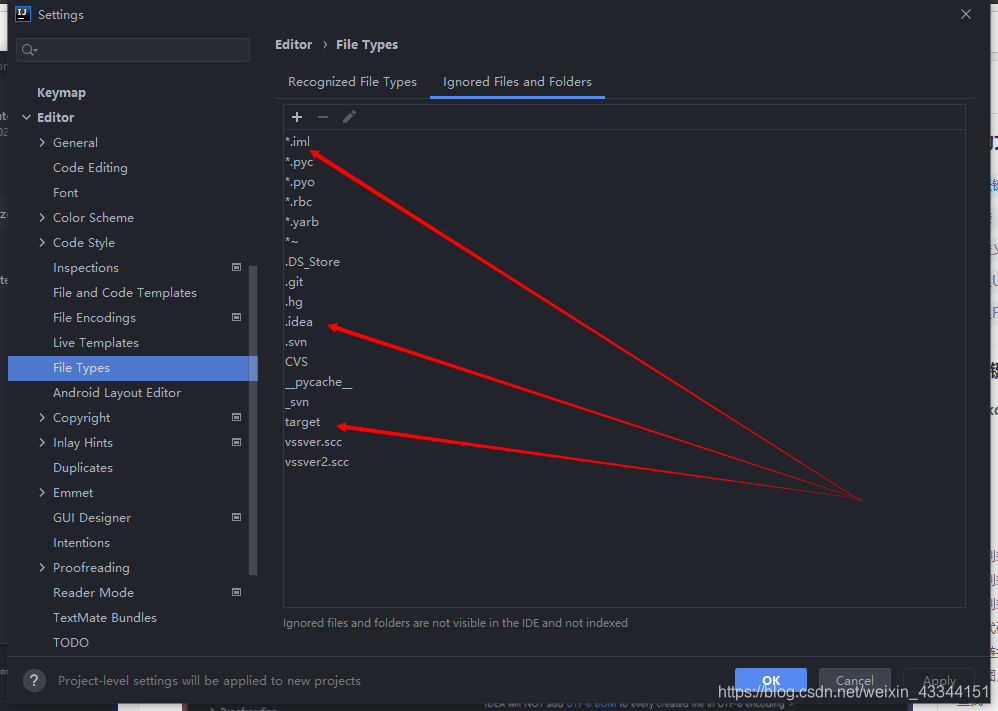

<?xml version="1.0" encoding="UTF-8"?>

<!-- localRepository
| The path to the local repository maven will use to store artifacts.
| Default: ${user.home}/.m2/repository
<localRepository>/path/to/local/repo</localRepository>
<localRepository>D:\maven_local_space</localRepository>
