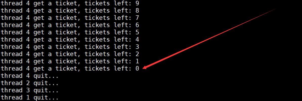

  • 效果:
image-20220401104913338
注:变量tickets被多个执行流同时访问,所以thickets就是一个临界资源,当访问临界资源时,判断tickets是否大于0、打印剩余票数以及--tickets的代码也就是临界区

Sem sem(1); //二元信号量
int tickets = 2000;
void* TicketGrabbing(void* arg)
	std::string name = (char*)arg;
	while (true){
		sem.P();
		if (tickets > 0){
			std::cout << name << " get a ticket, tickets left: " << --tickets << std::endl;
			sem.V();
            usleep(1000);
		else{
			sem.V();
			break;
	std::cout << name << " quit..." << std::endl;
	pthread_exit((void*)0);

  • 效果:
image-20220405181129830
