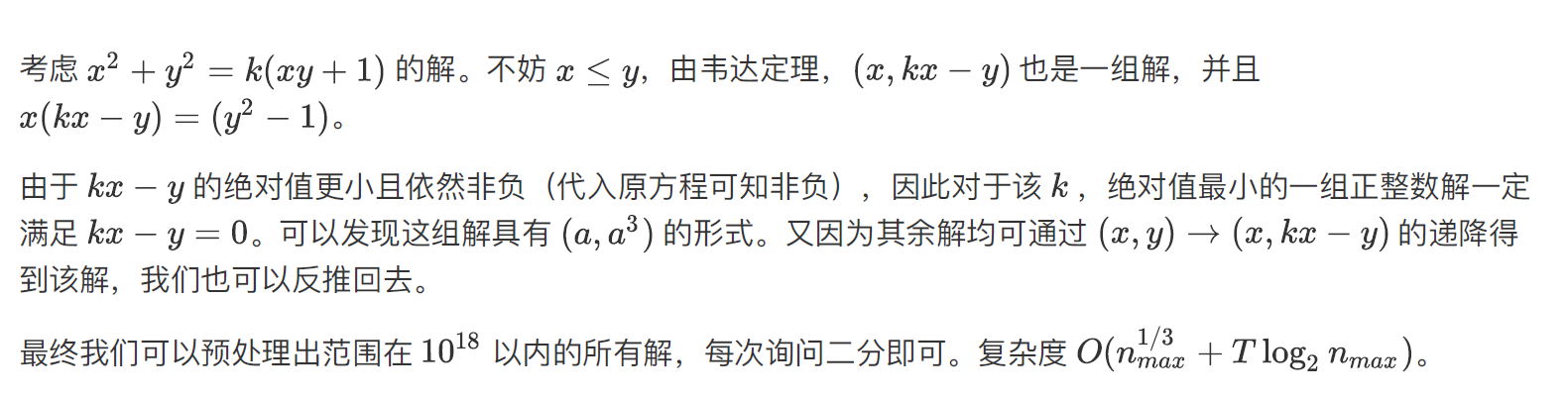

E Math
题意:
  • 给出一个n,计算有多少对正整数(x,y),使得xy+1|x^2+y^2, 1<=x,y<=n
思路:
#include<bits/stdc++.h>
using namespace std;
typedef long long LL;
const int maxn = 5e6+10;
const LL inf = 1e18;
LL a[maxn], cnt;
int main(){
	a[cnt++] = 1;
	for(LL k = 2; k*k*k<=inf; k++){
		LL x = k, y = k*k*k;
		a[cnt++] = y;
		while(y <= (inf+x)/k/k){
			x = k*k*y-x;
			swap(x,y);
			a[cnt++] = y;
	sort(a, a+cnt);
	int T;  cin>>T;
	while(T--){
		LL n;  cin>>n;
		cout<<upper_bound(a,a+cnt,n)-a<<"\n";
	return 0;
