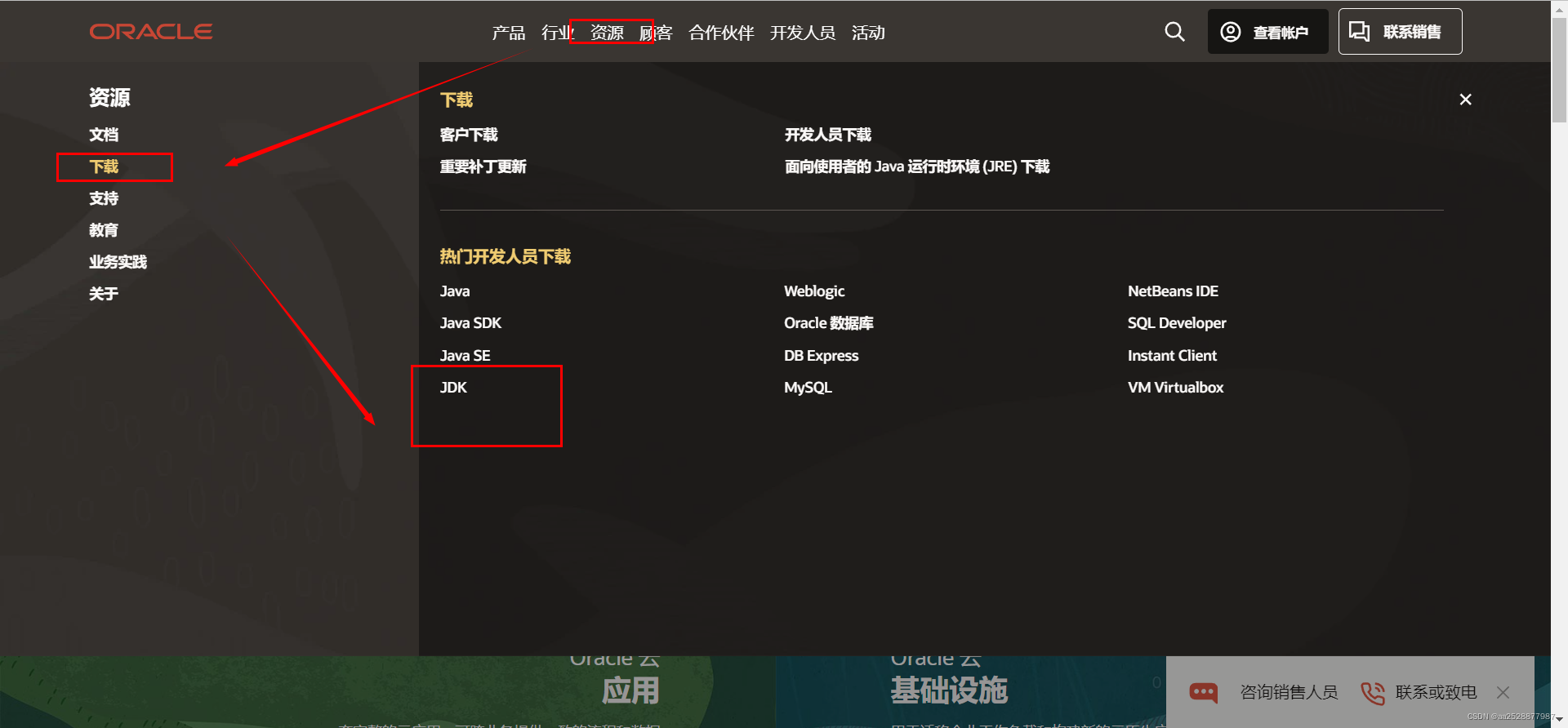

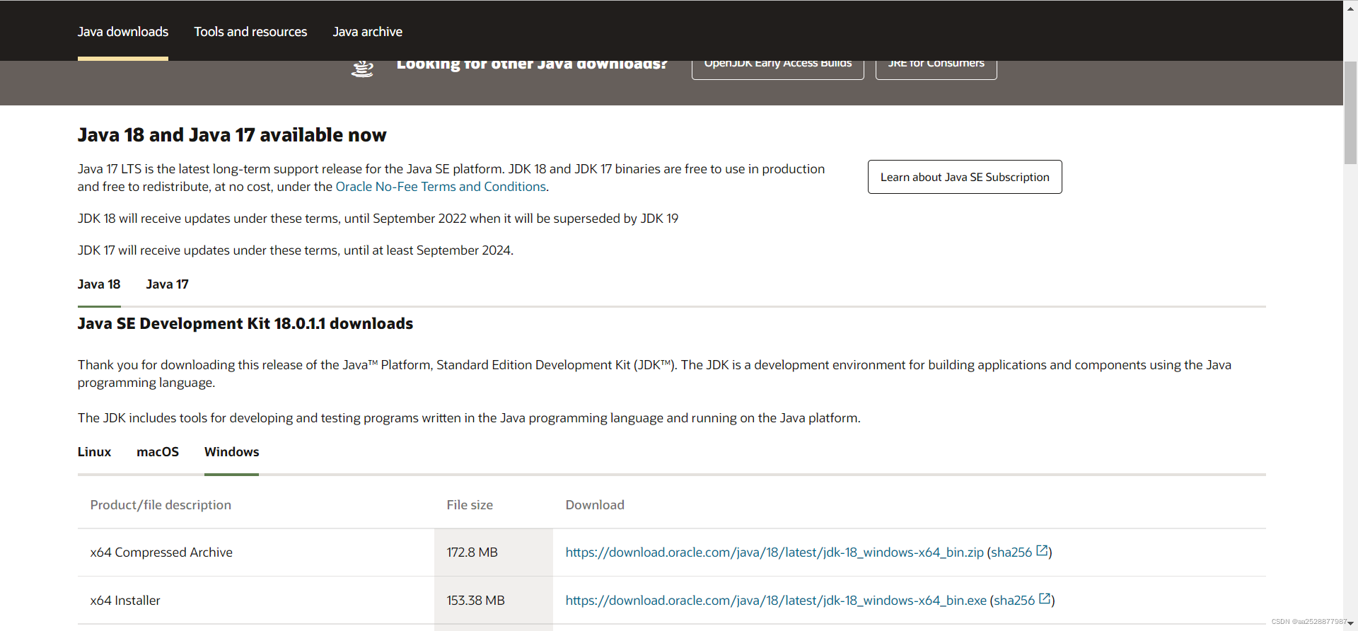

java官网:http://www.oracle.com/
依次点击:资源》下载》JDK
选择最新版本进行安装就可以了

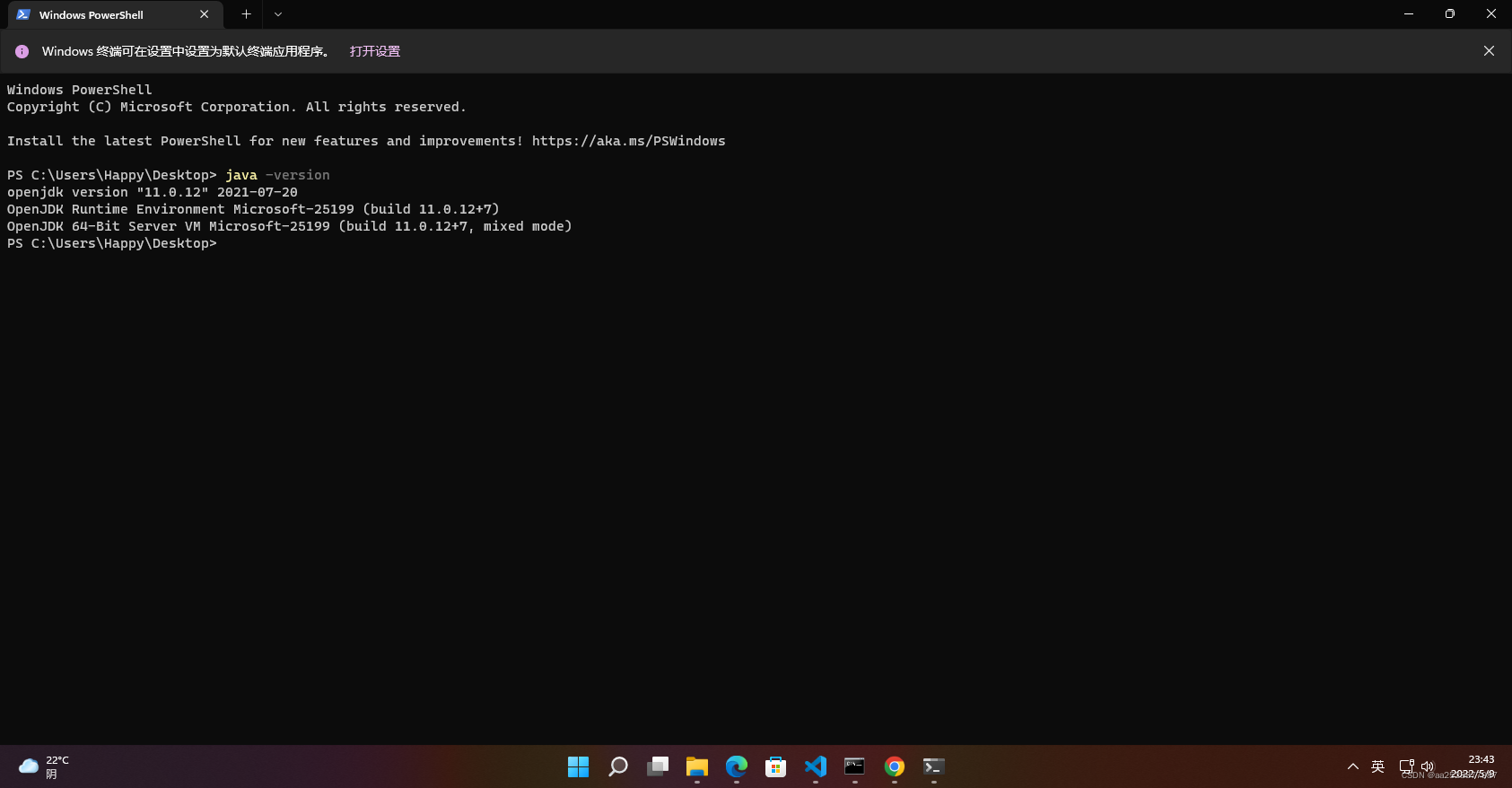

安装完记得设置变量环境。输入:java -version验证是否安装成功

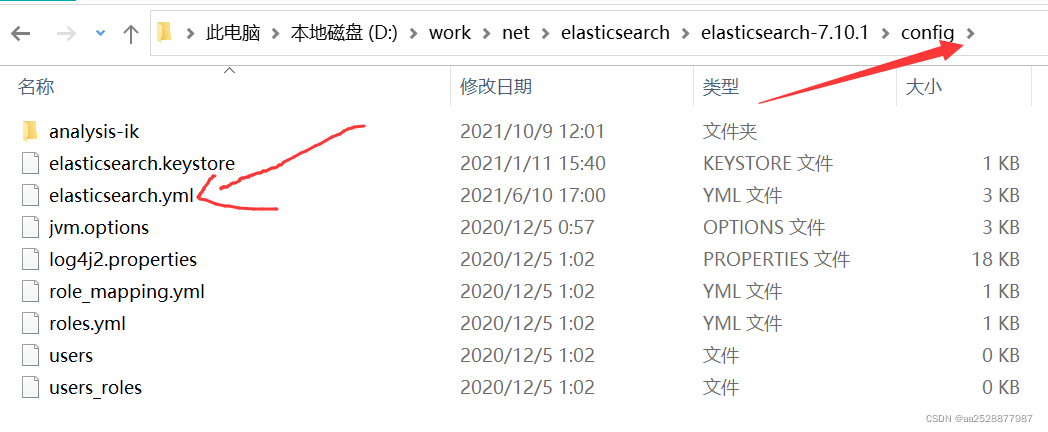

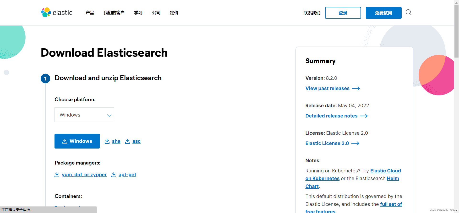

1.2 Elasticsearch准备
Elasticsearch官网:https://www.elastic.co/cn/downloads/elasticsearch
先进入到Elasticsearch中,进入到config目录中
# ======================== Elasticsearch Configuration =========================

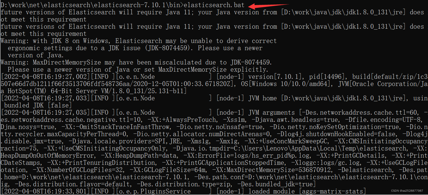

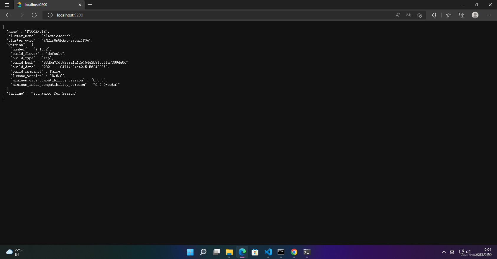

elasticsearch.bat

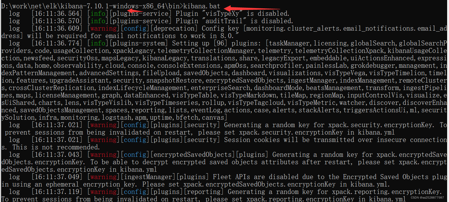

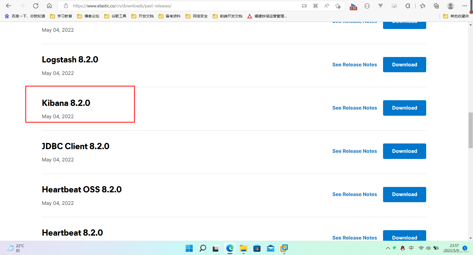

1.3 可视化工具kibana下载
地址:https://www.elastic.co/cn/downloads/past-releases/
启动kibana
登录kibana
查看kibana

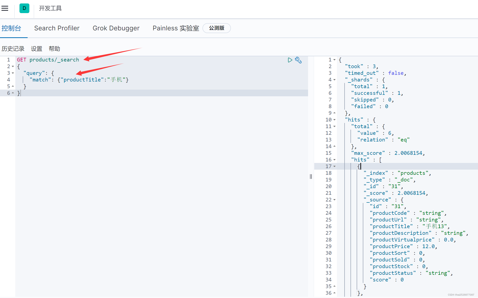

2.3 使用
/// <summary>
/// 商品控制器
/// </summary>
[ApiController]
[Route("Product")]
public class ProductController : ControllerBase
private readonly IProductService _productService;
public ProductController(IProductService productService)
_productService = productService;
/// <summary>
/// 添加商品
/// </summary>
/// <param name="product"></param>
/// <returns></returns>
[HttpPost]
public ActionResult<Product> PostProduct(Product product)
_productService.Create(product);
return CreatedAtAction("GetProduct", new { id = product.Id }, product);
