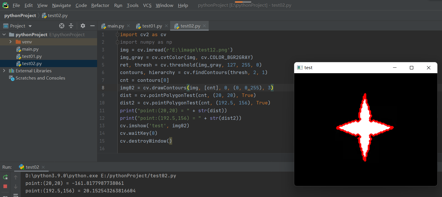

2. 点多边形测试
点多边形测试中涉及了一个新的函数:cv.pointPolygonTest(),顾名思义它是一个测试函数,第一个参数是轮廓,第二个参数就是我们的测试点了,第三个参数指的是measureDist,如果其取值为True,这个函数会找到有符号的距离,反之它只会反映出这个点是在轮廓线内部、上面还是外部(分别返回1、-1和0)
import cv2 as cv
import numpy as np
img = cv.imread(r'E:\image\test12.png')
img_gray = cv.cvtColor(img, cv.COLOR_BGR2GRAY)
ret, thresh = cv.threshold(img_gray, 127, 255, 0)
contours, hierarchy = cv.findContours(thresh, 2, 1)
cnt = contours[0]
img02 = cv.drawContours(img, [cnt], 0, (0, 0,255), 3)
dist = cv.pointPolygonTest(cnt, (20, 20), True)
dist2 = cv.pointPolygonTest(cnt, (192.5, 156), True)
print("point:(20,20) = " + str(dist))
print("point:(192.5,156) = " + str(dist2))
cv.imshow('test', img02)
cv.waitKey(0)
cv.destroyWindow()

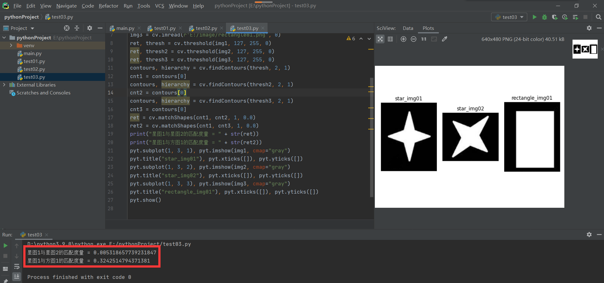

3. 形状匹配
OpenCV中的形状匹配与一个函数有关:cv.matchShapes(),这个函数使我们能够比较两个形状(或两个轮廓),并返回一个显示相似性的度量,这个值越低说明匹配越好,在实质上它是根据矩值计算出来的
值得注意的是,即使是图像旋转也不会对结果产生很大的影响
import cv2 as cv
import numpy as np
from matplotlib import pyplot as pyt
img1 = cv.imread(r'E:/image/star01.png', 0)
img2 = cv.imread(r'E:/image/star02.png', 0)
img3 = cv.imread(r'E:/image/rectangle01.png', 0)
ret, thresh = cv.threshold(img1, 127, 255, 0)
ret, thresh2 = cv.threshold(img2, 127, 255, 0)
ret, thresh3 = cv.threshold(img3, 127, 255, 0)
cnt1 = contours[0]
contours, hierarchy = cv.findContours(thresh2, 2, 1)
cnt2 = contours[0]
contours, hierarchy = cv.findContours(thresh3, 2, 1)
cnt3 = contours[0]
ret = cv.matchShapes(cnt1, cnt2, 1, 0.0)
ret2 = cv.matchShapes(cnt1, cnt3, 1, 0.0)
print("星图1与星图2的匹配度量 = " + str(ret))
print("星图1与方图1的匹配度量 = " + str(ret2))
pyt.subplot(1, 3, 1), pyt.imshow(img1, cmap="gray")
pyt.title("star_img01"), pyt.xticks([]), pyt.yticks([])
pyt.subplot(1, 3, 2), pyt.imshow(img2, cmap="gray")
pyt.title("star_img02"), pyt.xticks([]), pyt.yticks([])
pyt.subplot(1, 3, 3), pyt.imshow(img3, cmap="gray")
pyt.title("rectangle_img01"), pyt.xticks([]), pyt.yticks([])
pyt.show()
