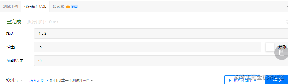

2、代码实现
代码参考:
class Solution {
    public int sumNumbers(TreeNode root) {
        return dfs(root, 0);
    public int dfs(TreeNode root, int prevSum) {
        if (root == null) {
            return 0;
        int sum = prevSum * 10 + root.val;
        if (root.left == null && root.right == null) {
            return sum;
        } else {
            return dfs(root.left, sum) + dfs(root.right, sum);
