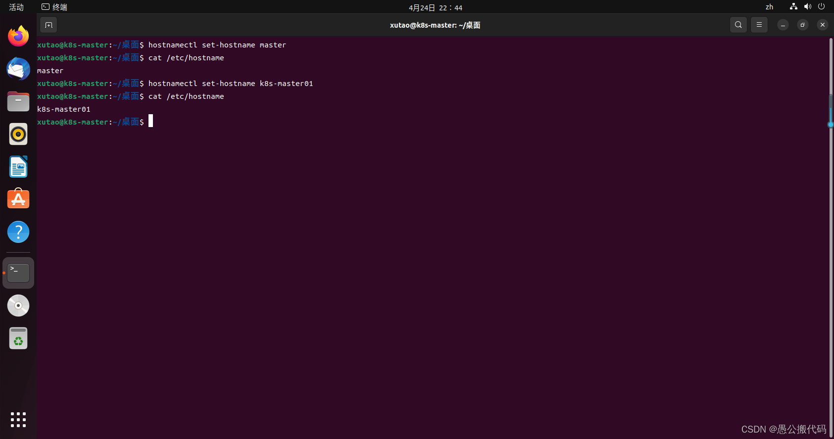

二、修改主机名
hostnamectl set-hostname k8s-master01

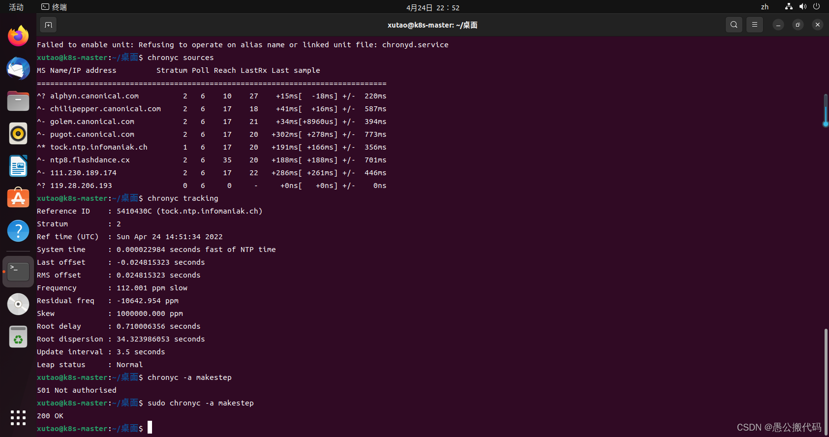

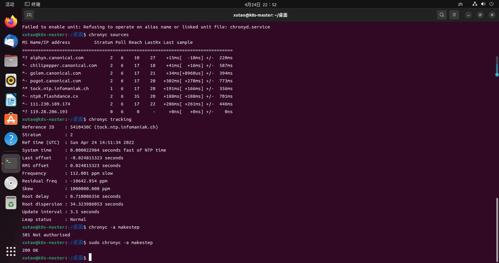

四、时钟同步
systemctl start chronyd;systemctl enable chronyd
chronyc sources #看连接状态
chronyc tracking #看同步状态,时间差
chronyc -a makestep #立即同步时间

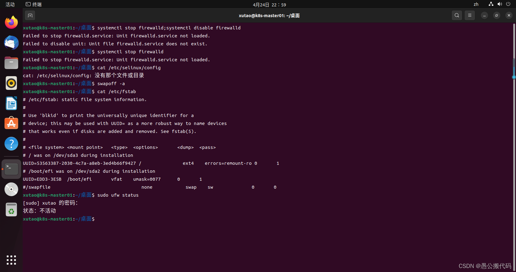

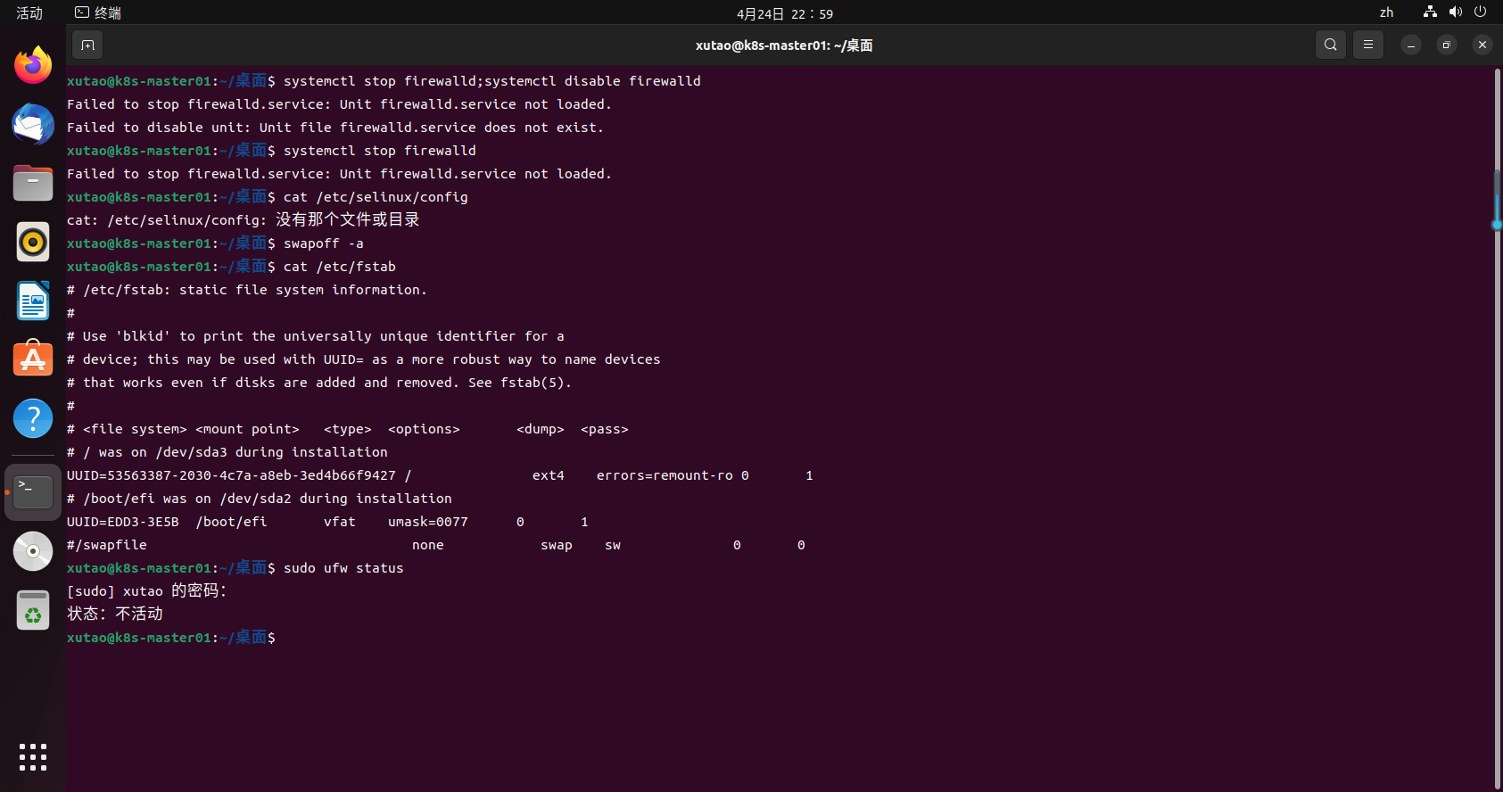

五、关闭相应服务
1.关闭防火墙
ubuntu是自动关闭防火墙的,查看命令如下:
sudo ufw status

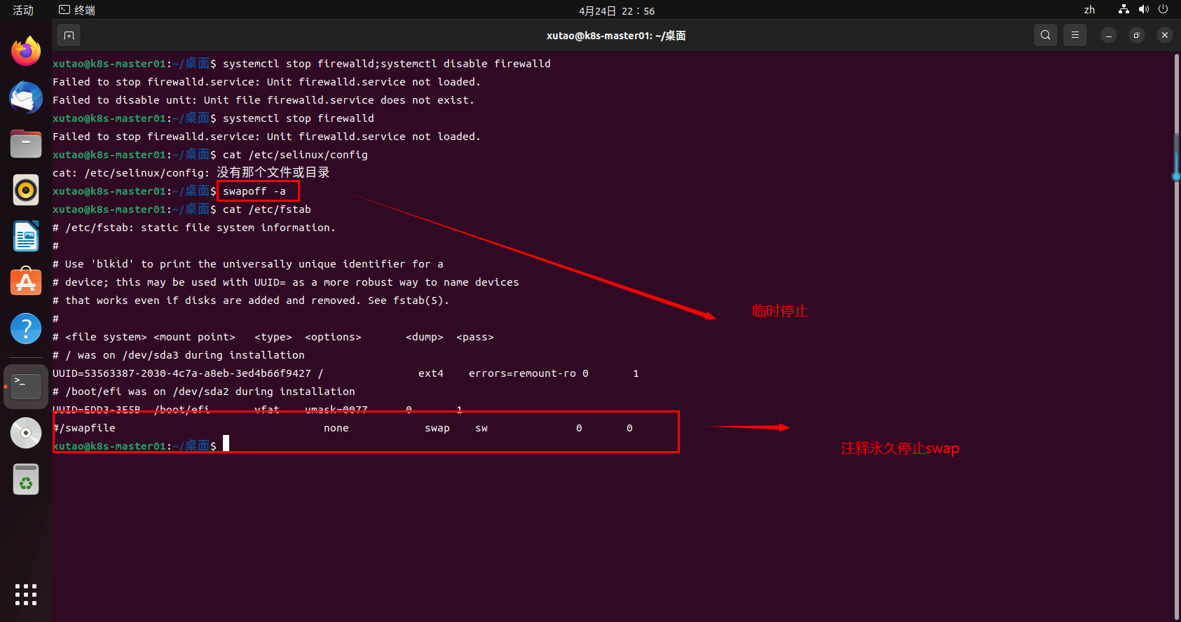

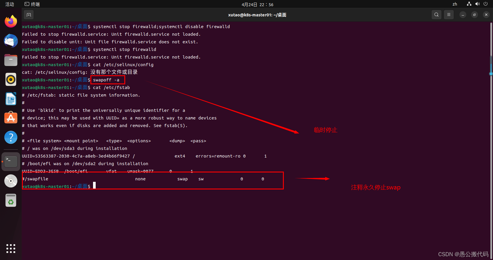

2.关闭swap
sudo swapoff -a
sudo gedit /etc/fstab

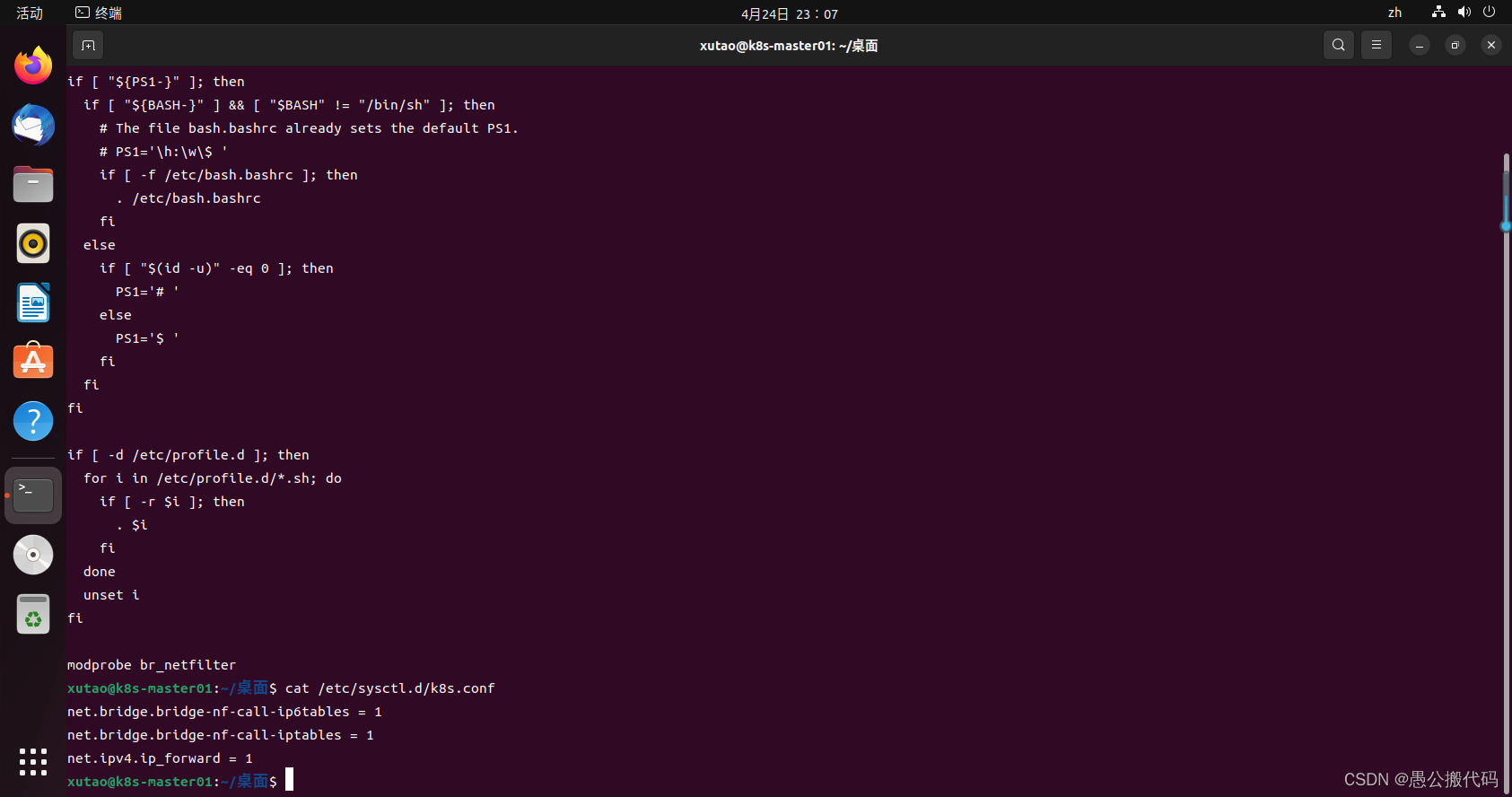

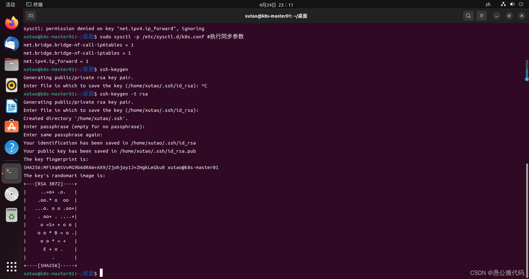

3.配置NAT转发
modprobe br_netfilter
cat /etc/profile
cat /etc/sysctl.d/k8s.conf
net.bridge.bridge-nf-call-ip6tables = 1
net.bridge.bridge-nf-call-iptables = 1
net.ipv4.ip_forward = 1
sudo sysctl -p /etc/sysctl.d/k8s.conf #执行同步参数

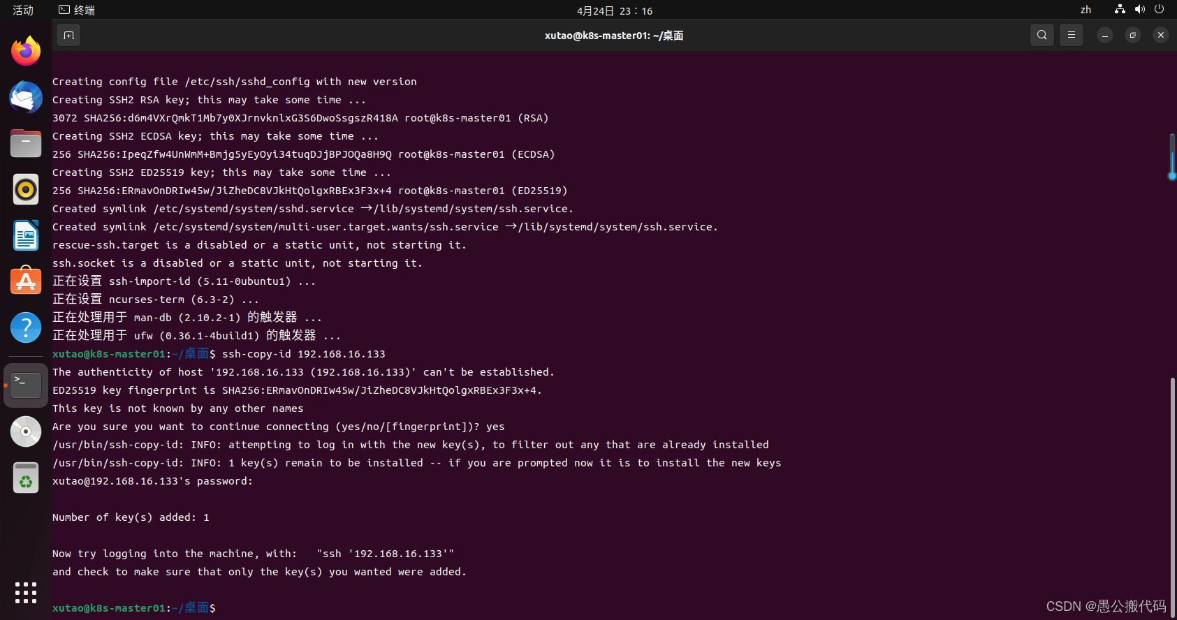

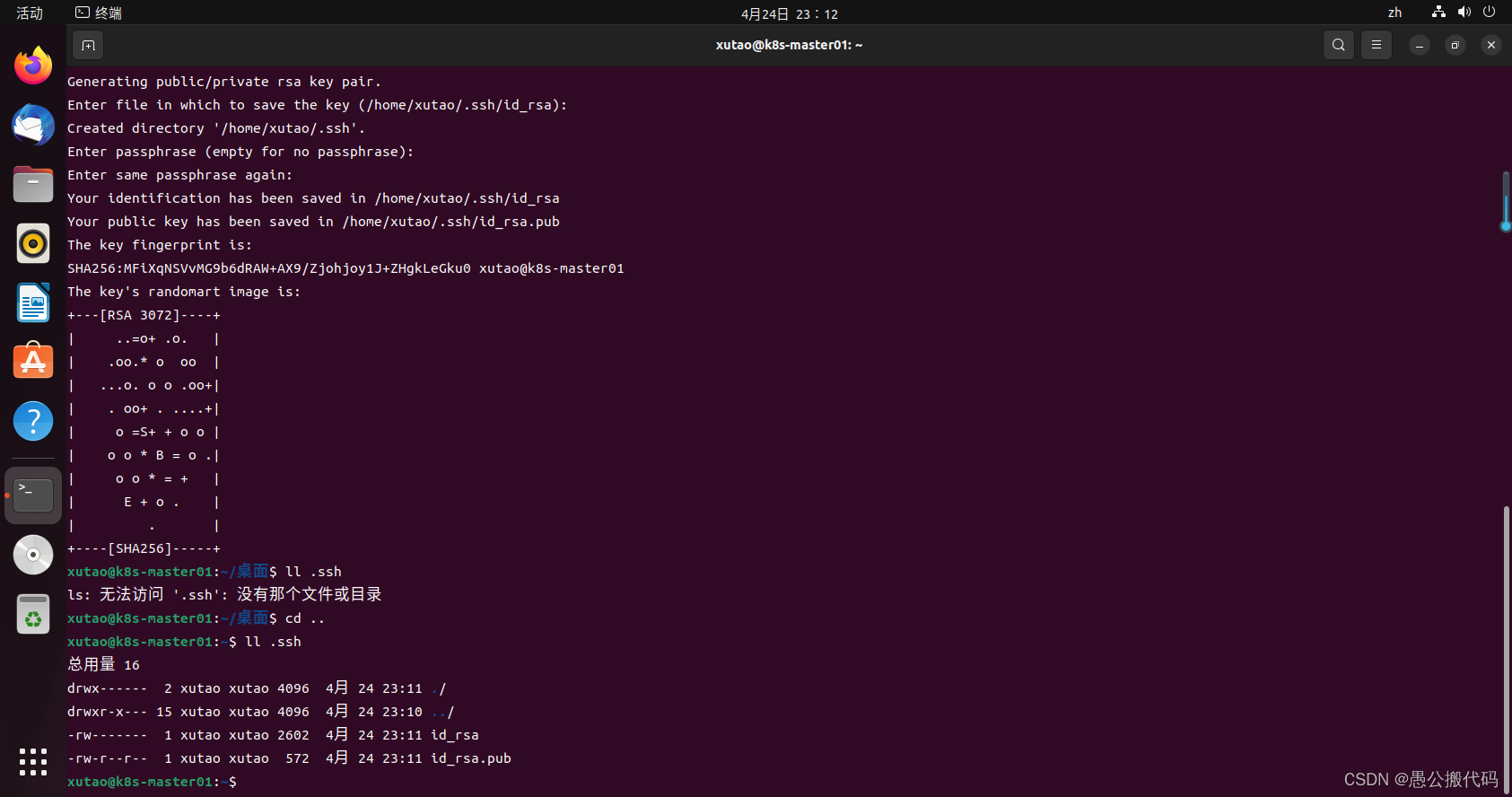

4.SSH密钥免密
sudo apt-get install openssh-server
ssh-keygen -t rsa
此时会在/home/ubuntu/.ssh目录下生成密钥对
ll .ssh
上传公钥到对应服务器
ssh-copy-id 192.168.16.133
ssh-copy-id 192.168.16.134

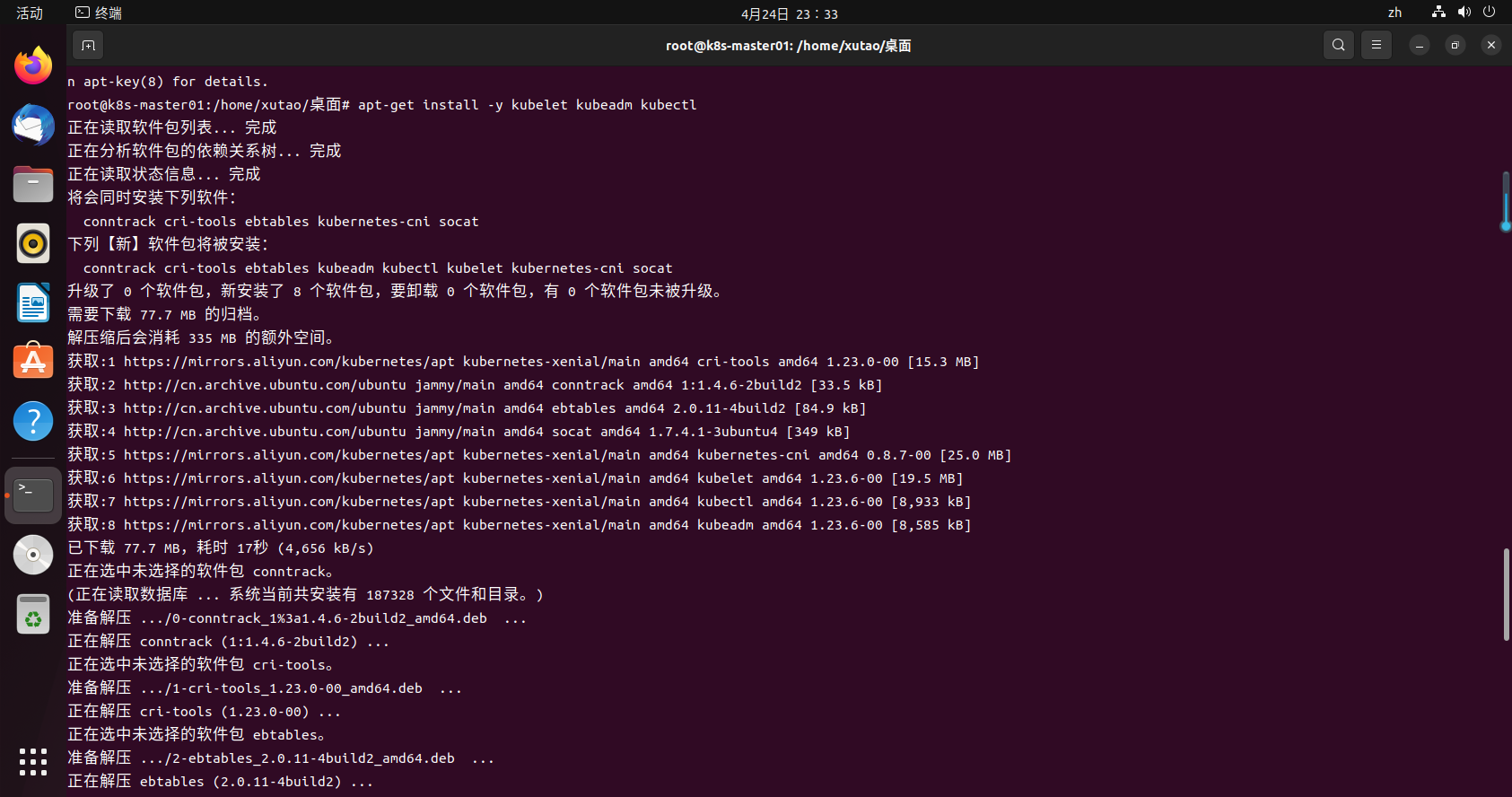

# 下载 kubectl,kubeadm以及 kubelet
apt-get install -y kubelet kubeadm kubectl

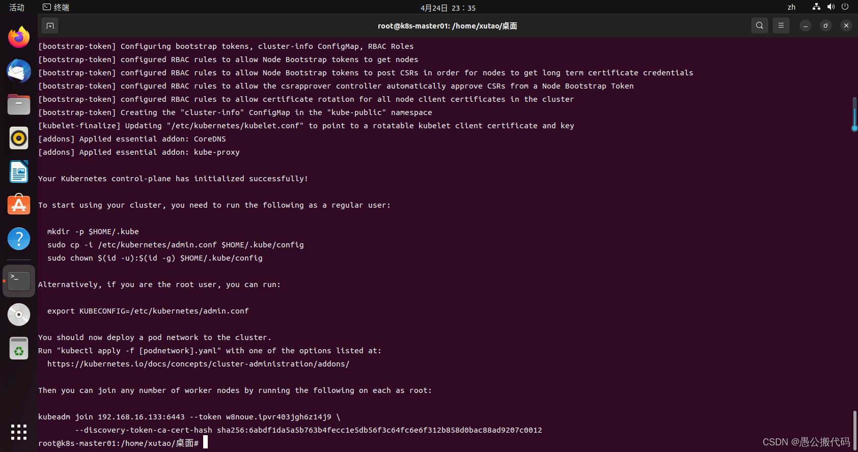

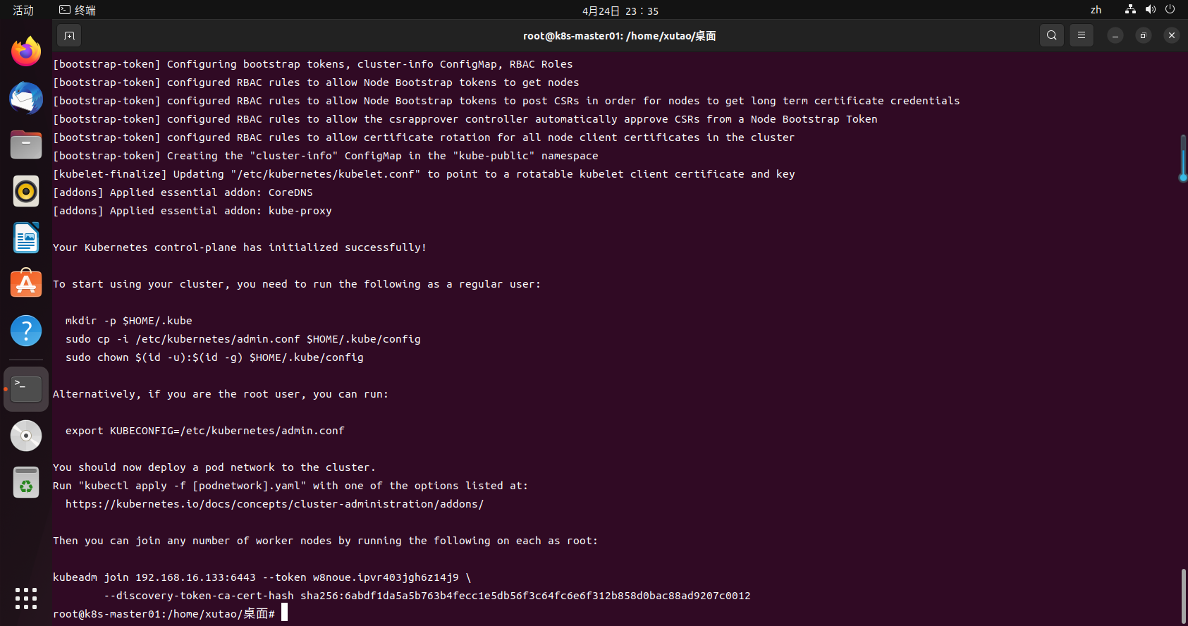

七、初始化 master 节点
kubeadm init \
--apiserver-advertise-address=192.168.16.133 \
--image-repository registry.aliyuncs.com/google_containers \
--pod-network-cidr=10.244.0.0/16

1.集群使用的kubeconfig
在k8s-master01上执行
mkdir -p $HOME/.kube
sudo cp -i /etc/kubernetes/admin.conf $HOME/.kube/config
sudo chown $(id -u):$(id -g) $HOME/.kube/config

kubeadm join k8s-api.ilinux.io:6443 --token 5ppzww.4lv5mi6q59gu46mo --discovery-token-ca-cert-hash sha256:b5054b0ddbbc0f048f569fc732ce23ae021cf21bb1cee38c7a2dddd5a0f73a43 --control-plane
4.集群加入node节点
