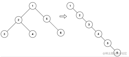

示例 1:
输入: root = [1,2,5,3,4,null,6]
输出: [1,null,2,null,3,null,4,null,5,null,6]

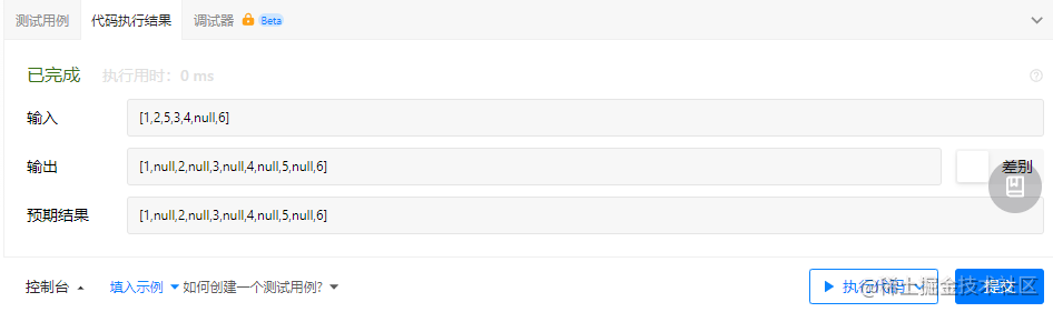

2、代码实现
代码参考:
class Solution {
    public void flatten(TreeNode root) {
        List<TreeNode> list = new ArrayList<TreeNode>();
        preorderTraversal(root, list);
        int size = list.size();
        for (int i = 1; i < size; i++) {
            TreeNode prev = list.get(i - 1), curr = list.get(i);
            prev.left = null;
            prev.right = curr;
    public void preorderTraversal(TreeNode root, List<TreeNode> list) {
        if (root != null) {
            list.add(root);
            preorderTraversal(root.left, list);
            preorderTraversal(root.right, list);
