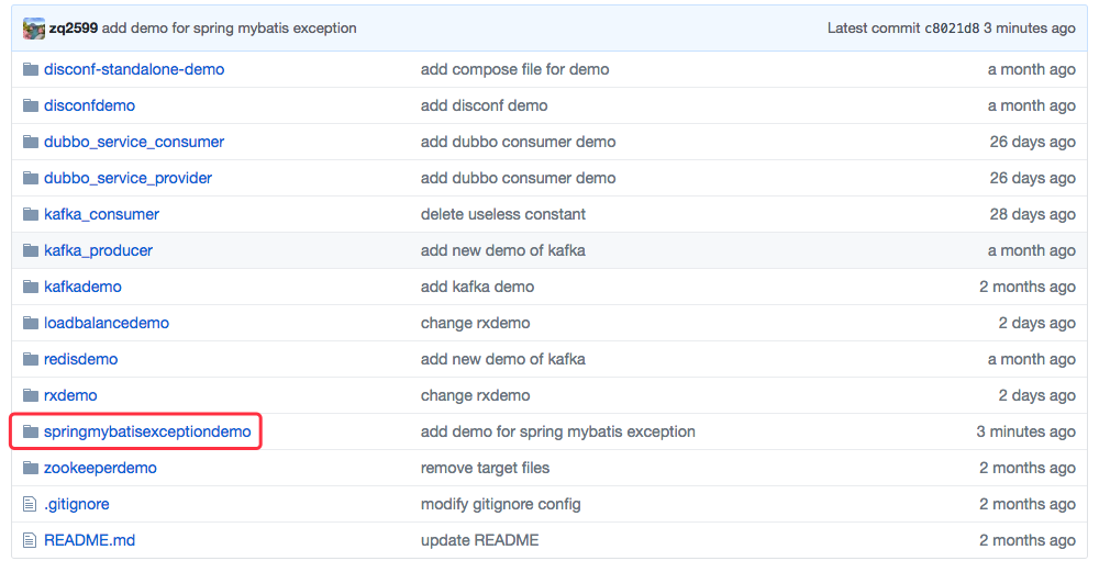

- 继续打开上一章的工程,源码在Git上,地址:git@github.com:zq2599/blog_demos.git,下载后可以发现里面有很多工程,本次实战用的工程是springmybatisexceptiondemo,如下图红框所示:

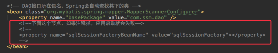

- 再打开spring-mybatis.xml文件,确保org.mybatis.spring.mapper.MapperScannerConfigurer的配置中,没有配置sqlSessionFactoryBeanName,如下图,sqlSessionFactoryBeanName配置是注释掉的:

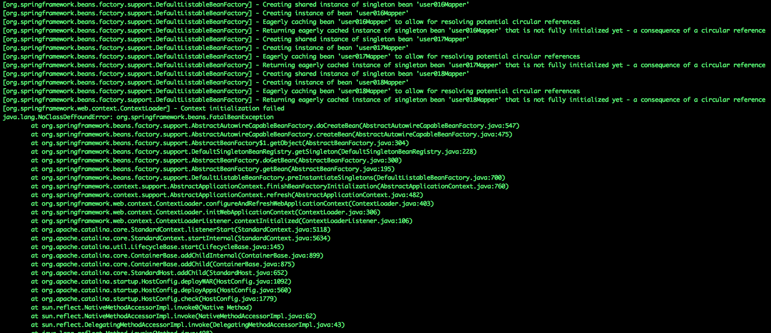

- ok,打包,部署吧,可以看到如下错误信息:
java.lang.NoClassDefFoundError: Could not initialize class org.springframework.beans.factory.BeanCreationException
at org.springframework.beans.factory.support.AbstractAutowireCapableBeanFactory.doCreateBean(AbstractAutowireCapableBeanFactory.java:547)
at org.springframework.beans.factory.support.AbstractAutowireCapableBeanFactory.createBean(AbstractAutowireCapableBeanFactory.java:475)
at org.springframework.beans.factory.support.AbstractBeanFactory$1.getObject(AbstractBeanFactory.java:304)
at org.springframework.beans.factory.support.DefaultSingletonBeanRegistry.getSingleton(DefaultSingletonBeanRegistry.java:228)
at org.springframework.beans.factory.support.AbstractBeanFactory.doGetBean(AbstractBeanFactory.java:300)
at org.springframework.beans.factory.support.AbstractBeanFactory.getBean(AbstractBeanFactory.java:195)
at org.springframework.beans.factory.support.DefaultListableBeanFactory.preInstantiateSingletons(DefaultListableBeanFactory.java:700)
at org.springframework.context.support.AbstractApplicationContext.finishBeanFactoryInitialization(AbstractApplicationContext.java:760)
at org.springframework.context.support.AbstractApplicationContext.refresh(AbstractApplicationContext.java:482)
at org.springframework.web.context.ContextLoader.configureAndRefreshWebApplicationContext(ContextLoader.java:403)
at org.springframework.web.context.ContextLoader.initWebApplicationContext(ContextLoader.java:306)
at org.springframework.web.context.ContextLoaderListener.contextInitialized(ContextLoaderListener.java:106)

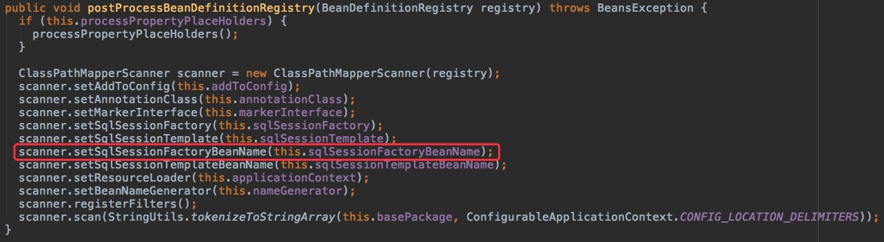

打开MapperScannerConfigurer.java,在postProcessBeanDefinitionRegistry方法中看到sqlSessionFactoryBeanName属性被设置给ClassPathMapperScanner对象了,如下图:
看ClassPathMapperScanner的doScan方法,这个方法是对basePackages路径下所有接口的动态代理对象设置属性,如果ClassPathMapperScanner对象中sqlSessionFactoryBeanName为空,就设置这些动态代理对象的autowire属性为AUTOWIRE_BY_TYPE,如下图:

- 这个对象如果可以从MapperScannerConfigurer的sqlSessionFactoryBeanName属性直接指定,这项目就能启动成功;
- 如果没有在xml中为MapperScannerConfigurer指定sqlSessionFactoryBeanName属性,就会走另一个逻辑,在生成动态代理对象时,由spring环境寻找合适类型的bean去注入,此时项目会启动失败;

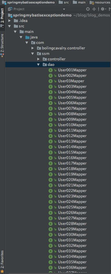

- 大家看一下demo源码com.ssm.dao包下面,有很多个Mapper接口,这里的每一个接口,在spring启动的时候mybatis环境都会生成一个动态代理对象,当接口只有少量的时候,即便没有配置MapperScannerConfigurer属性,工程也能启动成功,数量逐渐增加到一定程度(具体数量和接口的复杂程度以及栈大小有关),就会启动失败,如下图:

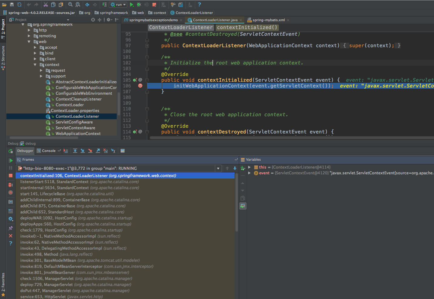

根据前面的堆栈日志,我们在ContextLoaderListener.java的106行打下断点,启动tomcat之后线程就会在此暂停,如下图:

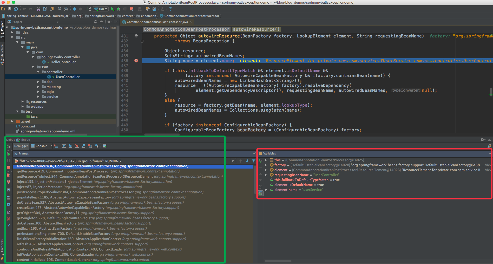

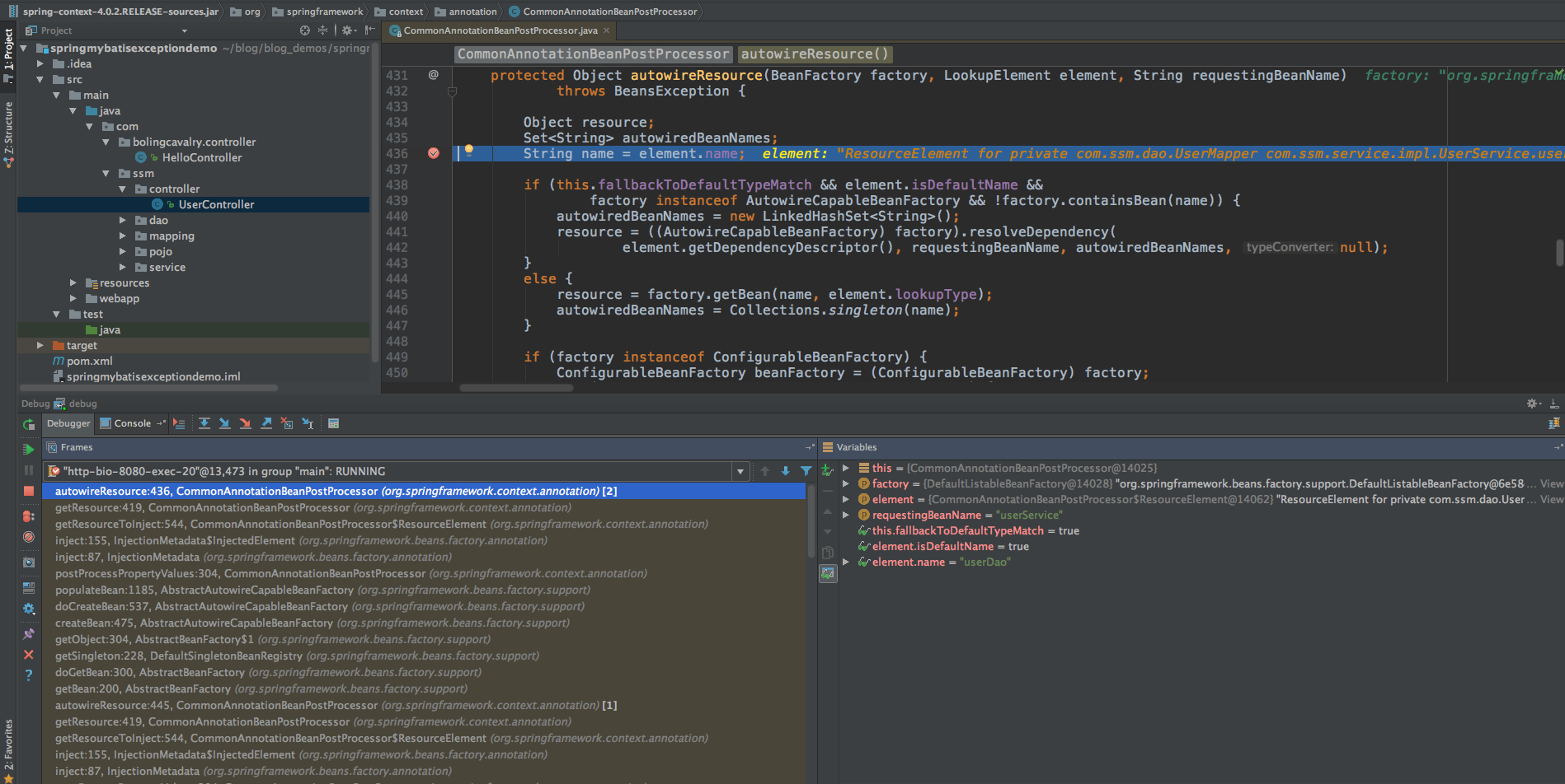

信息很丰富,从左下角绿框中的堆栈可以看出一个bean的初始化调用层次:
在实例化userController的时候要处理它的userService属性,所以走到了CommonAnnotationBeanPostProcessor.autowireResource方法内,通过factory.getBean来获取userService对象,并且传入了name和type。
由于userService还没有创建,因此此处立即开始创建userService实例,很快,又执行到了CommonAnnotationBeanPostProcessor.autowireResource方法内,如下图:

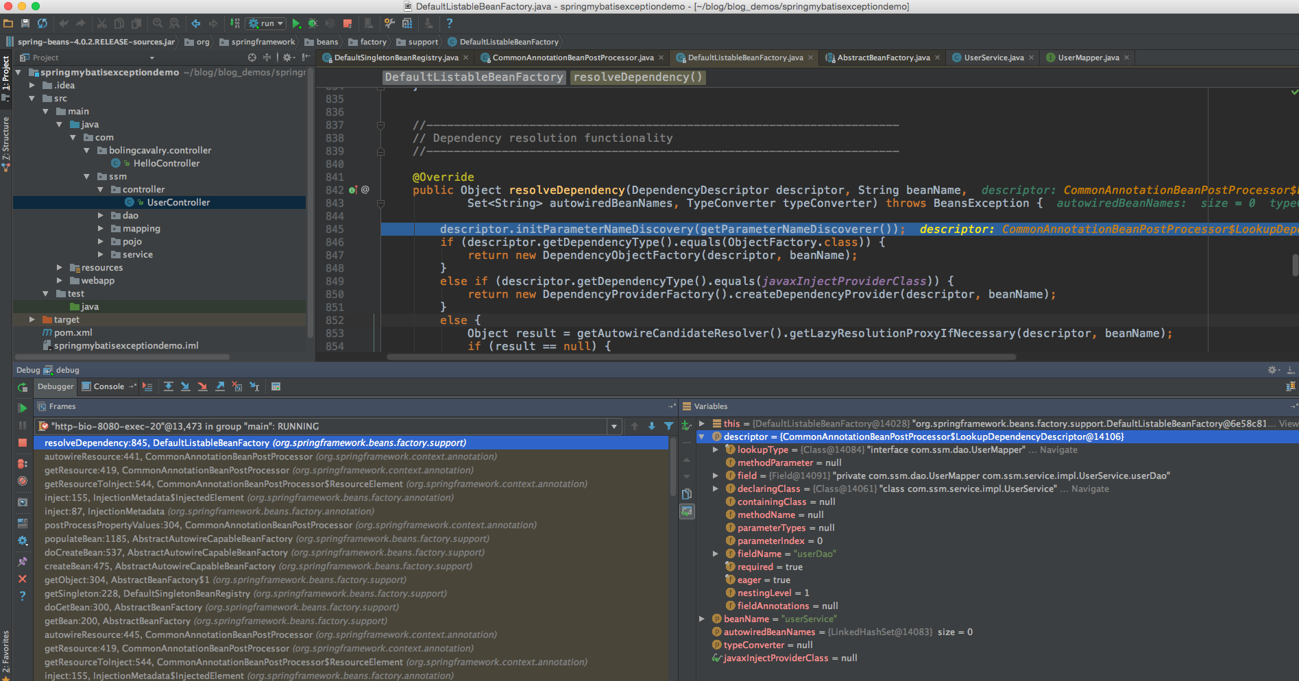

创建userService的时候,需要注入userDao属性,于是又会触发userDao实例的创建,但是,这次不是通过factory.getBean来创建了,而是DefaultListableBeanFactory.resolveDependency。
为什么userService对象是通过factory.getBean创建,而userDao却是通过DefaultListableBeanFactory.resolveDependency来创建的呢?
我们去看下工程中UserService.java,如下图红框所示,UserService已经通过注解声明为service组件了,所以在CommonAnnotationBeanPostProcessor.autowireResource方法中,factory.containsBean(“userService”)会返回true,而userDao呢?整个工程中没有一个类通过@Service标签声明为userDao组件,所以只能通过DefaultListableBeanFactory.resolveDependency去找了,传入了一堆信息給resolveDependency方法,如下图:

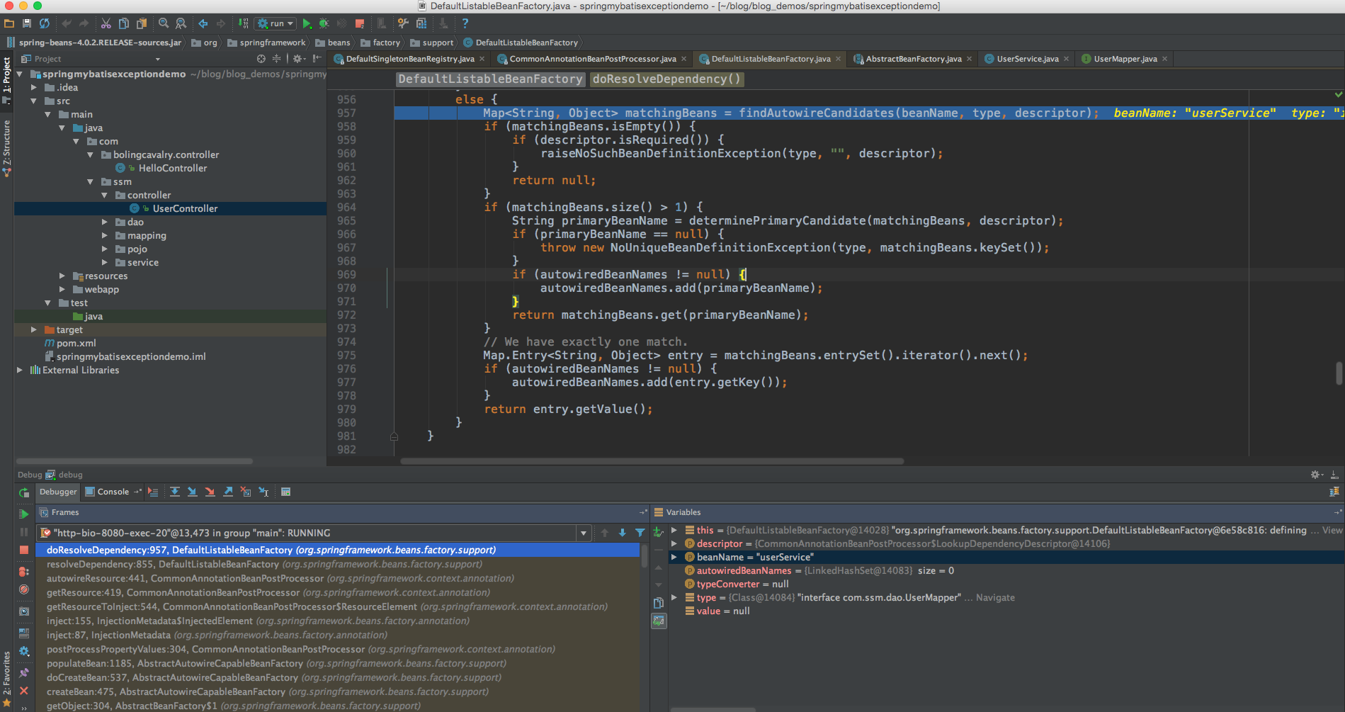

resolveDependency方法会调用doResolveDependency方法,对于要注入的属性,例如userService对象的userDao属性,由于要根据属性类型来注入,所以要先找出一些候选人,在这些候选人中筛选出匹配的bean来完成注入,此逻辑对应的代码如下图:
在findAutowireCandidates中有几步比较重要:
- 要根据所需的对象类型查找beanName,在doGetBeanNamesForType方法中,通过getBeanDefinitionNames拿到了所有的bean的名称;
- 拿到这些名称后,对每个名称都调用isTypeMatch方法,传入名称和属性的类型;
- isTypeMatch方法的目的是根据bean名称找到bean实例,再看这个实例的类型和传入的类型是否一致;

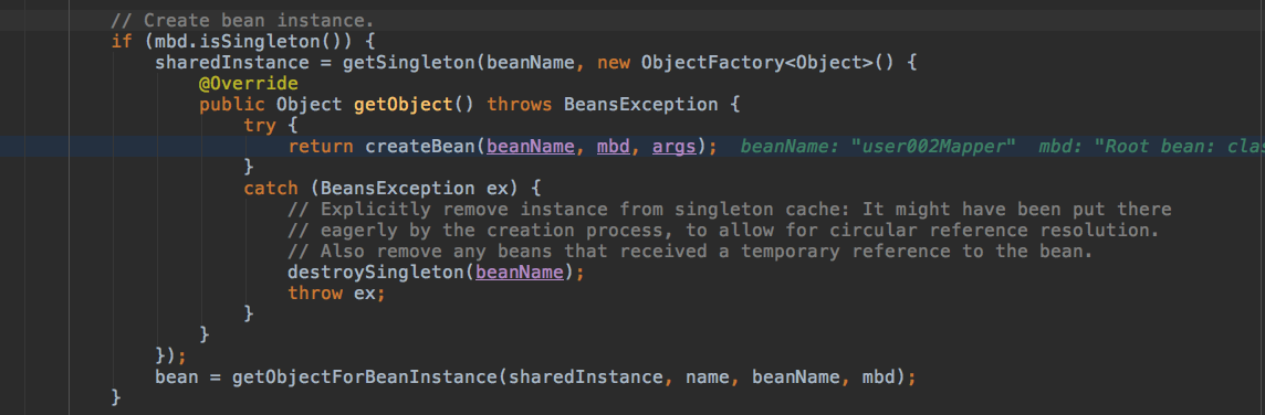

- isTypeMatch方法中需要根据bean名称找到bean实例,因此,对于没有实例化过的bean名称,就会触发bean的实例化,最终走到了AbstractBeanFactory.doGetBean方法,这里面自定义了一个ObjFactory,里面执行了createBean方法,如下图:
- 现在,我们在上图中的createBean方法处打断点,然后将代码执行下去,可以发现以下循环的逻辑:
- createBean的时候,由于要处理这个bean的依赖属性(例如user002Mapper的SqlSessionFactory属性),于是会调用DefaultListableBeanFactory.doResolveDependency方法;
- doResolveDependency方法中,要执行findAutowireCandidates方法获取所有的候选人,然后找出符合要求的bean赋給依赖属性(例如user002Mapper的SqlSessionFactory属性);
- findAutowireCandidates中的步骤我们刚才已经分析过了,对于没有实例化过的bean名称,就会触发bean的实例化,最终又走到了AbstractBeanFactory.doGetBean方法;
- 又回到了步骤一,只不过这次createBean创建的是另一个bean了;

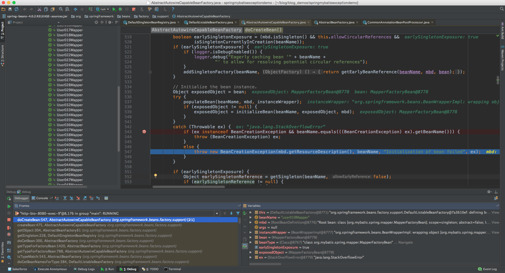

- 在createBean处的断点不停的继续执行,最终在创建userXXXMapper的时候发生了StackOverflowError,我的本地电脑是user019Mapper;

- 在AbstractAutowireCapableBeanFactory.doCreateBean方法中,对创建bean时抛出的异常做了try…catch处理,捕获到StackOverflowError之后,抛出的是beanName参数为user019Mapper的BeanCreationException,如下图:
- 按照方法堆栈层次的关系,创建user019Mapper时抛出BeanCreationException异常后,回到了创建user018Mapper的doCreateBean方法中,此时捕获的异常又被包装成beanName参数为user018Mapper的BeanCreationException;
- 按照上述的捕获抛出逻辑一层一层返回堆栈,最终抛出的异常是beanName参数为userController的BeanCreationException;
- 至此真相大白,在spring依赖注入的时候,AUTOWIRE_BY_TYPE类型的注入,总是要挨个获取所有bean的类型,从中选出类型合适的bean来注入,获取这些bean的过程中,如果还没有实例化就立即做实例化,做的时候又要对这些bean自身的属性进行注入,于是就出现了AbstractAutowireCapableBeanFactory.createBean方法的一层一层嵌套式调用,bean越多嵌套越深,导致栈内存被耗光

以上就是定位和分析异常的过程,看懂了整个过程,再回头来看看spring启动时抛出的异常,如下图,很多关键信息都被没有输出,如果不打断点,仅凭输出信息来定位问题是很难定位到问题所在的,下一篇,三部曲之三,我们去修改和编译spring的源码,让spring环境在抛出异常时带上更详细的错误信息。
