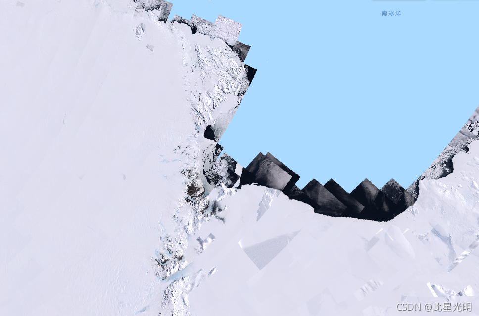

代码:
  1. var dataset = ee.ImageCollection('USGS/LIMA/SR');
  2. var antarctica = dataset.select(['B3', 'B2', 'B1']);
  3. var antarcticaVis = {
  4. min: 0.0,
  5. max: 10000.0,
  6. };
  7. Map.setCenter(164.619, -77.99, 7);
  8. Map.addLayer(antarctica, antarcticaVis, 'Antartica Imagery (RGB)');
